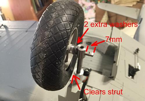

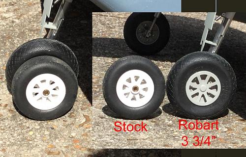

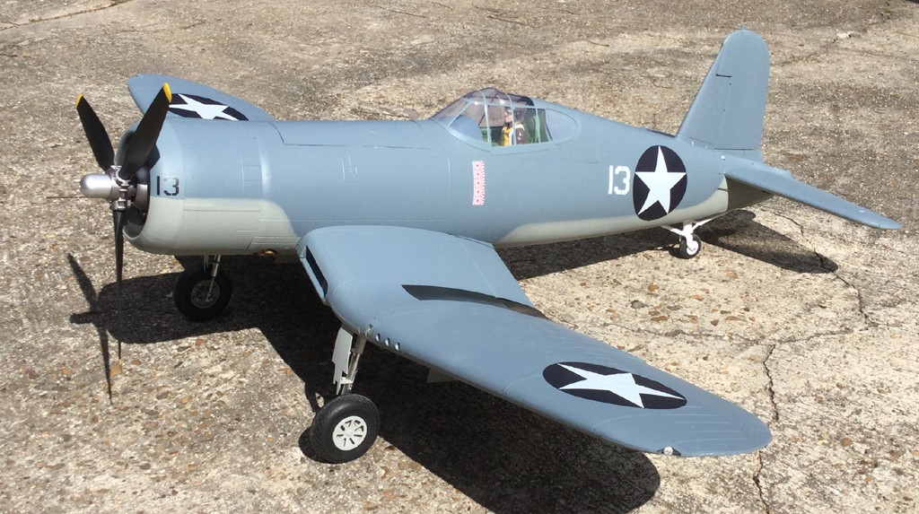

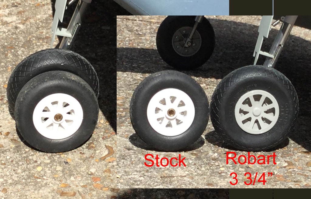

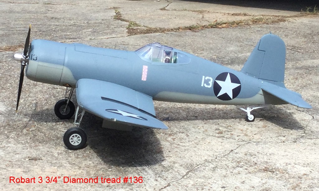

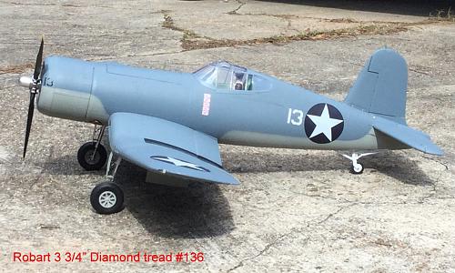

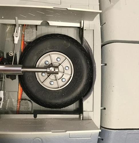

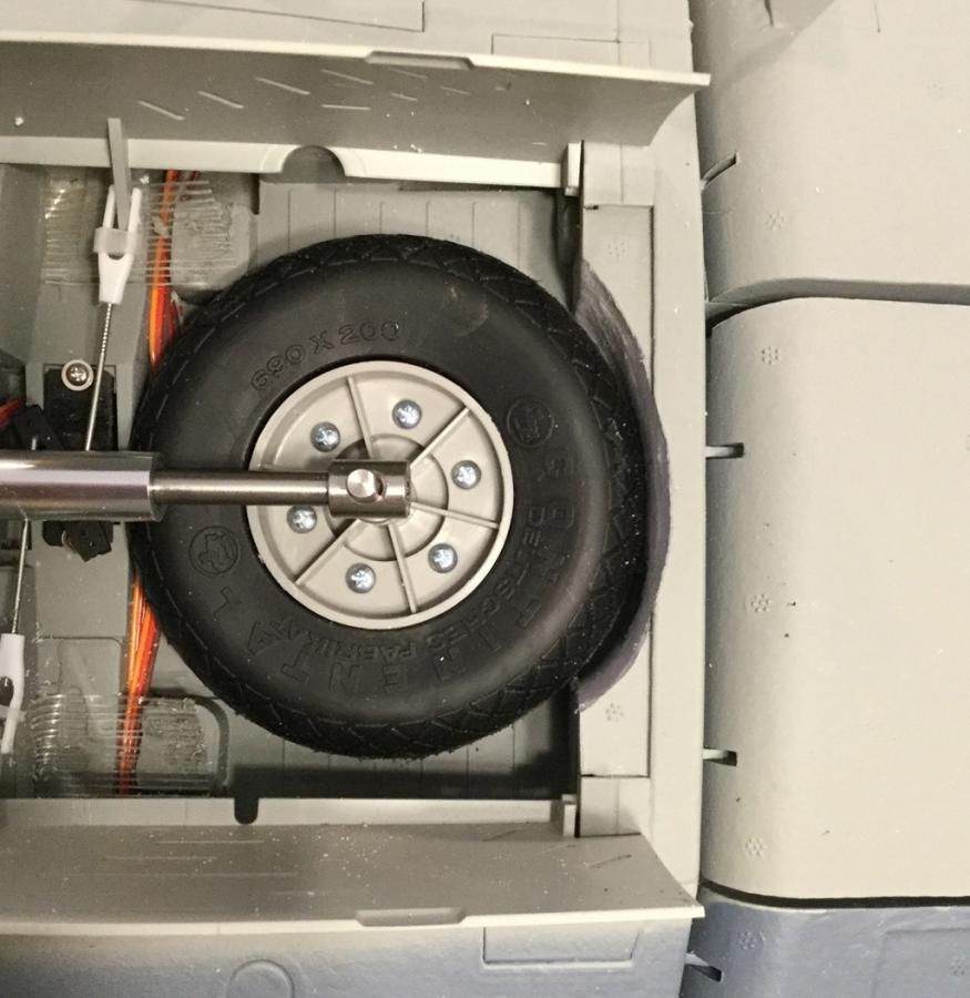

                              Decided to see how big a wheel I could fit in the Corsair. As TiredIron pointed out earlier the Robart 3 1/2" (#135) fits without too much work.
                              Anyway, here's what I had to do to get the 3 3/4" to fit.

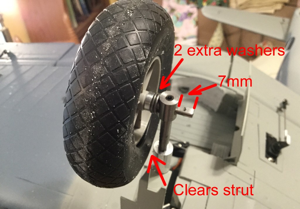

                              First thing was to get the existing axle shafts to the Robart 3 3/4 Diamond tread wheels (#136).
                              I used a #4 drill (.209in.) to open the supplied wheel bushings and it provided a fairly snug fit to the axle. I tried a 5mm drill but it was too tight and a 5.5mm drill was too loose.
                              Next thing was making sure the wheel cleared the strut. This required a couple of extra washers added to the existing thick aluminum washer. This left 7mm of extra axle protruding through the strut which is easily trimmed and a new flat ground for the set screw.
                              Click image for larger version  Name:	F4U_1600WheelMod_01.jpg Views:	1 Size:	151.2 KB ID:	175027

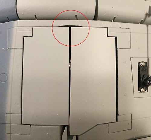

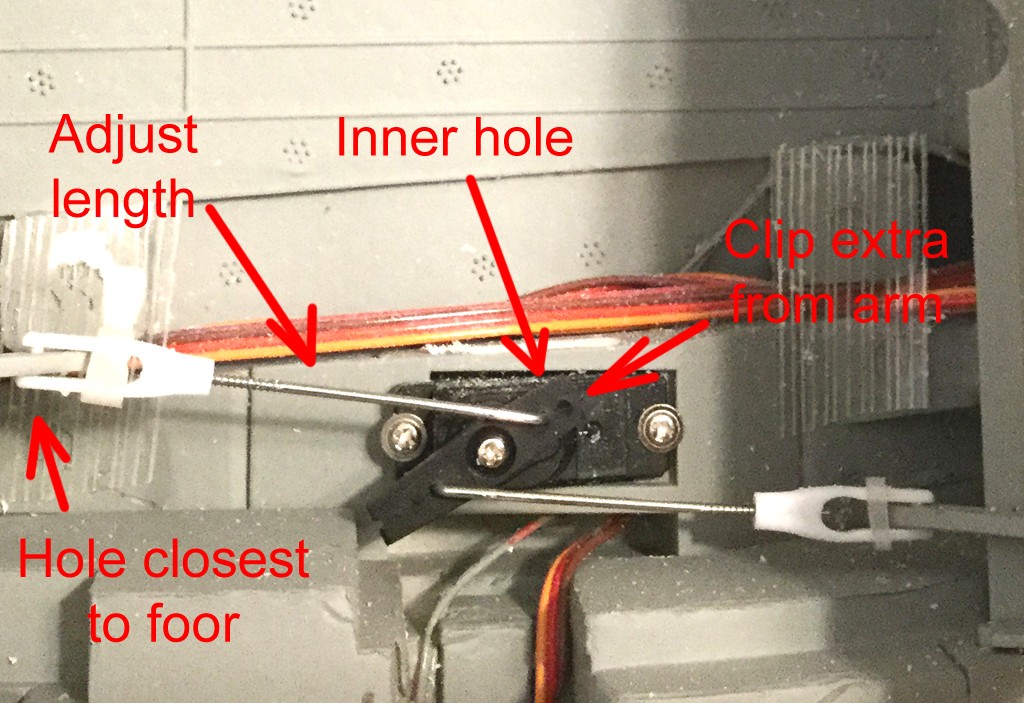

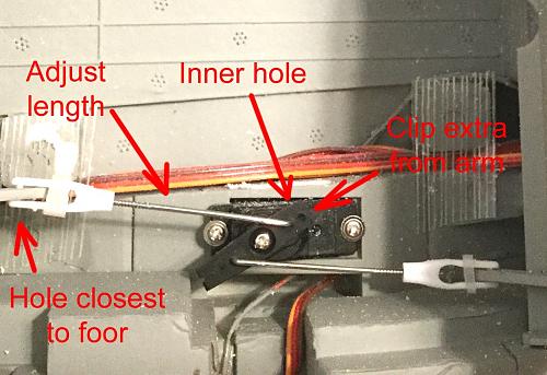

                              Next was moving the gear door control rods.
                              The right gear required moving the rod from the outer hole on the arm to the inner hole. Then clip off the extra from the arm. On the door end, move the clevis to the hole closest to the door. You will have to adjust the length to get proper door movement.
                              Click image for larger version  Name:	F4U_1600WheelMod_02.jpg Views:	1 Size:	190.1 KB ID:	175028

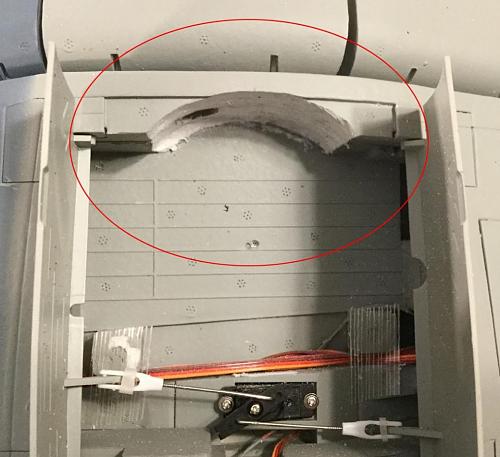

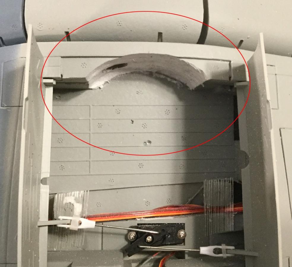

                              Final item was trimming back the rear edge of the wheel well.
                              Click image for larger version  Name:	F4U_1600WheelMod_03.jpg Views:	1 Size:	87.9 KB ID:	175029
                              Click image for larger version  Name:	F4U_1600WheelMod_04.jpg Views:	1 Size:	81.8 KB ID:	175030
                              The only negatives are you have to trim back beyond the edge of the rear gear door seam. Doesn't look too bad though especially since it's on the bottom. The other is the weight which with the power of this plane shouldn't make much difference. The weights I got for both the stock wheels were 1.96oz. The weight for both the Robart wheels with spoked hub caps are 5.56oz. So, a nominal increase of about 3.6oz.
                              Click image for larger version  Name:	F4U_1600WheelMod_05.jpg Views:	1 Size:	68.1 KB ID:	175031
                              Some final shots..
                              Click image for larger version  Name:	F4U_1600WheelMod_06.jpg Views:	1 Size:	178.4 KB ID:	175032
                              Click image for larger version  Name:	F4U_1600WheelMod_07.jpg Views:	1 Size:	190.4 KB ID:	175033
                              Click image for larger version  Name:	F4U_1600WheelMod_08.jpg Views:	1 Size:	207.0 KB ID:	175034

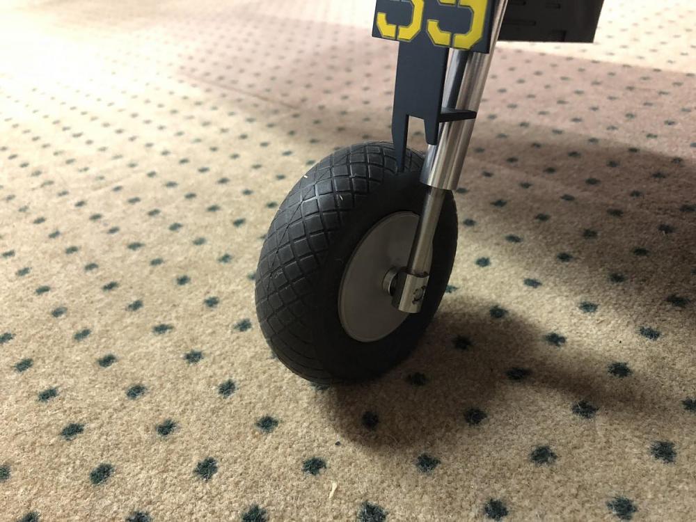

                                      #938
                                      Originally posted by Ole-Timer
                                      They are locktited in. But not with permanent red. Both of mine made a cracking sound as they broke loose but came out fine. Heat from a soldering gun also defeats really stuck locktited fasteners as heat breaks locktite down. I did not need to heat these but heat is the only answer on red permanent locktite. The cheap Turnigy drivers have never failed me either.
ID:	174865Click image for larger version

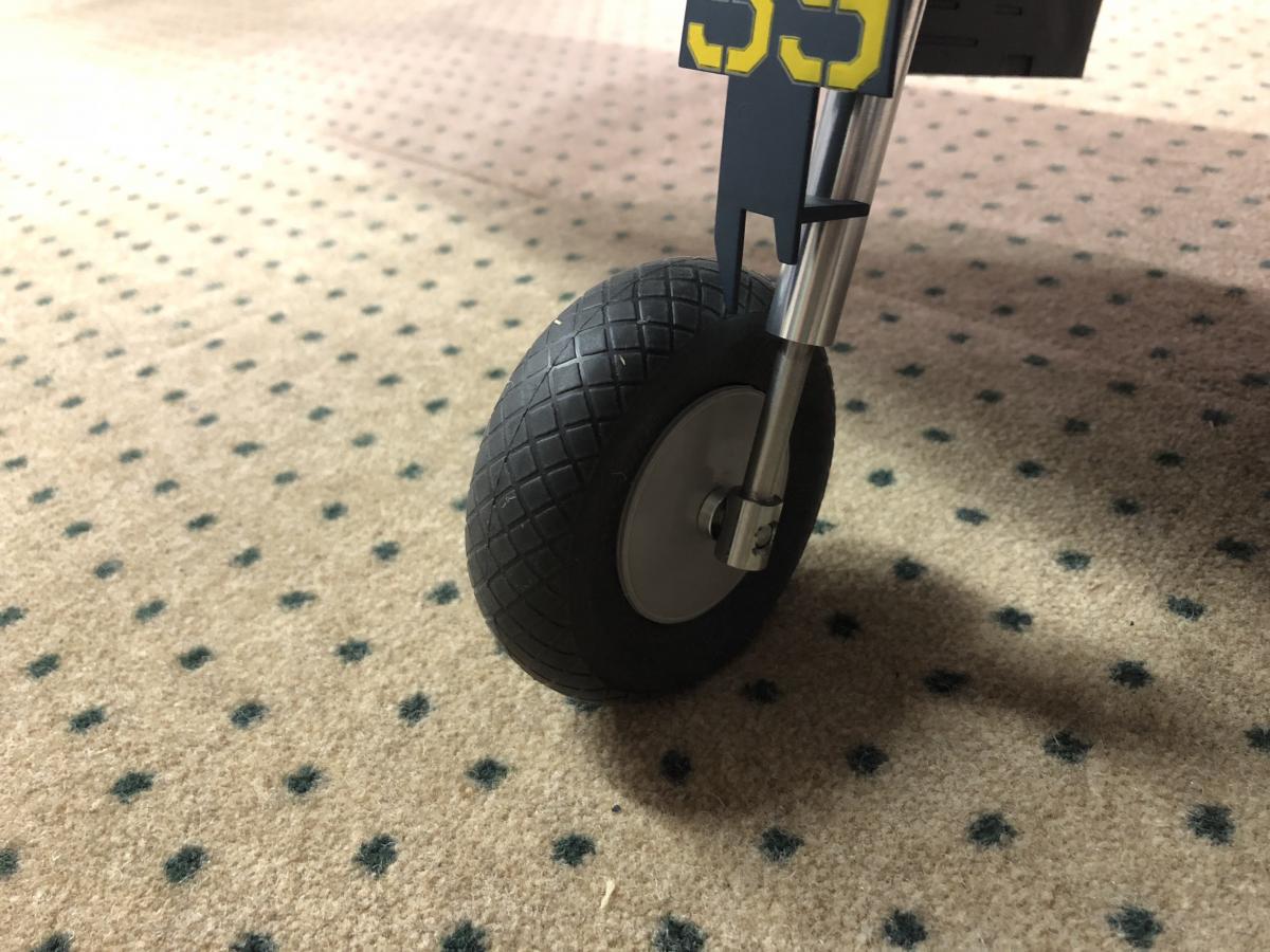

                                      Success - got the set screw out no problem but it appears the additional bushings that come with the wheel are not needed? Those bushings are all two small for the axel. What say you guys?

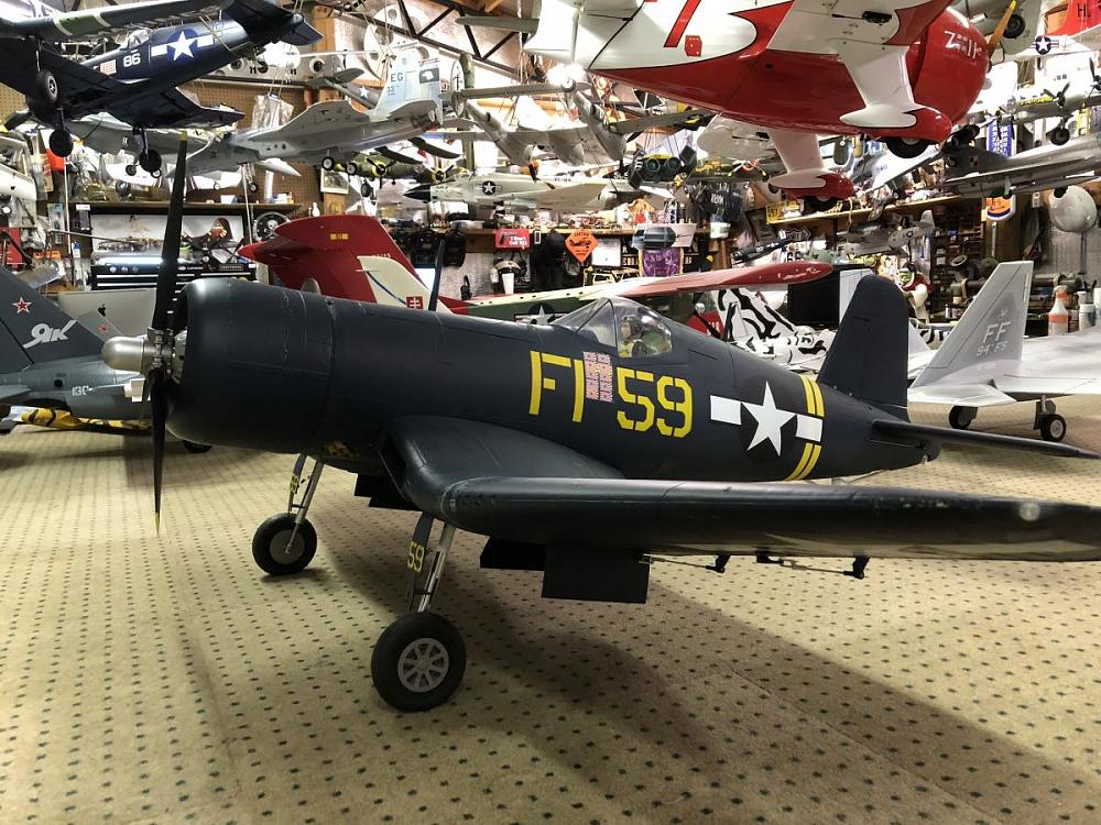

                                        #939
                                        Wearing the Robarts full time now:Cool:

                                          #940
                                          Robart bushings are simply to act as filler, so then, if the axle fits..., wear it! :Cool:
                                          They are not bearings so toss em in the spare parts box.
                                          Robart scale tires are all I use on my warbirds, only the Spitfire’s have stock shoes.
                                          Been using them since the 70’s.
