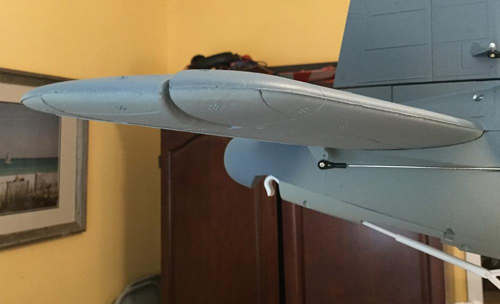

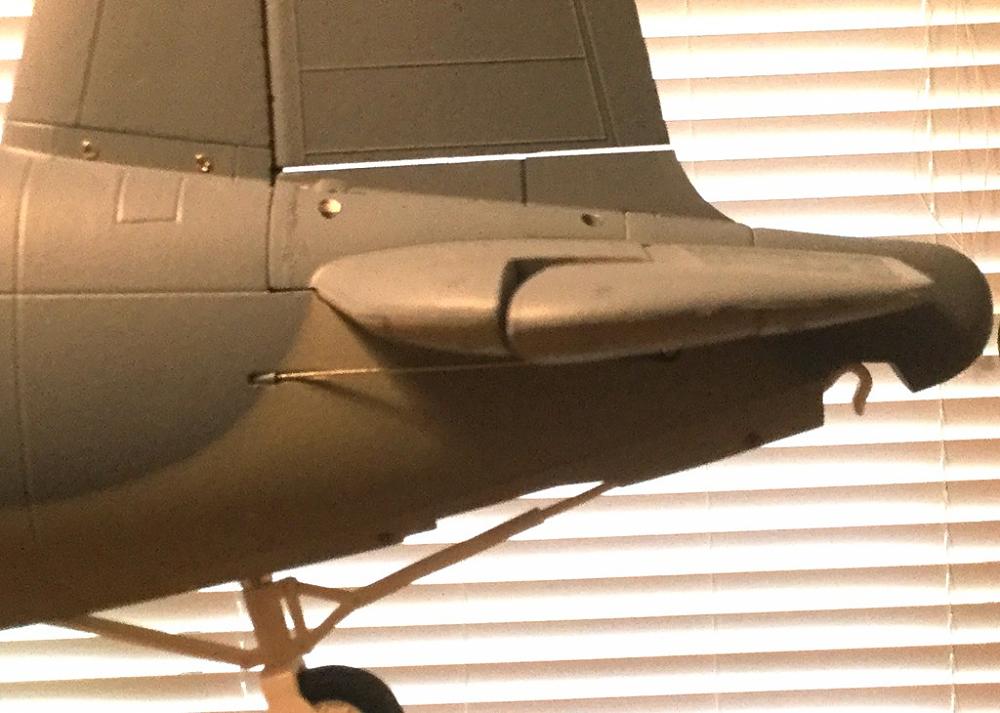

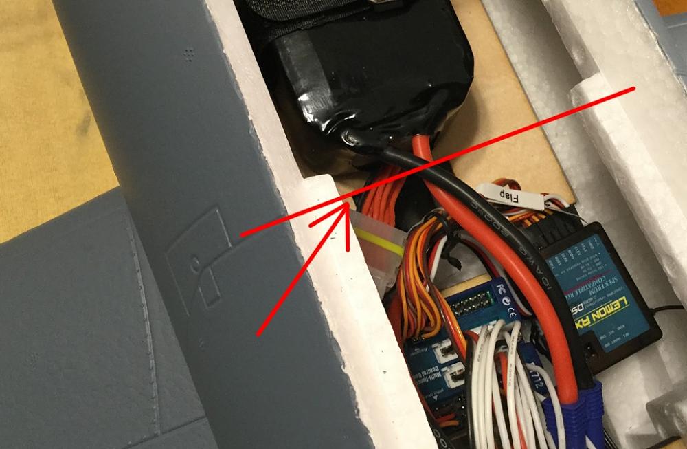

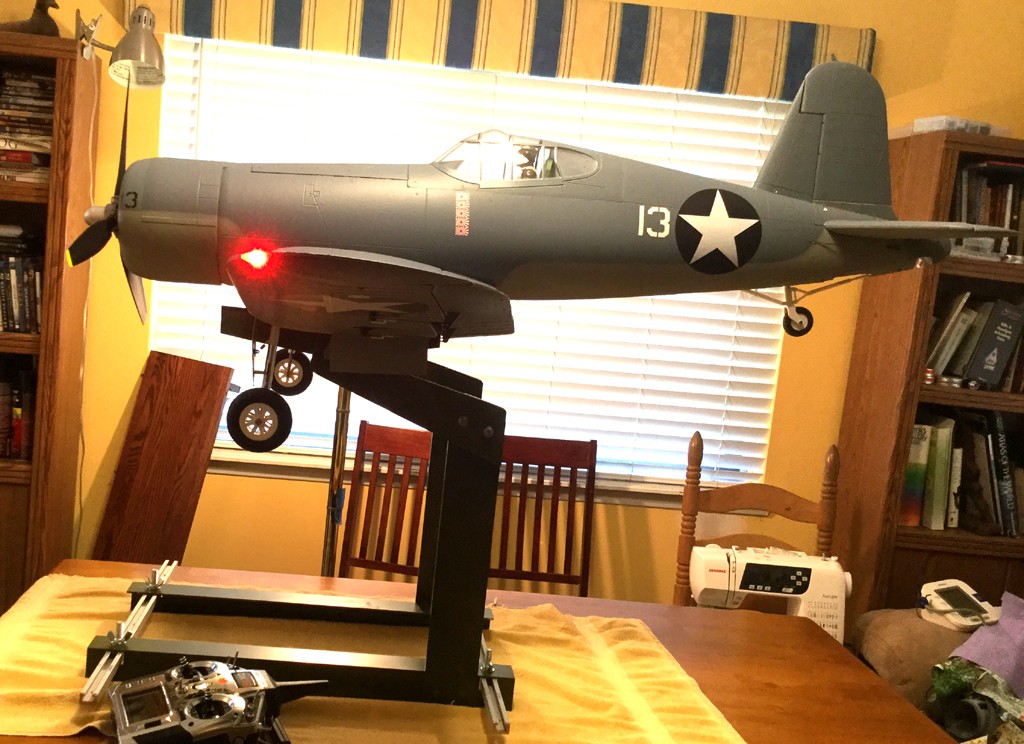

                              Back to the Corsair. If you haven't flown yours yet what I found is there is plenty of elevator you only need minimum throws for ELEVATOR and plenty of expo. On the elevator I had 25% expo on the maiden as I copied my FLRC Mk.IX profile but had to crank it up to 35% expo and 75% rate. This thing is very maneuverable but is one of the easiest to handle taildraggers for takeoff and landing. It also took off just fine with about half throttle. If you nail it on takeoff it will be airborne in a couple feet. Great job Motion RC!
                              Also, I had neutral on the elevator when rigging but needed a lot of up elevator trim.
                              Decided to add some more information:

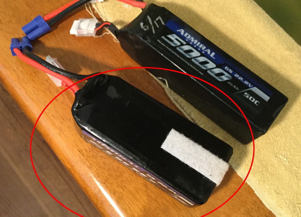

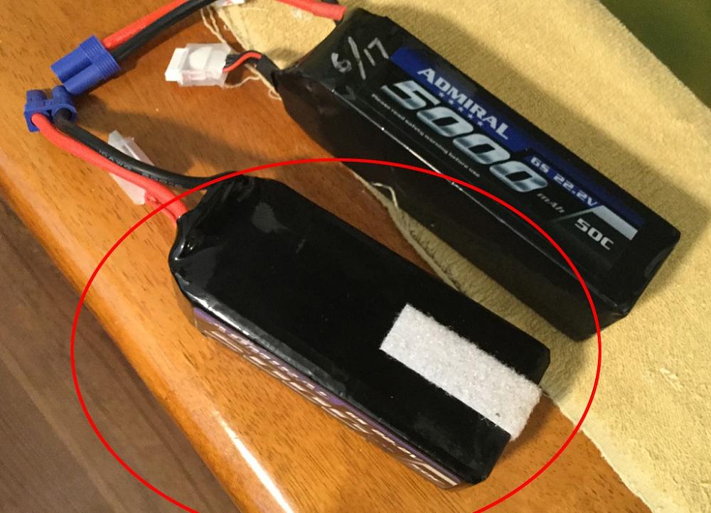

                              Balanced the plane gear down at book CG. I checked with gear retracted and the CG only moved about 3-4mm aft so pretty much gear up or down is fine. I used the older Admiral 6s 5000, which are a bit wider and shorter than current Admiral batteries. I placed the rear edge of the battery about even with the forward edge of the ESC air exit slot. Airplane is completely stock so far.
                              Click image for larger version  Name:	F4U_1600CG_01.jpg Views:	1 Size:	189.6 KB ID:	174767
                              Click image for larger version  Name:	F4U_1600CG_02.jpg Views:	1 Size:	169.8 KB ID:	174768
                              Click image for larger version  Name:	F4U_1600CG_03.jpg Views:	1 Size:	136.5 KB ID:	174769

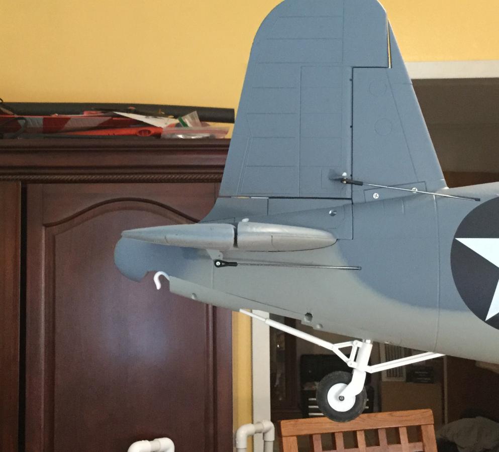

                              This is a shot of where the elevator trimmed out. Doesn't look like much but was half up trim from neutral. A little elevator on this thing is very effective and goes a long way.
                              Click image for larger version  Name:	F4U_1600CG_04.jpg Views:	1 Size:	75.0 KB ID:	174770
                              Click image for larger version  Name:	F4U_1600CG_05.jpg Views:	1 Size:	94.1 KB ID:	174771
                              Click image for larger version  Name:	F4U_1600CG_06.jpg Views:	1 Size:	148.1 KB ID:	174772
                                Mine's still in the box and will be for some time yet. Thanks for the info. By the time I build it, I will have forgotten all this so I've booked marked it for later. :Cool:
