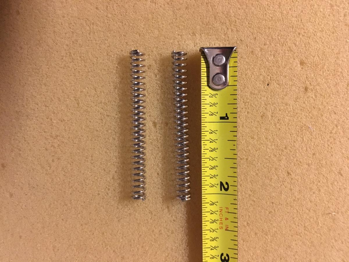

    Good Evening Guys! I've been out of contact for awhile...I had a birdcage and due to the classic Corsair stall, I lost it about a year ago. But I just got a replacement and am getting it prepped. There are two springs in the miscellaneous bag that I don't recognize from before...can you guys clue me in on what they are for? They look like maybe they would go over the struts, but ???

    When I received my bubble top I also had those two springs in the bag. I called Motion RC and they really did not know why they were there. They go inside the oleo struts on the main gear. So they finally said they were just extras. I thought that maybe they were a different strength and were provided to either stiffen or soften the struts. But, nobody so far knows the answer to that. I did not use them.

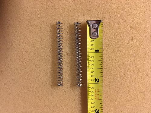

              Here's what they look like...Rob

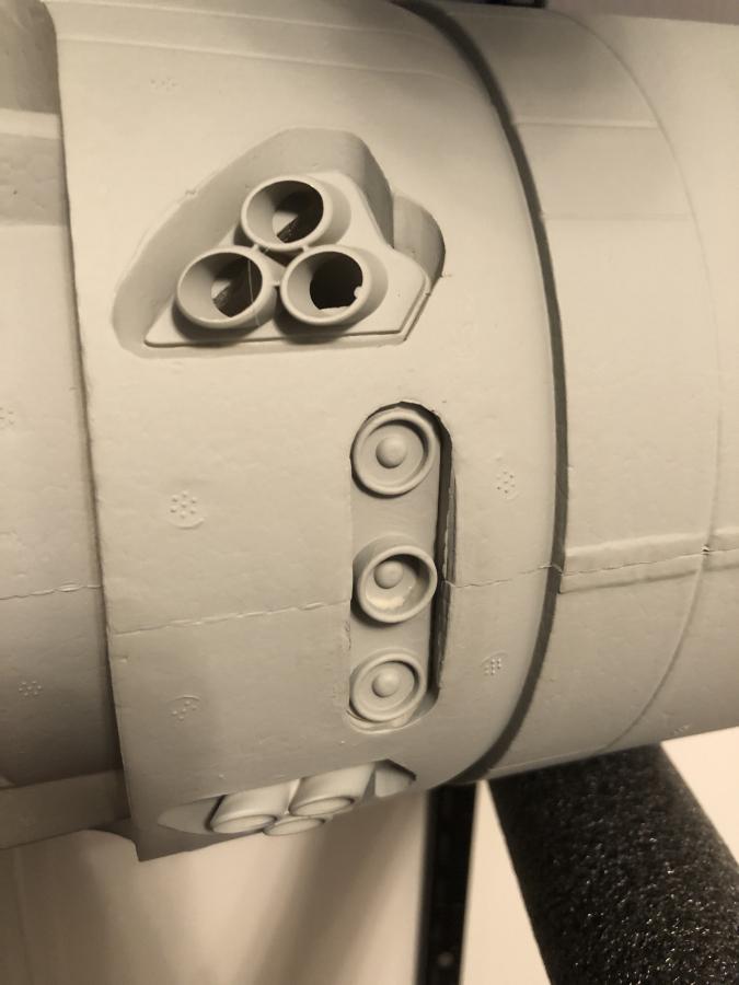

                  • So my exhaust are painted but I'm having trouble with the aluminum back plate that goes behind the prop. The first one had one hole in the outer row (the ones that take the shorter screw) that was drilled too big to even get the screw to start. I called and MRC sent a replacement which arrived yesterday. All the screws snugged down except one, again in the outer row, and this time the screw started but as soon as it began to get tension, it stripped out. I have tried other screws and flipped the plate to see if one side works better, but no joy. I'll call again tomorrow...apparently nobody else is having this issue?
                    Rob
                    • Have you tried a slightly bigger screw?
                      • I don’t know if I have one with the right thread pitch...I’ll have to poke through my stuff!
                        • If you get a slightly bigger screw, the thread won't matter as it'll make its own thread. Find one with same size and shape of head so it matches the others. The threaded part can be a bit wider and the length can also vary a bit. That part won't be seen.
                          • They can b hard to start. Very fine thread I have thought about drilling thru using a longer bolt(screw) with a nylock or nut at the very back couple dollers. I'm always nervous about stripping the thread. Nylock will stop it vibrating off

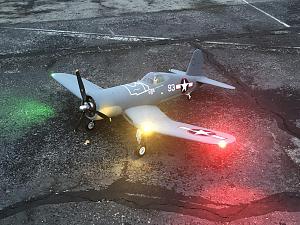

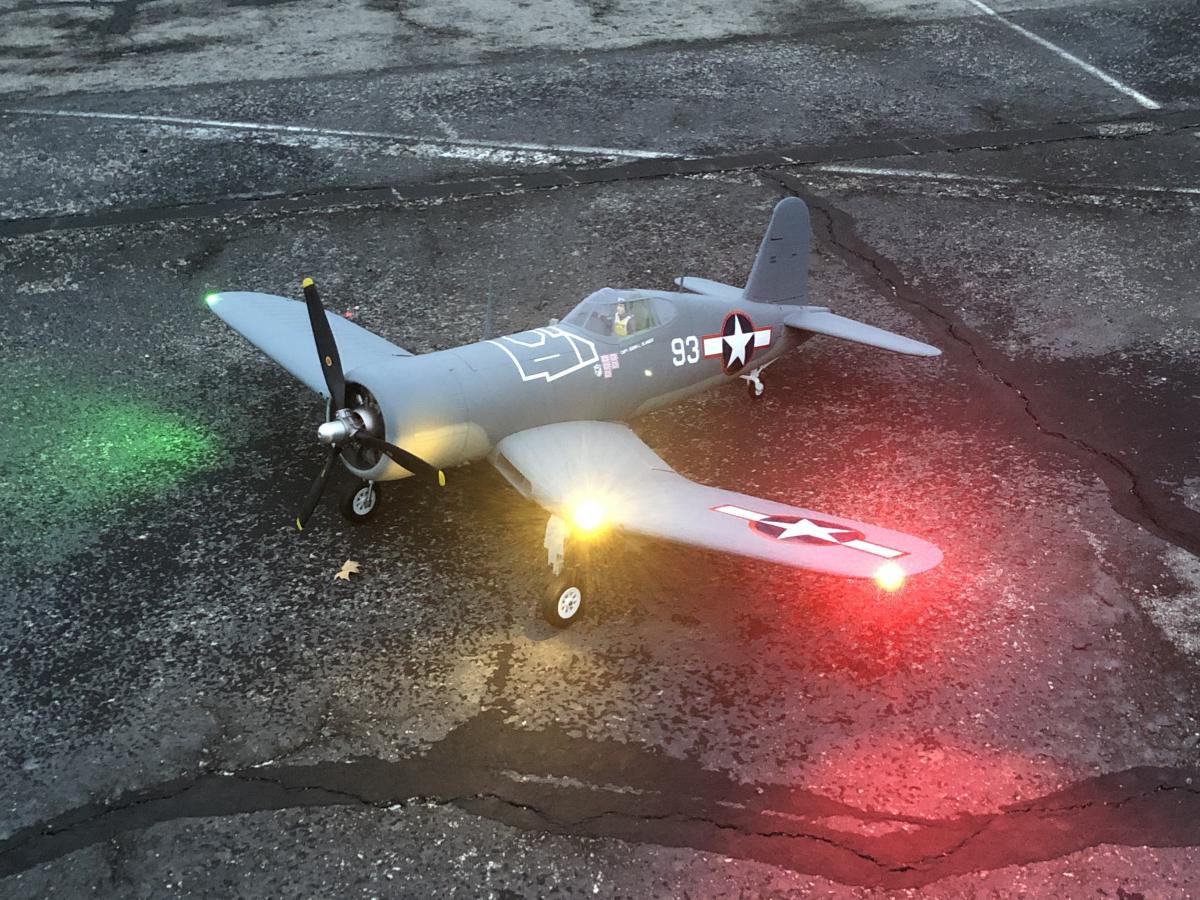

                                • Click image for larger version  Name:	11C7F819-620A-42F9-A688-4320CC723AFE.jpeg Views:	0 Size:	205.0 KB ID:	282486Click image for larger version  Name:	image.jpg Views:	0 Size:	45.6 KB ID:	282487 Got the maiden in Yesterday. Was like shaking hands with an old friend. A little bit of trim and she was gold. I did have to add one of the extra weights to reach cog. Landing were a bit bouncy but it was getting dark.
                                  I guess my plane got missed with the painted exhaust. See pic included. I did get a second flight in but had to keep it close because it was pretty much dark. Let’s just say the lights really stood out and were easy to see.

                                    The second set of OLEO springs are definitely firmer. The springs that are installed when you receive the model are softer and could possibly bottom out during a rough landing causing failures in the gear. I know because it happened to me. Since installing the firmer springs the ground handling is much better and I have not had any gear failures. IMO if you fly off a rough grass field the firmer springs are the way to go.

                                      They are firmer springs that are inside the main gear struts. IMO the firmer springs are recommended if you fly off a rough grass field

                                        Firmer Main gear springs. I Recommend using them if your field is bumpy, they will save your gear by keeping them from bottoming out on a rough landing which can cause gear failures.
