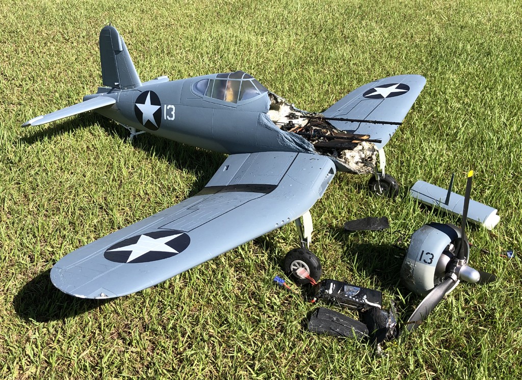

                    • Had a bad day at the field yesterday with my Corsair. As I was ready to take off for my second flight of the day, something didn't sound quite right so I started to taxi it back to check it out. Smoke started to bellow out of it, and when I took the hatch off there were flames. I got the battery out and another club member put the fire out with an extinguisher. Fortunately, the exterior of the plane is undamaged and there is a bit of melted foam under the battery and soot in the compartment. That's the good part.... The bad part is the ESC is what caught fire and it must have allowed high current to flow through the plane and it fried the receiver, blue control box, every servo, and the landing gear servos!! The battery turned out to be good, just coated with soot and the motor is fine. Just priced out the replacement parts which comes to just over $200. The fuselage ESC area where the foam melted should be fairly easy to repair. Not sure if I want to throw more money into it or just parts it out.
                      • sorry you had problems! I worked for IBM for some time and one of the big problems we had were called "circuit board extras", they were little balls of soldier not attached to anything and serving no purpose. the problem was if they broke loose during the life of the board where they wedged could cause a problem, like yours. we used to wash the circuit boards several times specifically to ketch these little buggers. I had and extra problem just like yours ~10 years ago took out ESC, battery and motor, smelled like a fire the rest of the planes life.

                          My wife is still complaining this morning that the house smells like burnt electrical wires!
                            Not too bad. Couple months ago mine was a bit worse due to a shorted out battery. Came out to about equal to total replacement plus the loss of the battery.
