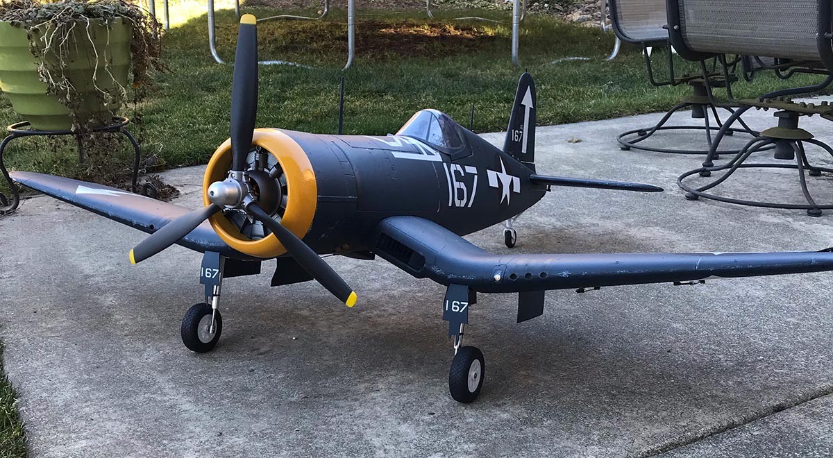

                      • So this happened yesterday! Woohoo!!!
                        • Hugh, had the same issues with my Robert wheels, thought I must have received old stock or something based on the how to in these threads. I Did not use the bushings, used alum and brass tubing cut to length, a little lithium grease and they run smooth and true. Nice the way the axles mount, no wheel collet required under the spokes as in the old days of changing to Robert wheels
                          • Originally posted by Md_cobra View Post
                            OK.... I really really like this livery!!! So just asking.... ( I am not a rivet counter ) is this correct for the bird cage? Just asking. Thanks guys !
                            • The lines forward are not. An I put the kill flags on backwards. Oh well. This plane was piloted by Capt. Edwin Olander. An was in the black sheep squadron so I added the squadron crest. I like it.

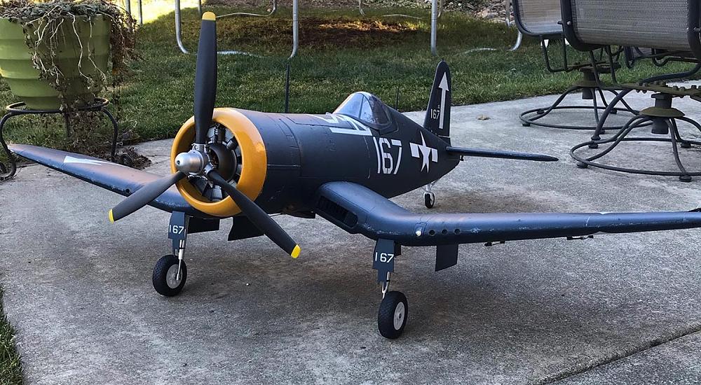

                                        • Got some flights in this evening. So nice to have her fully dressed. Wait..
