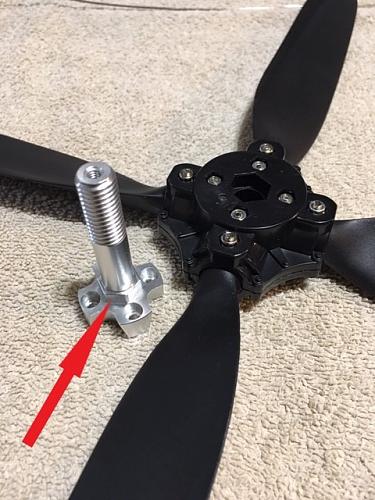

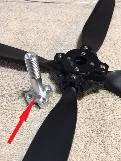

                                Thanks Xviper but I think I've had an epiphany. It's now obvious this is a DFU problem. The reason I can't find a spinner for my 4-blade prop set up is I'm wanting to use the "Prop Hub / Holder" with the 12mm HEX recess.
Name:	Prop Setup 3.JPG
                                There's no way I can fit a spinner backplate under this set up since the prop "hub / holder" is actually the spinner itself. I may simply need to change my direction and use a different prop setup but I need to figure this out so I'll take it to the Hangar9 P-51 thread and not annoy anyone further. Thanks for you inputs :Cool:

                                  One mre cmment... insert the shaft with the Hex in any plastic backplate spinner. Impact the back of the prop adapter to impress the hex on the backplate. Cut the lines you created.
