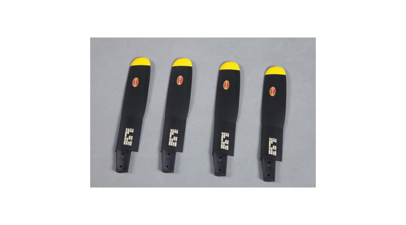

                                      Originally posted by prestonowtm
                                      Is this "prop" issue going on a problem with the prop setup? The setup looks like the F7F setup which has crashed quite a few planes from blowing apart.
                                      PRESTON - If you're referring to the FL Corsair 1600mm 3-blade (18X12) prop setup, an earlier posting asked if the FMS 1700mm Corsair 4-blade (17X10) prop setup (Pic 1) will work with the FL 1600mm? The answer from TiredIron was yes but you'd need the 4-blade prop hub / holder. Turns out the FMS 1700mm P51 also used that same 17X10 props so I wanted to use that same 4-blade setup on my H9 P51 20cc because I like the prop hub / holder.

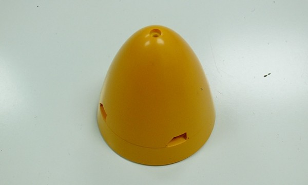

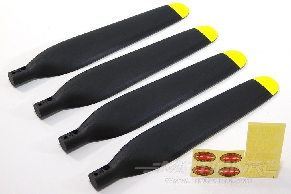

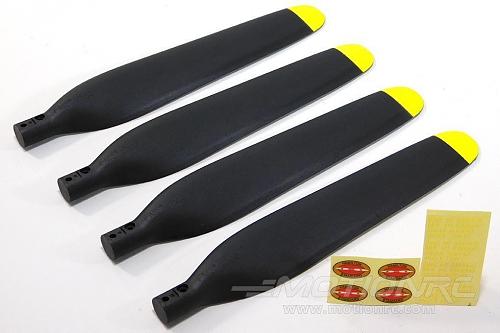

                                      Unfortunately I've discovered the FMS 1700mm P51 (17X10) 4-blade prop setup (Pic 1) - and spinner (Pic 2) had a reputation of blowing apart BUT - FMS came out with a new prop, a 17X9 (FMMPROP001 - Pic 3) which solved the problem. They're much flatter at the root for a better hold so I purchased a couple sets of those 17X9 props and spinners since they're discontinued. The good news is I ended up with just some extra Corsair 17X10 props and a 4-blade hub/holder so I can interchange between the 3-blade and 4-blade just for looks. :Cool: Now - back to just the Corsair...……:)

                                        Good deal...worried me for a bit since this is my next plane. The F7 I have is incredible but the prop issue sucked bad until I found a fix. Wasn't wanting to do the same thing here.
