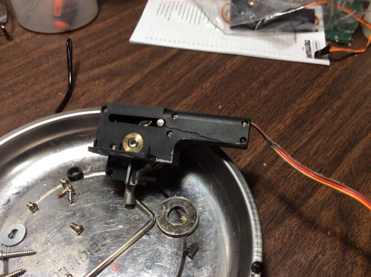

                    So for any of you that have broken your main landing gear, could you post some pictures of what’s failing.
                    Pretty please, I just love pictures. :pop

                      I've had a number of planes with Retracts. Rotating retracts have always been challenging. A poor rotating mechanism can cause headaches and gets costly. Is this Corsair's retracts a poor design?
                      Has anyone posted pictures of how/where they fail?
                      Is it from poor/bad landings or just from normal wear and tear. Motion's offering of the 1600mm Corsair hasn't been out that long so I suspect the gear isn't all that forgiving on other than perfect landings.

                          I fly the Corsair only off of tarmac runway and had the port gear fail to retract after one particular perfect (in my mind!) landing. To date all of my landings have been no bounce, very pleasant ones. Anyway, I removed that gear assembly and found that the jackscrew in the retract unit was bent and so stalling out the retract motor. Have not figured out what could have caused that to bend -- a goodly aft force on the wheel at touchdown putting a load on the trunnion maybe ? Tried to straighten but that shaft has some solid heat treat and seems to be integral with the motor shaft anyway so cannot replace. I replaced the whole gear assembly (Motion being out of stock on just the retract unit) and all is well. I thought that replacing the unit was a piece of cake, if you find that process hard then you haven't built many models from scratch !
                          Note that I had the same thing happen with my F/W F-4 nosegear --- a bent jackscrew preventing rotation of the motor and thus cycling of the gear. Again I do not remember ever doing a really hard landing with this model (is usually a very nice wheeled on landing that sticks solidly). Have never broken the oleo/trunnion pin as seems to be the common weak point of the nosegear on a hard landing with the F-4.

                                    #2217
                                    I broke this while trying to fly in fog. I think this is the common problem.
                                    In no way am I am an outstanding pilot but I think the most common problem is we are trying to land this plane too slow. I have found that if you have a Spectrum radio,you set an alarm for center point on the throttle, you also can add the racket strip. I found both of these a great help in flying, I setup at 1/2 throttle with a little up elevator, once the landing flaps come on, I fly it to the end of strip and come back about 3 clicks and let it land. I think that is more speed that what was seen in the videos or the speed was misleading in the videos, as we see them. Does that make sense?
                                    Don’t burn me on this.
                                    Ken
                                      #2218
                                      I can certainly attest to being too slow is what bit me. It's something I very rarely do with warbirds, especially Corsairs in this size range, but Dumb Thumbs happen. This model should always be flown to the ground with 25-30% power give-or-take headwind conditions and other factors. Anything under 25% power is asking for trouble.
