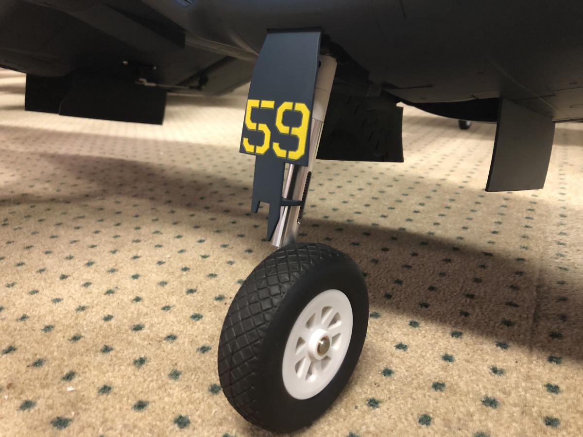

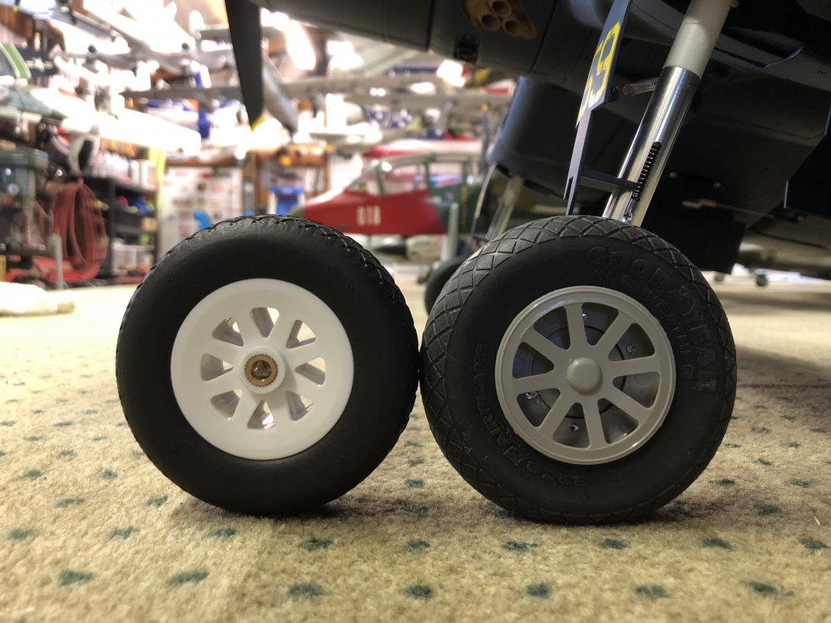

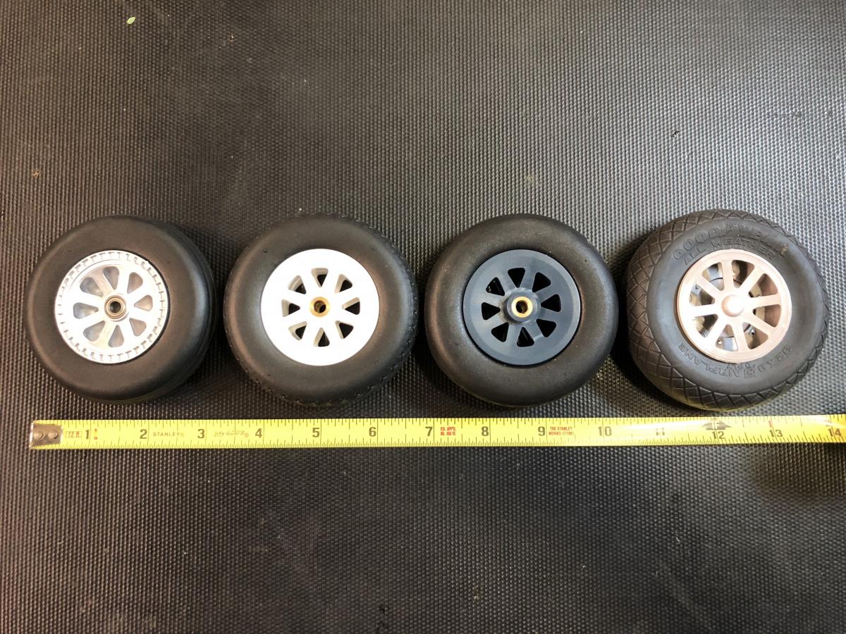

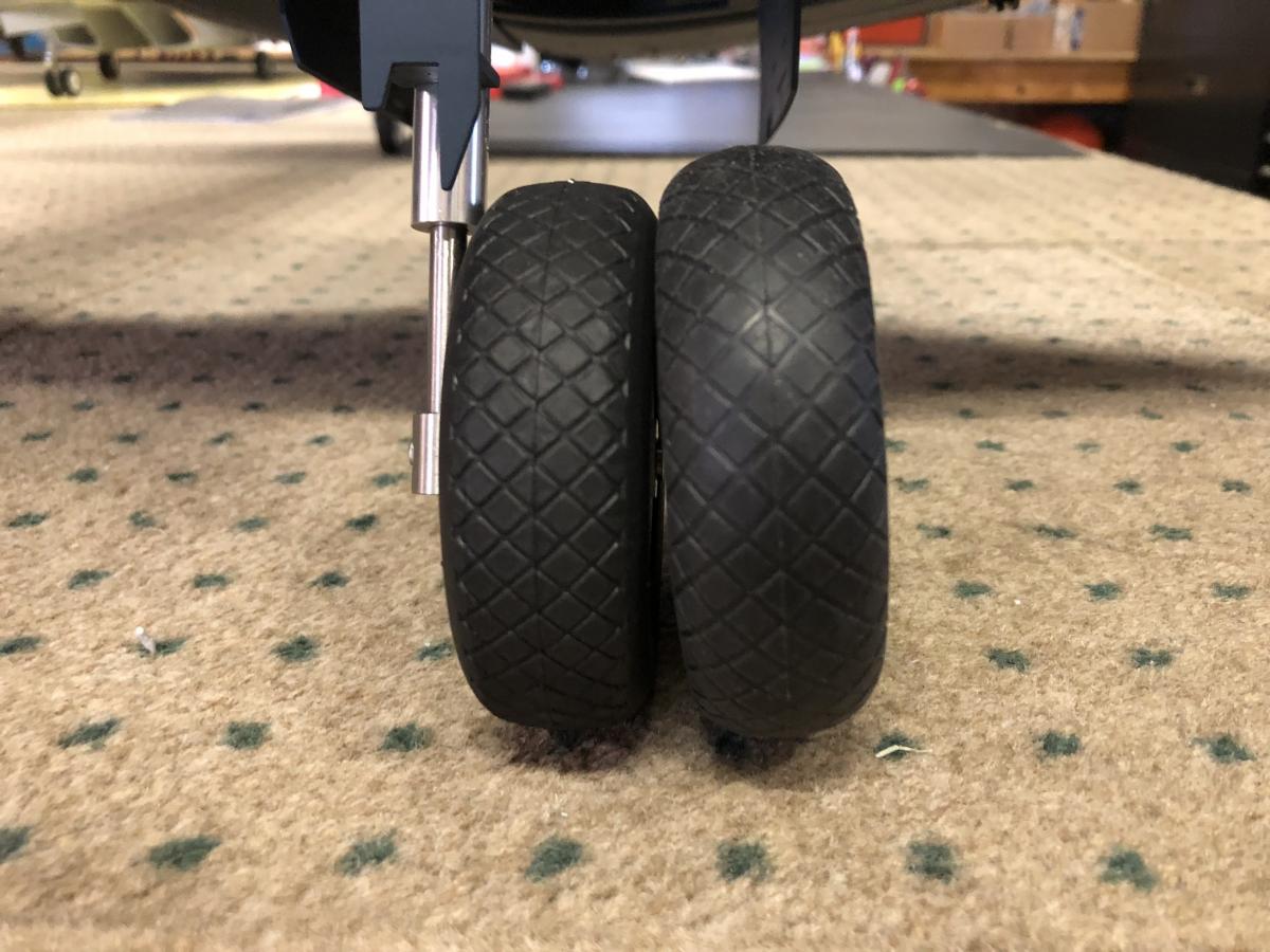

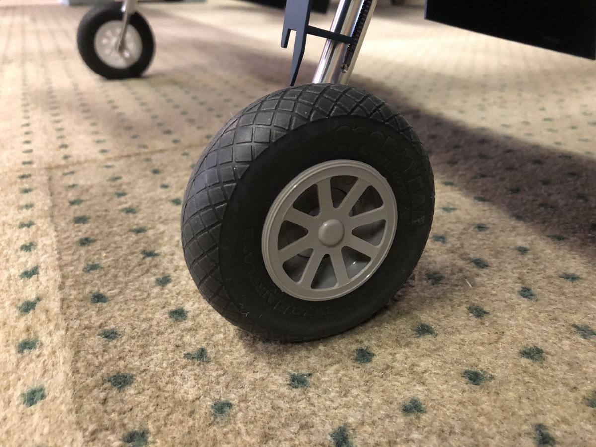

                              • I've had several questions about what wheels will fit on the F4U so I put this together...
                                I usually keep a set of 2.75" through 4" Robart Diamond thread on hand I like them so much :o
                                To recap, the Flightline Corsair and Tigercat have 5.1mm axles and the only difference between their wheels is the color (blue and white).
                                The FMS Tigercat Wheels are actually a little smaller that the Flightline wheels and the FMS axle is only 4.95mm.
                                Stock Flightline wheel is 3.375"
                                Stock FMS TC wheel is 3.25"
                                The Robart 3.5" wheel will fit but the axle will need to be shortened and new flat cut in it.
                                The Robart 3.75"wheel will also need the axle mod and may require some reworking of the gear door servo linkage.
                                The Flightline wheels weigh 28g
                                The FMS TC wheels weigh 30g
                                The Robart wheels weigh 74g
                                I think the 3.5" Robart is the sweet spot for this plane and even though it is much heavier it still has good cushion. The added weight doesn't bother be as I like the feel of it with the heavier Admiral Carbon 5100 much better.
                                Click image for larger version  Name:	Tires01.jpg Views:	2 Size:	112.0 KB ID:	167658
                                Click image for larger version  Name:	Tires02.jpg Views:	2 Size:	132.6 KB ID:	167657
                                Click image for larger version  Name:	Tires03.jpg Views:	1 Size:	139.4 KB ID:	167661
                                Click image for larger version  Name:	Tires04.jpg Views:	1 Size:	129.4 KB ID:	167659
                                Click image for larger version  Name:	Tires05.jpg Views:	1 Size:	128.4 KB ID:	167660
                                Click image for larger version  Name:	Tires06.jpg Views:	1 Size:	226.4 KB ID:	167662
