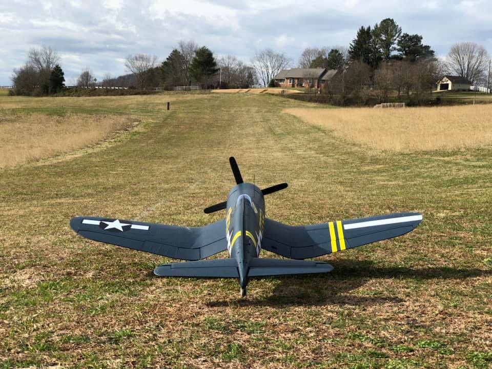

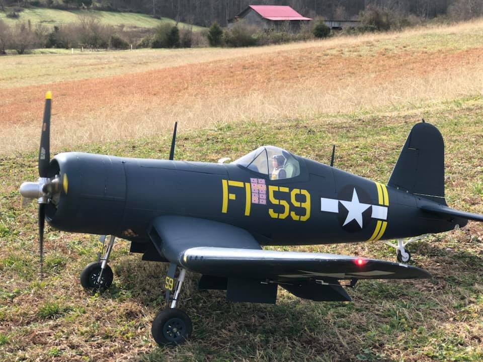

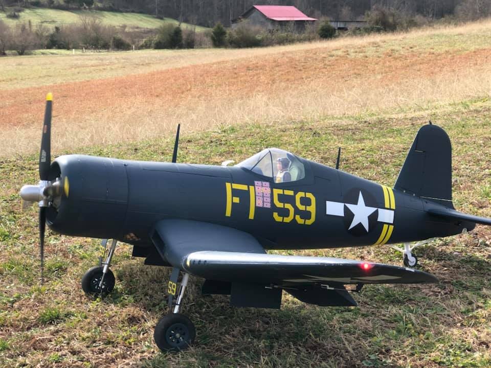

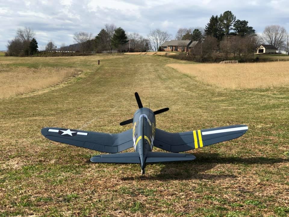

                  First flight today was on the Flightline Corsair, 65° sunny morning, wind straight down the runway. I got 19 minutes on the RT 6250 and lowest cell was 3.78:Cool:

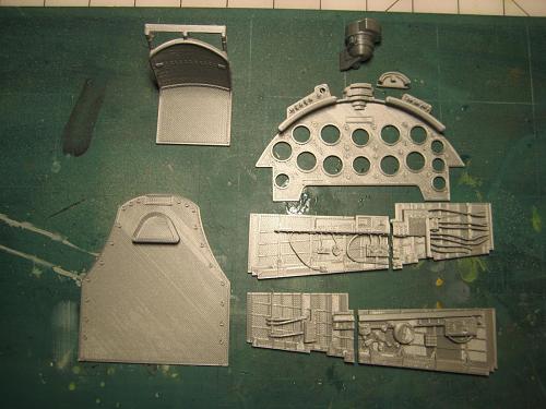

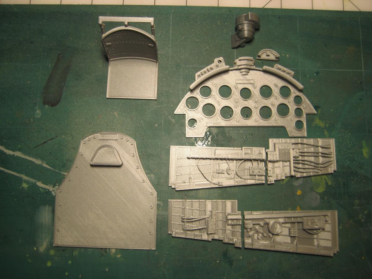

                        Printing my Cockpit now.... Alas I ordered the Bird cage so the 4 Blade is not an option.... I hope they come in early!!
                          • 4820
                          #272
                          Printing my Cockpit now... Alas, I ordered the Birdcage so the 4 Blade is not an option... I hope they come in early!!
                          E4DG, I printed mine, too, and I have a question. How did you print the side panels? I 'cut' those (z=52) in my slicer to minimize the support from the print bed, but would rather have printed those as one piece. Any suggestions? Best, LB

                            #273
                            Click image for larger version Name:	IMG_0007.JPG Views:	1 Size:	143.6 KB ID:	169752
                            Use the slicer's lay flat option. In Cura is under Rotate object.
                            Not sure why the side panel objects aren't laying flat to start with.
                              • 4820
                              #274
                              FHH, Thank you. Happy New Year, friend. Best, LB
                              ps: Prusa has an update to Prusa Slic3r. Version: Slic3rPE alpha1+win64-full-201812231738 and this has the 'Object-Lay Flat' option. Going to give it go later today
                              Thanks some more FHH.
