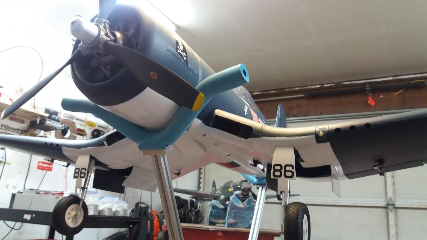

    The 1700mm Corsair prop bolt's right on....

            And how does it fly with the 4-blade vs the stock 3-blade. Can't find Tired Iron's original post. I'm so happy with the way mine performs with the stock prop, that I'd hate to change it, unless of course if there is no loss or performance or efficiency. The 4-blade sure looks sharp though.
              • 8830
              #3346

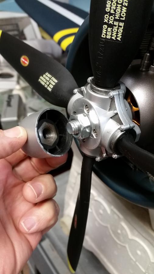

              I flew mine with the stock 3-blade, then went to the FMS 1700mm 4-blade. I couldn't tell the difference in performance. However, it's not quite a "bolt on". The hex on the motor shaft is too small for the hex hole in the 4-blade hub. You need to wrap some tape around the hex on the shaft till the prop fits snugly onto it. It took about 3-4 wrap arounds with masking tape to make it work. Then cut the tape flush with the surface edge of the hex.
              To me, it just looks better for a Corsair to have a 4-blade. Most people I fly with can't even remember a Corsair with a 3-blade.

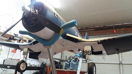

                I agree with Viper's post. I did the same thing! (great minds think alike)
                (I think mine flies a little slow with the 4-blade. But I have not tried flying with the three-blade yet. I like flying "scale" and I'm really very happy with the way my Corsair performs. I have been meaning to try the 3-blade. I was thinking it might be a little faster with the 3-blade but if Viper says its about the same, well there you go.)
                Here's a little bit more for Hugh... along with the FMS hub and blades, I also purchased the FMS prop adapter shaft - and found that it would not fit the FW motor - so unless you change the original motor you must use the prop shaft that the model came with... and as Viper said you have to enlarge the hex-shaped base so that the 4-blade hub fits properly. Well, what I want to add is that the FMS prop shaft is the same thread but its about 1/4" longer. When putting it all together I found that the FMS prop hub is so thick that there wasn't enough of the prop adapter sticking out for the acorn hub to screw onto. I had to remove a little from the back side of the acorn to shorten the sleeve and make it work. So it does need some fiddling but it did work out OK in the end. The slightly shorter acorn isn't noticeable.
                I painted the hub and acorn silver. Here are some pics.

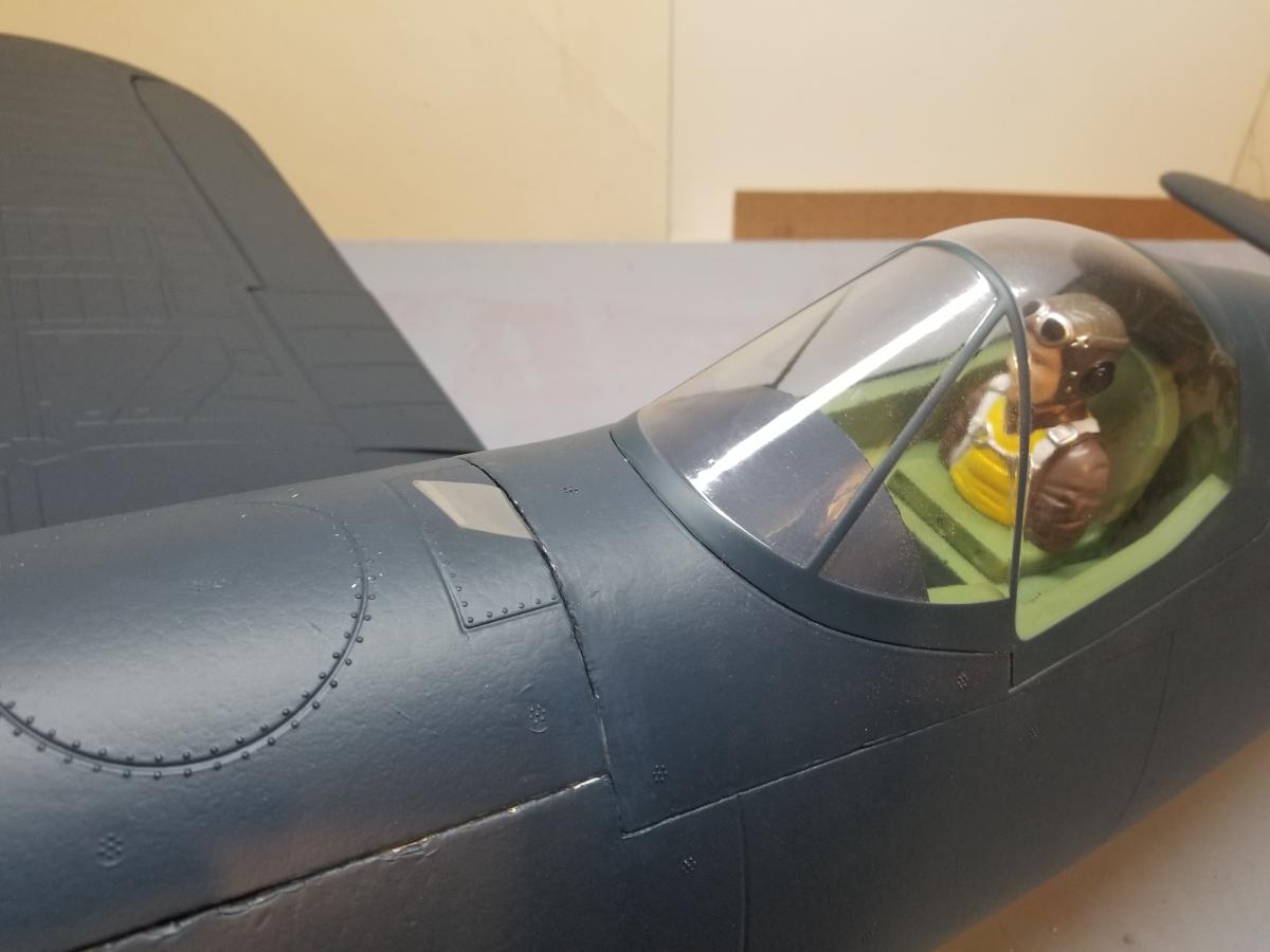

                          I don't see the piece of clear tape for opening the hatch in anyone's photos. Did you remove it,and if so what method are you using to open the hatch?

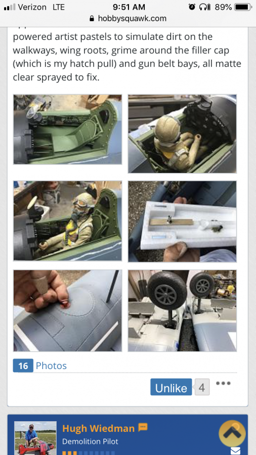

                            People are making a fake fuel filler cap that can be pulled up. Cool idea. Look for the pics of the red caps in the big circle on the hatch.
                            Edit: it looks like it was Mr. Smoothie who had the idea. Please correct me if I’m wrong don’t want to take credit away from anyone. I searched photos only and his was the first I had seen. Here are some photos of the post and the mechanism. Click image for larger version

                              Thank you! Great idea! I've been reading thru this thread. I'm up to page 69 and I didn't see that about the filler cap hatch pull.

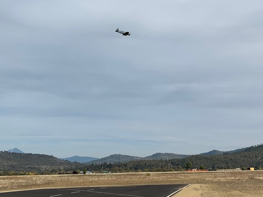

                                Hi Guys,
                                One of the local guys ((Thanks Scott)) took some shots of my Corsair today. Its only from my phone, so the resolution is not to great. This plane is so much fun!!
                                Rich

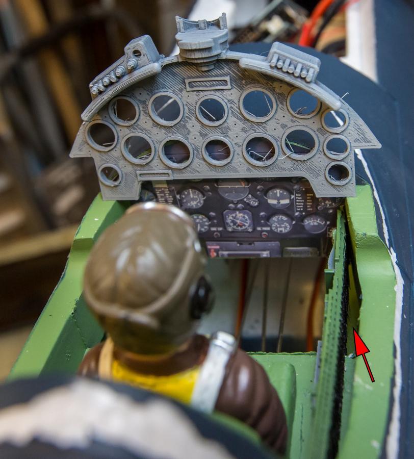

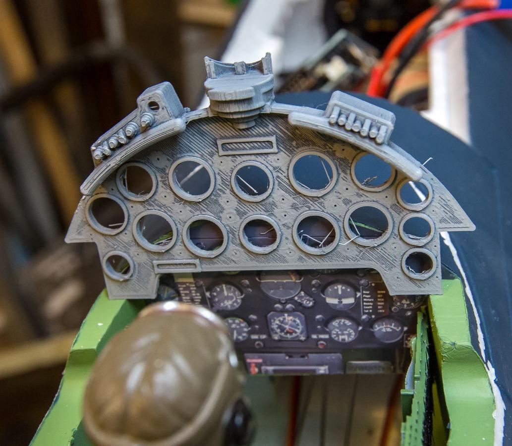

                                    My 3D cockpit parts don't to fit well.

                                      KMD, Which STL files are you using? Check the MotionRC website for the Corsair, then 'click' on the Support page. There should be an updated set of STL files with cut down versions of all the 3DPUP parts that required a mend. If those are incorrect, please inform me via PM. Best, LB

                                        I got the STL files somewhere in this message thread. They have some 3D printers where I work and they printed them for me for free during their "down time", but it took a month for them to get to it. I don't want to tell them that I gave them the wrong files and ask them to do it again. Is there anyone on here, or some place where purchase the proper printed parts?
