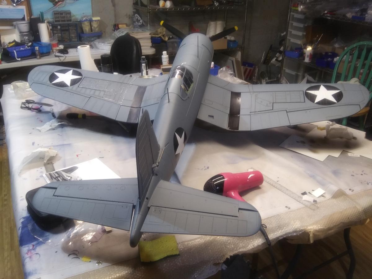

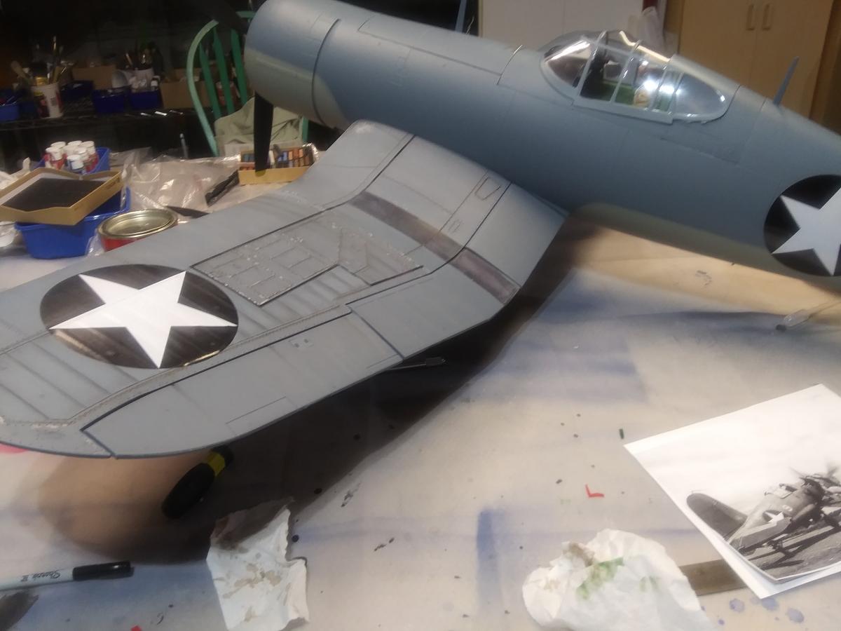

                    Well, the decals are on their way as well as the Robarts, did some preliminary painting on the instrument panel as well as some more weathering, its a long process as we all know.
                    Port wing looks pretty good so far, time to get the starboard side caught up. Fortunately, I have some time off at Thanksgiving. I've been looking at pics of pilots and maintenance men how they stood where they stood to give me an idea where they may have worn through the paint down to the metal.
