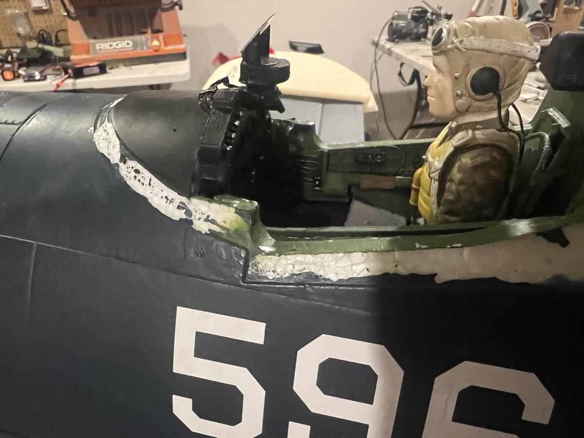

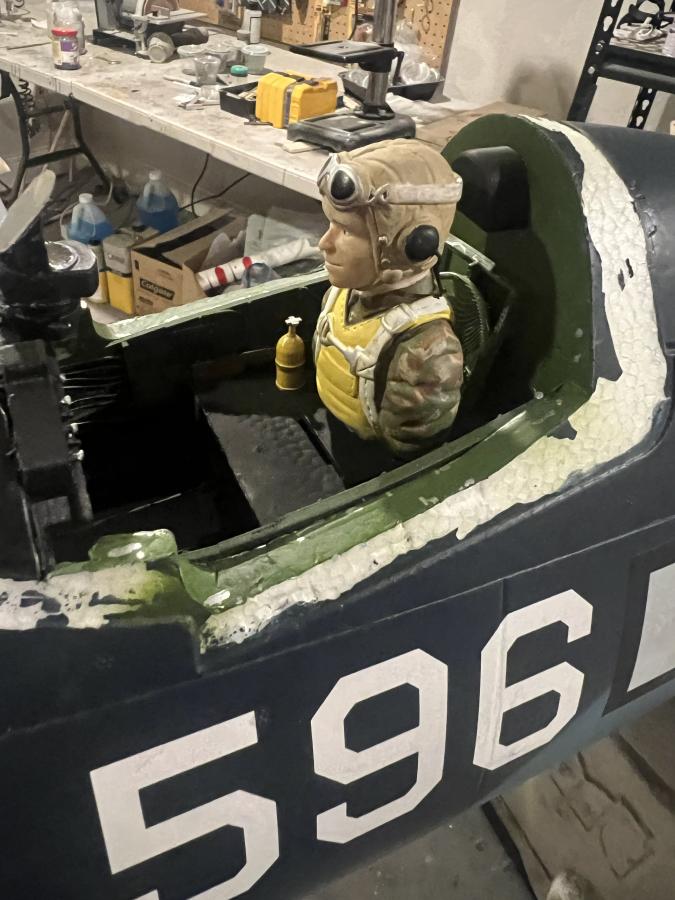

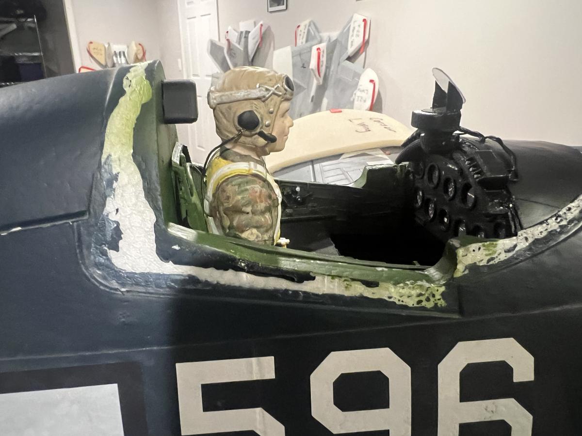

                    While I was printing up some cockpit parts for Dan, I decided to do a little "look-see" on my own Corsair cockpit. I have had this plane about 5 years, and I think the only 3D printed part I put in it was the forward control panel and Mk 8 gunsight that someone else did for me long before I started dabbling in 3D printing. I did paint up the stock pilot a bit to a USMC shirt jacket that was the type that the subject of this plane, Lt. Robert M. Hanson, habitually wore on his missions. While I was about it, I made the following embellishments on the cockpit:
                    1) printed, painted, and installed side control panels
                    2) printed new head rest on back wall
                    3) printed and painted a crew oxygen bottle installed on the right side of the cockpit next to the pilot
                    4) installed clear sheet of armored "glass" in front of the pilot behind the curved windscreen
                    I'll include a few pics, but they aren't all that good due to the poor lighting in my shop. The canopy is now being glued on with canopy glue and taped down overnight until it dries.
                    I decided against going any further in printing up a more detailed full body pilot and all those extra details. This old bird has a ton of flights on it, and I think it is pretty good as is. I've had my "fun" doing detailed cockpits on big gassers P-47 and P-51 models that are now safely ensconsed in museums after their flying days were over. I'll devote some time doing what I can to help Dan with his beautiful birdcage Corsair.

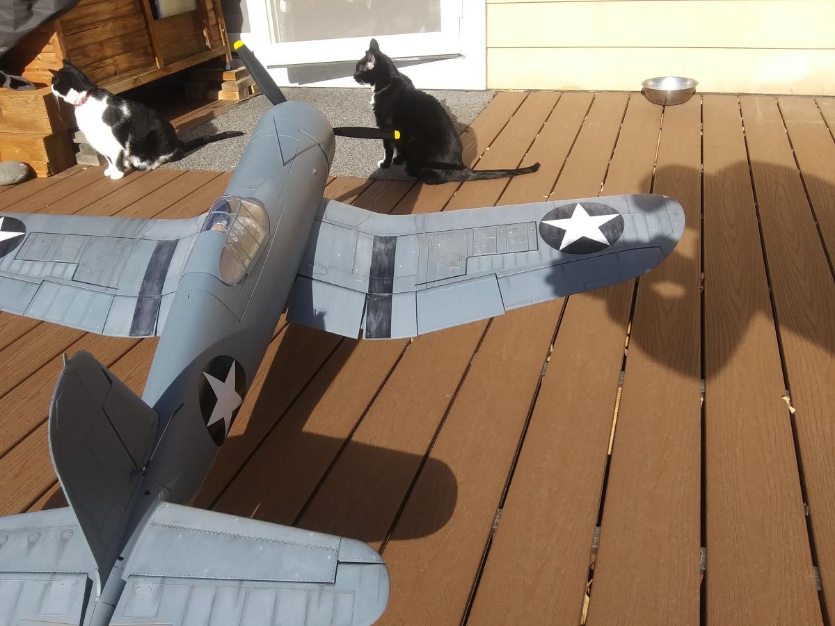

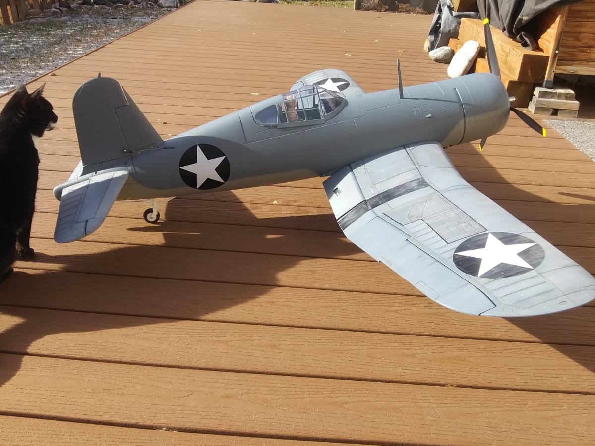

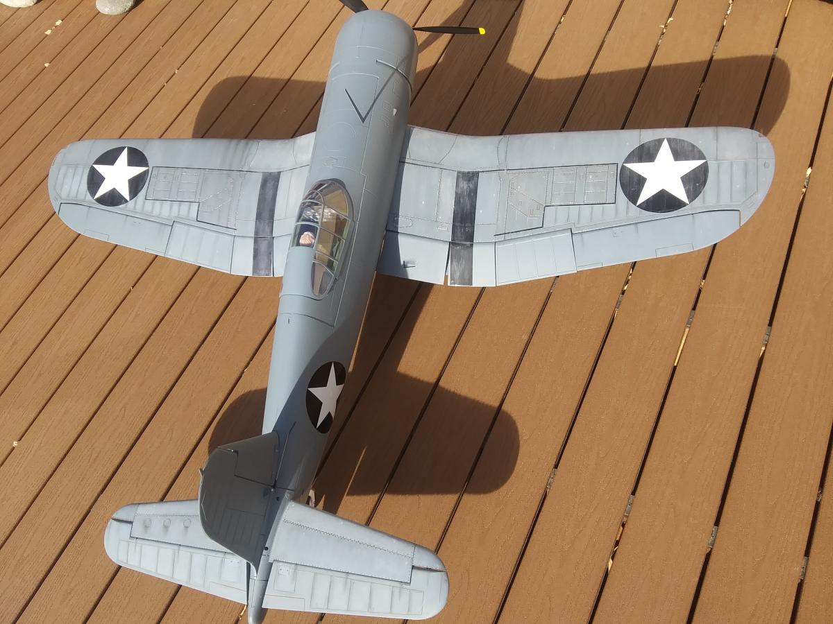

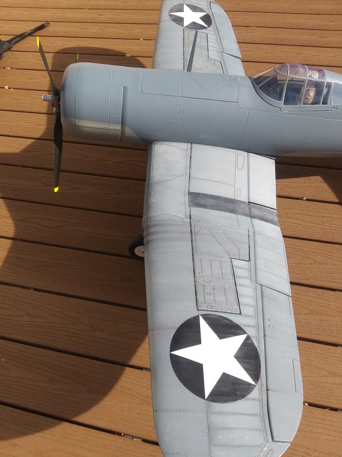

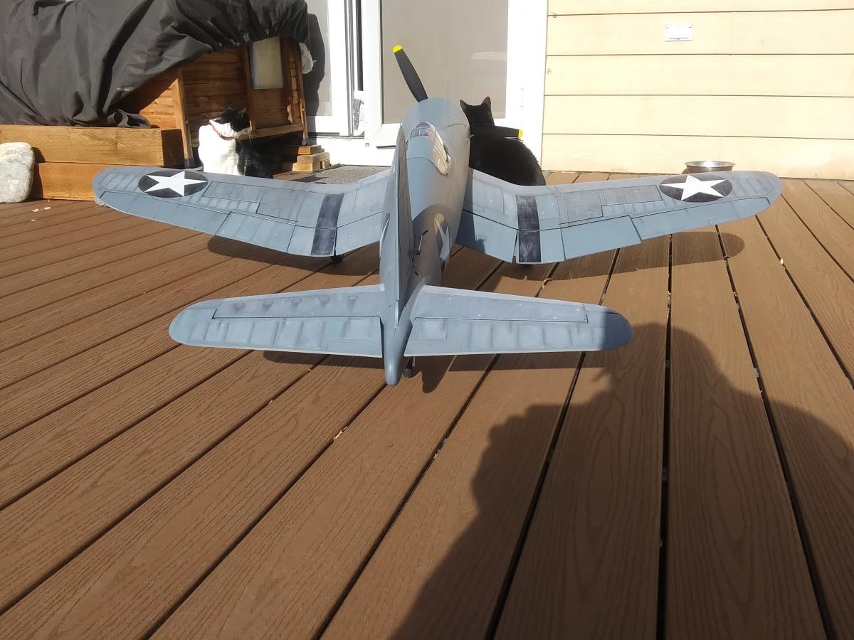

                          Anyway, got the starboard side wing looking close the port now, took here out in the sun for the official 'welcome to the Hangar' pictures, a tradition I do with all my birds, see what you think:
                          Click image for larger version  Name:	20241125_115058.jpg Views:	0 Size:	134.1 KB ID:	414771thr
                          Click image for larger version  Name:	20241125_115428.jpg Views:	0 Size:	123.3 KB ID:	414772
                          The official cat(s) picture. They come running outside when I do this, you think they know??
                          Number three was too busy cuddling with his mom. Click image for larger version  Name:	20241125_115208.jpg Views:	0 Size:	156.5 KB ID:	414773
                          Now, the starboard wing isn't quite complete, gun smoke and some more work on the flaps. The chalk colors I'm using besides black and white are a light coral pink, a dark blue and a light blue and purple all blended from leading to trailing edge by index finger. So far, so good. Just waiting for the decals, then she comes apart.
                          (Dangerous Dan)

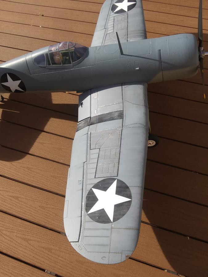

                            Aw heck, may as well post the rest of them too. BTW, I used workable fixative on this coat just before bringing her up, if you fine mist in short burst, not directly at the wing, but just over it so it can settle down on the wing, it works great.
                            Click image for larger version  Name:	20241125_115058.jpg Views:	0 Size:	134.1 KB ID:	414777
                            Click image for larger version  Name:	20241125_115128.jpg Views:	0 Size:	77.2 KB ID:	414779
                            Click image for larger version  Name:	20241125_115145.jpg Views:	0 Size:	73.9 KB ID:	414778
                            Click image for larger version  Name:	20241125_115418.jpg Views:	0 Size:	130.4 KB ID:	414780
                            This gives you and idea of what the airplane will look like as you can see the wings and horizontal stab. In the others you get an idea of how much the color has changed compared to the fuse.

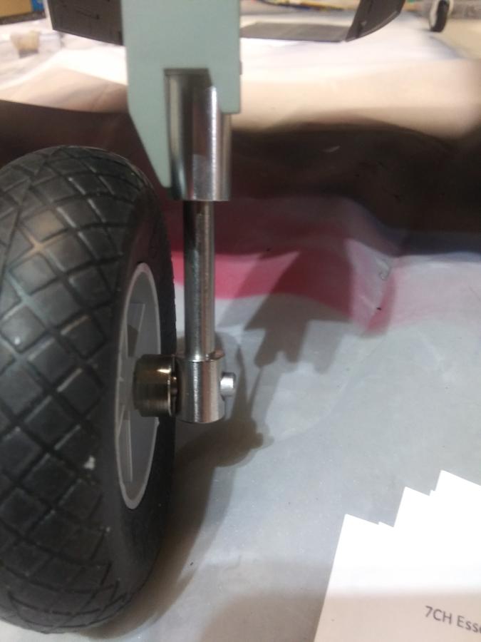

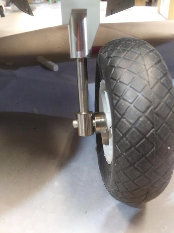

                                        So, I think mine just missed the mark, there were only four left when I ordered mine, then they were out of stock for a couple of days, oh well.
                                        So the Robarts arrived today and I tinkered around with them to get them to fit. I ended up using a prop/shaft adapter from the Pandoras and a lock collar in this order. Spacer, electricians tape to upsize the diameter of the axle pin, wheel fitted over the taped area, lock collar, then through the hole in the strut. Originally, I had the stock spacer after the wheel and before the collar but it looked like the wheel was too far from the strut so I removed it.
                                        Click image for larger version  Name:	20241127_194351.jpg Views:	0 Size:	40.5 KB ID:	414945 Click image for larger version  Name:	20241127_194404.jpg Views:	0 Size:	44.8 KB ID:	414946
                                        I successfully retracted the gear with the spacer still installed, but haven't tried it without, that'll wait 'til tomorrow. I like the looks of these tires better than the stock ones, just too bad the supplied axle adapters don't work.

                                          SanExup,
                                          I made some bushings for Davegee,Elbee and myself from brass rod, 1/4” turned down and bored to fit the Robart wheels and stock axle. I think Elbee did a complete new wheel for his though. If you need a pair of bushings PM me your address and I will send you a pair. Mine spin freely on the axles and no wobble
                                          ​​​​​​ Best Regards, Rex
                                          Hi Rex, do you happen to have any more of those bushings? I'd love to get a set, let me know.
                                          Thanks in advance! BTW, Happy Thanksgiving!
