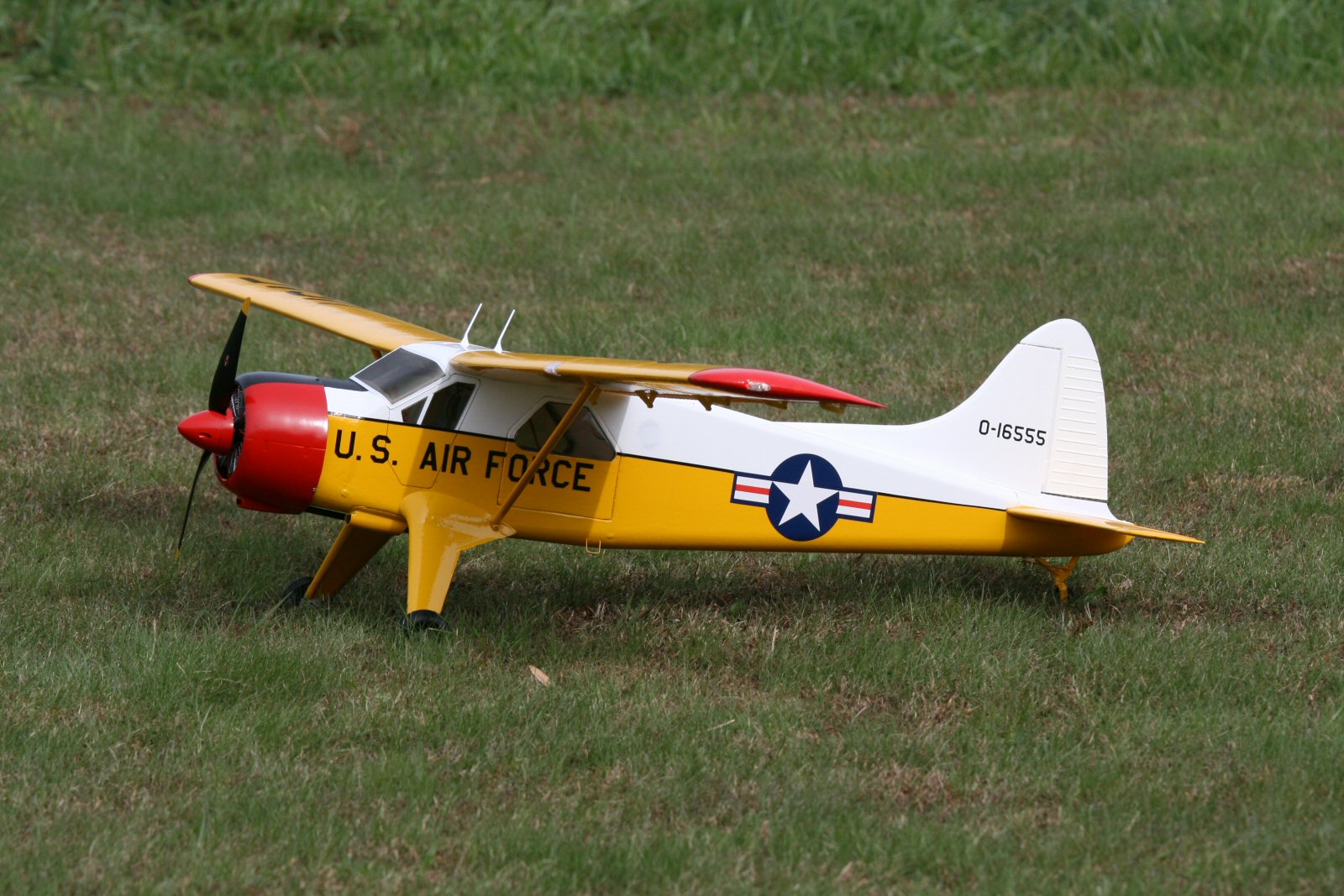

                                        Ah, the definitive sign of spring, I took the skis off the Beaver and put the wheels back on. Ready to fly another season.Click image for larger version
                                        • Crash Test
                                          • 4
                                          #80
                                          Did the same with mine. Off went the skis, on went the tires. Cmon spring!
                                          Love the paint job wvrailfan!!
