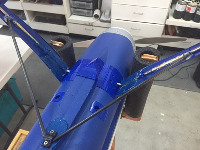

                        Put a few spacers on the wheel axle so wheels don't rub against the wheel wells. Also installed a 'V' support on the landing gear. Used CF rods and worked well. Picture coming of this.
                        This shows the "V" gear support. Not really necessary but I feel better having it. (perhaps my landings need some work?)

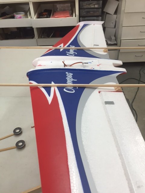

                        I'm looking into aileron trim needed for level flight. I think the wing tubes are a bit off but need to look further as the wings plug into the fuselage and perhaps a shim here or there will correct the problem. The sticks are not parallel indicating I have a wing that is not the same incidence as the other. I'll fix this tomorrow. As before, it's not too bad and the plane fly's decent as it, but I'd like to improve if possible.

                            Recall I lengthened my gear 1" (.7 vertical) as other posts indicated marginal height for 16" props. Doing so caused a slight back/forth movement on one gear. This more than likely due to the wheel rubbing on the wheel pant which I fixed with the spacer bit the addition of the 'V' carbon fiber secured the gear better and also fixed the issue. I do think the standard gear would be fine and this mod not necessary. I may get the original gear at some point but no rush to do so.

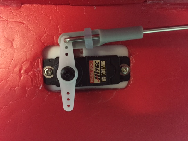

                              I have 8 flights on the plane at this time. I believe the servo gear slop to be excessive for precision flying - but fine for practicing. I have just replaced the rudder servo with a Futaba S3102 which has zero gear slop. I am hoping this eliminates yaw effects I was seeing in flight. I also reduced the right thrust a bit (perhaps by 1/2 normal) - which leaves right thrust, just not as much - as I was noticing heading issues in different maneuvers (could have been the rudder servo gear slop?). I plan to change out the elevator servo and aileron servos as soon as I find a good replacement. I need to eliminate subtle hunting in level flight and get the wings to 'lock on'. Should know in the next days if this worked.

                                        - suppose I'm getting old - of course, "new reply" and you can insert pictures. The hitech servo is MUCH better than the $10 FMS servos that come with the plane - but the FMS servos are "OK" for the price of the plane and surely allow the plane to fly decent. I'm just looking for the little-bit-extra so I can see how well I can make the plane fly.

                                          Are the FMS servos digital? The high refresh rate of the digital amplifier can make up for a lot of "slop" in the gears. Now if the dead band is set too wide well then there isn't anything to be gained.
