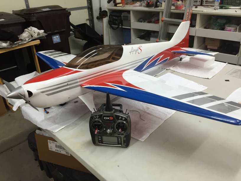

                      After flying the Olympus for about 15 flights over weeks of time due to weather related conditions (I would have liked to fly it every day for a week to get use to it!) I decided to build another plane to compare the two. It's the same size and using the same Motor, ESC and battery (5S, 5000mah) as the Olympus; it's an Angel Shadow. It actually has more wing area and is a bit larger, but the same "class" as the Olympus. This plane is a balsa built-up model covered with Monokote type iron-on material;, could be Coverite or similar? The model came covered and I had to add servos, ESC and Motor. I've made a few modifications to the elevator which I hope will improve tracking - but time will tell. I think the Olympus is a fine plane perhaps into Advanced - if no wind is present at contests. The rudder is very sensitive and as I use the rudder every 5 seconds during a flight, its taking me some getting use to so I prevent yaw on a continual basis.
                      I'll report back in a few weeks when I get a chance to fly the AS - but for now, snow moving in with 12-18" expected in the next days - so I sit and wait! Well, I can now clean up the garage after building this plane.
                      Scott

                          The AS came in at 96oz (6lb on the dot), using DS821 servos all around (1.5oz each - ouch). The Olympus comes in at 90oz (5lb 10oz). I'm using the Olympus motor and ESC (70A) and pull 56A at 1050W which should pull the AS around nicely. This is with the 5S, 5000mah Zippy compact battery. If I used the Hitech servos I put in the Olympus, I'd save 3oz as they are .75oz as I recall. The JR's center much better than the Hitech's for less money and have 70oz-in torque (again as I recall). No flying for a while as we have 12" of snow outside (came in last night) so I get some simulator practice for a few days.

                            I'm eager to read your flight report on the Angel Shadow. Russian, right?
                              ​My original 2M plane shown in my Avatar was made in Russia (a full composite model of amazing quality) by Vladimir and shipped into San Francisco where I picked it up. This smaller model is by Sebart and I got it thru the US distributor in Las Vegas, NV. I am quite anxious to fly it as many have reported it fly's very well. I will post after the first day of flying but it won't be for a few weeks I'm afraid as we still have a fair amount of snow on the roads and I'm sure the field is packed.
