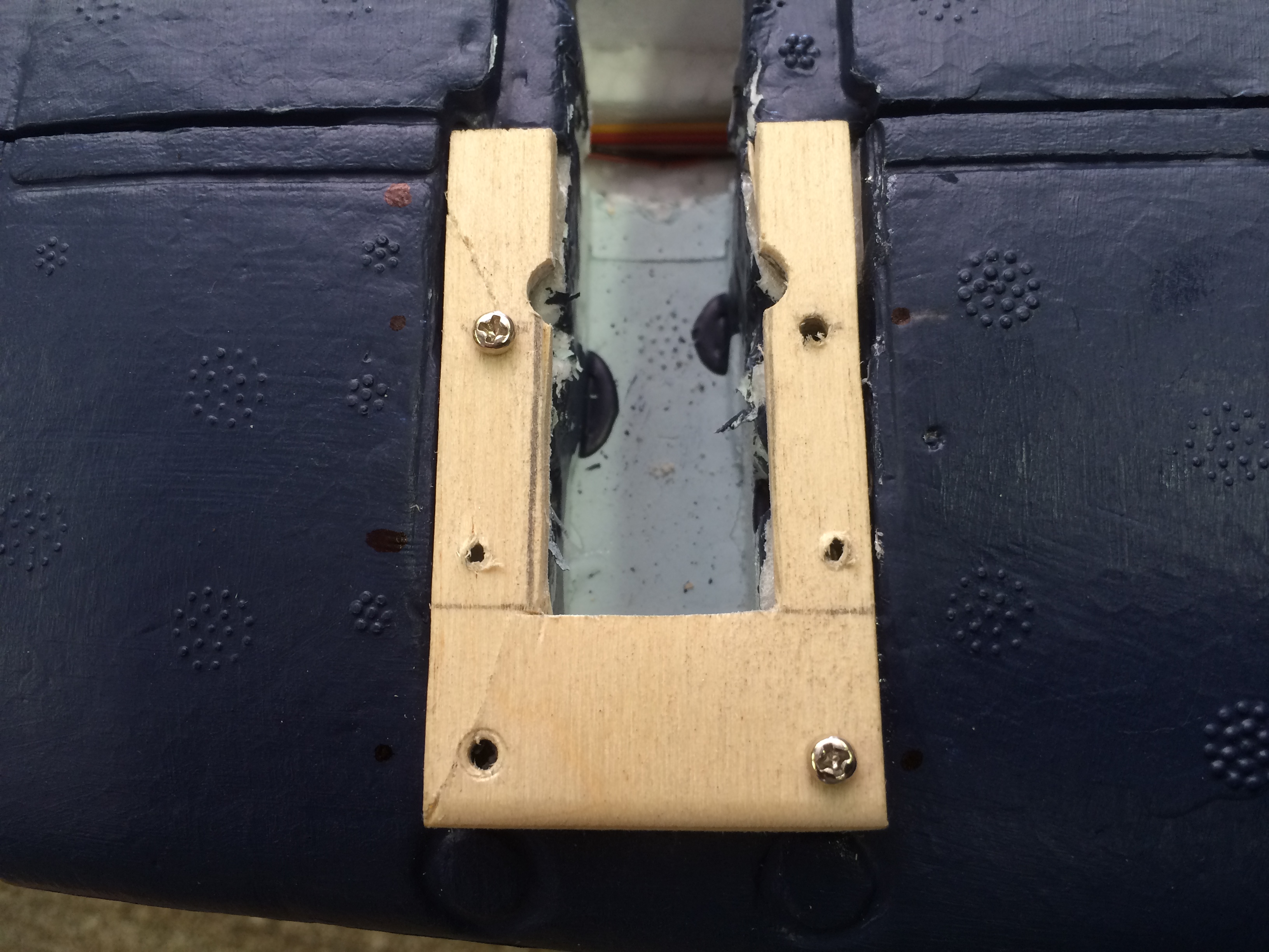

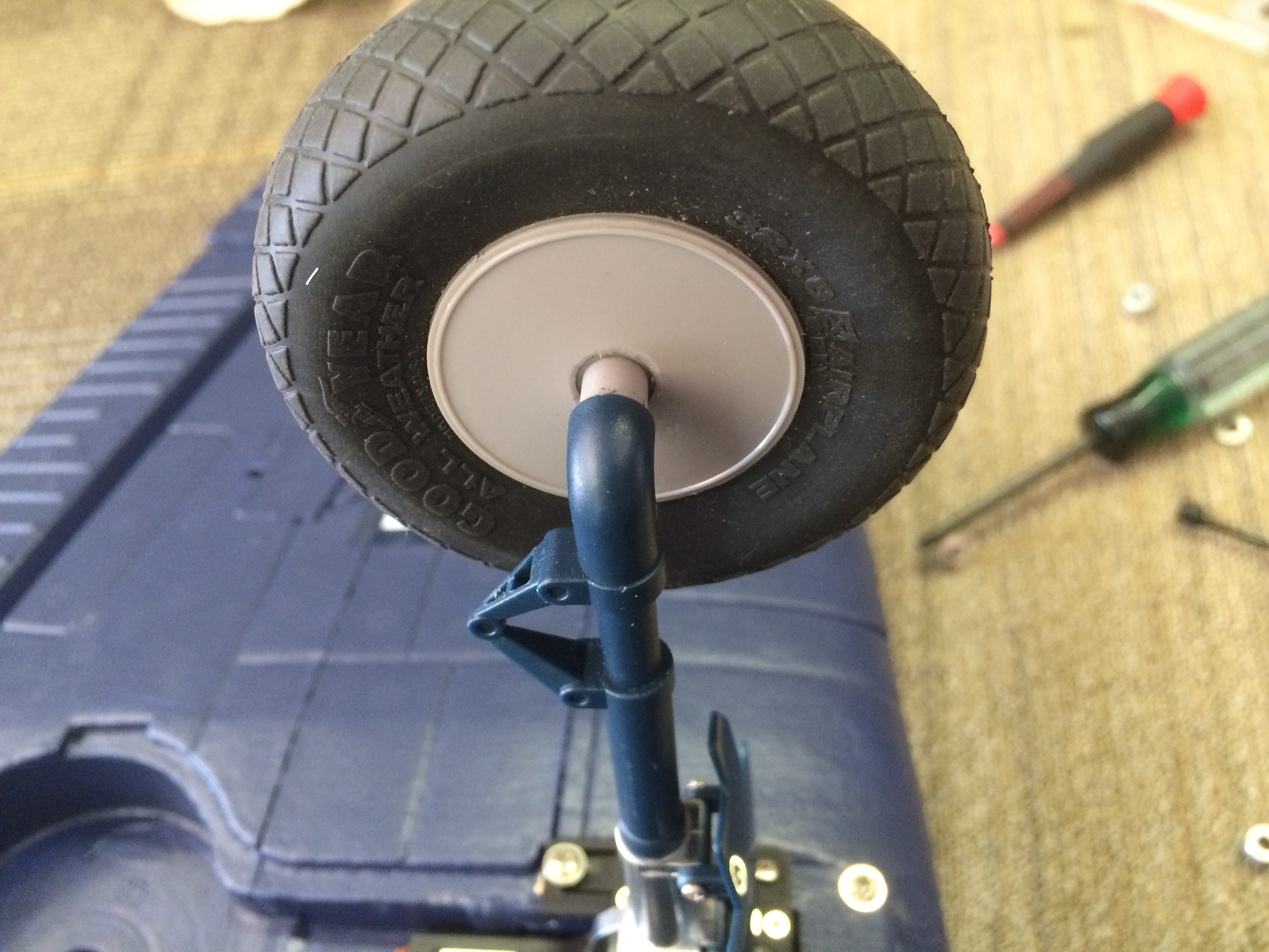

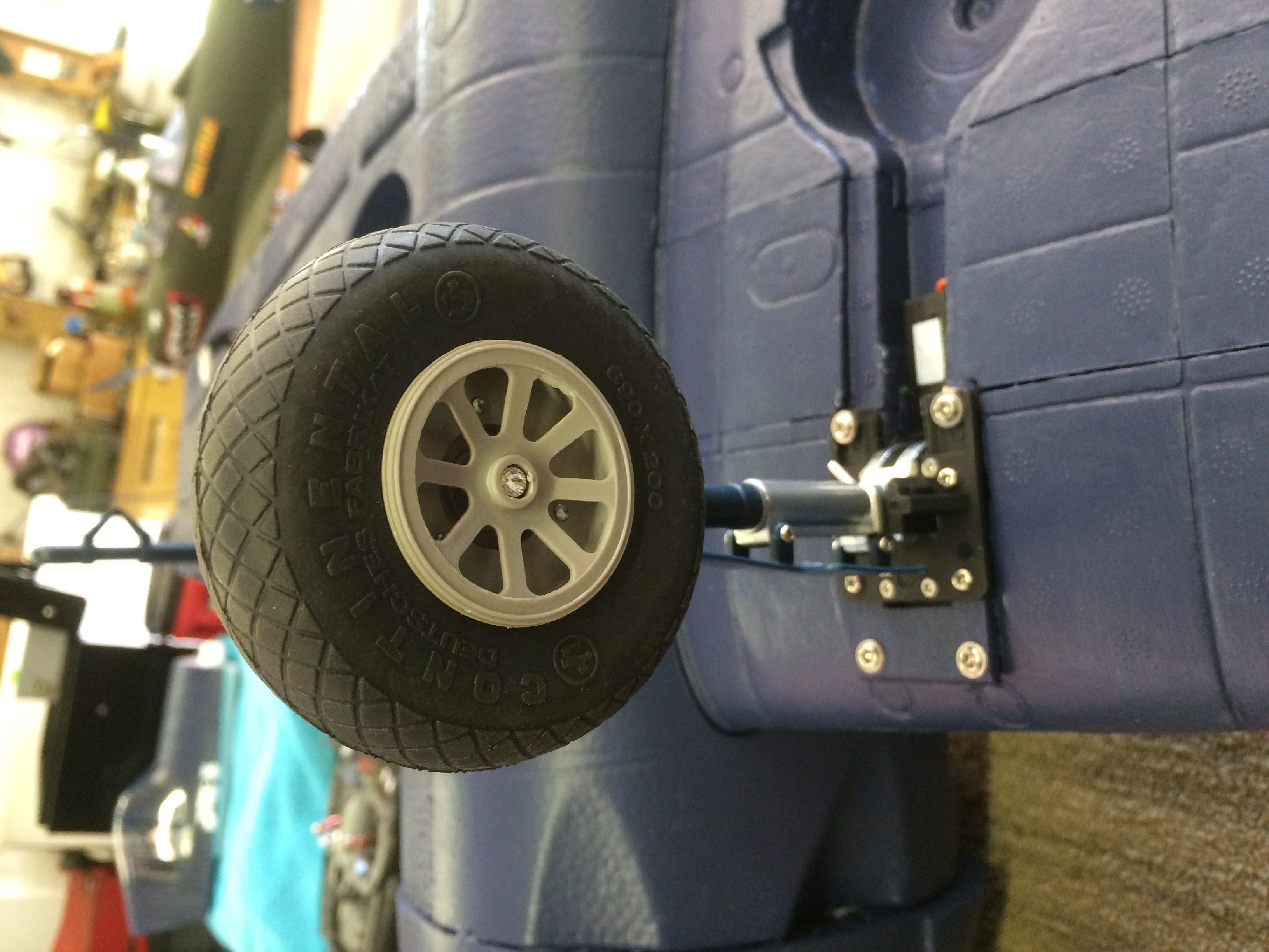

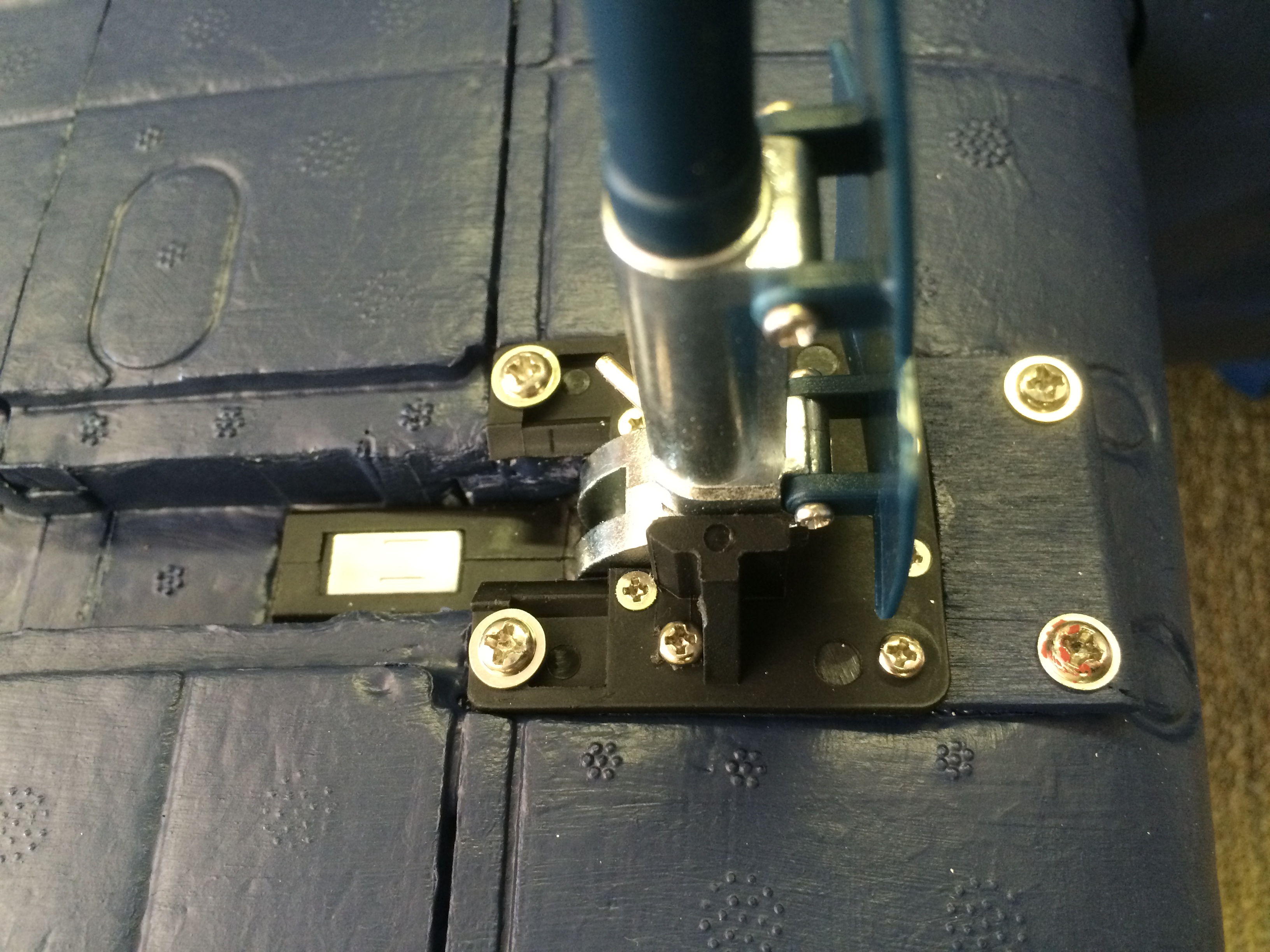

                              • Yes, the struts are shorter so I had to relocate the retracts but they work great.

                                • The retracts look good. They are a great option. I really like the wheels and tires what are they?
                                  • Originally posted by farmflyer View Post
                                    Robarts....
                                    • Thanks! I may have to check into those.
                                      • I've got about a dozen flights on the new Eflight retracts and they have performed flawlessly, these are very high quality and have zero play in them...they even have a quality sound to them. You saw that I had to relocate the retract position, I was concerned it would change COG but it didn't seem to change enough to make a difference.
                                        I measured the Dynam Corsair and these should be a direct bolt in on it.
