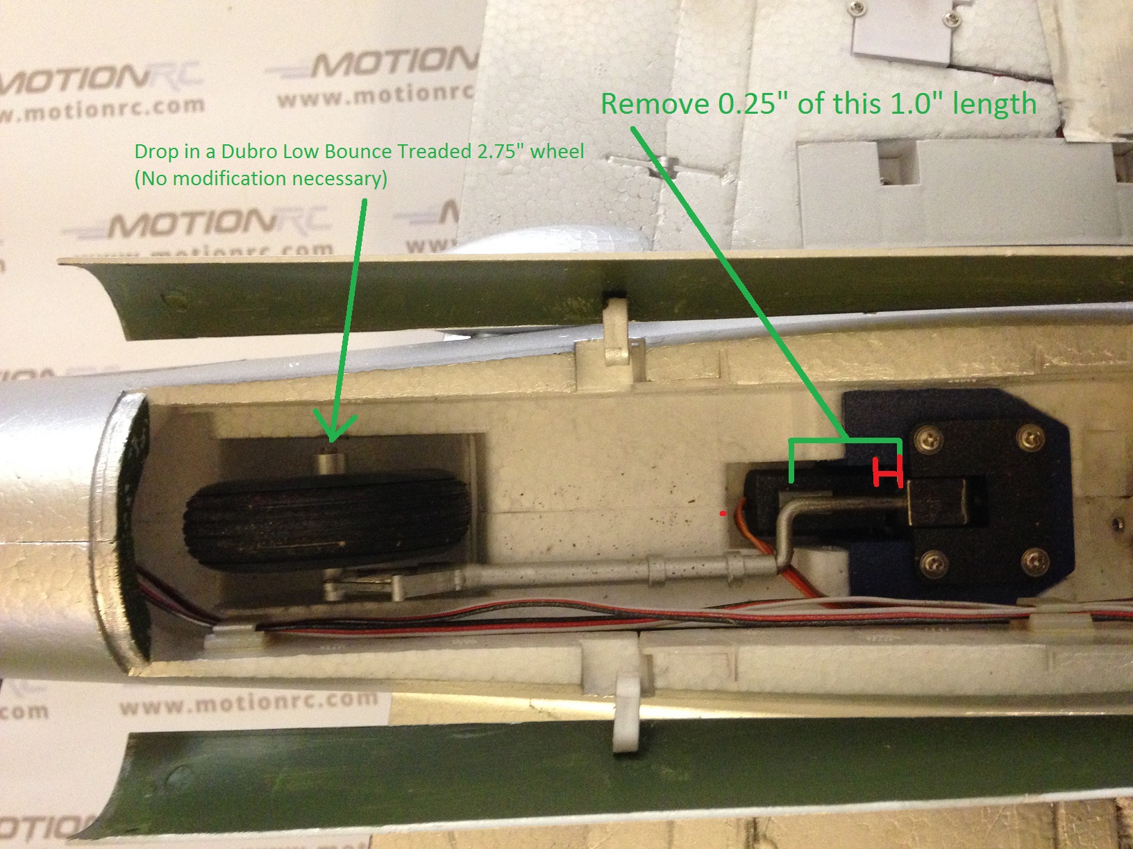

          Hi Mr.Frankenjet, we expect the same quality silver on the production model. As stated in the product description and elsewhere, the photos shown are of a pre-production model which I painted as a color sample for the factory.
          Regarding your question about the main gear, it's a good question. I would emphasize that the stock wheel height and geometry has worked great on pavement and 1" grass over the 200 test flights we've conducted, so changing wheels is by no means necessary to enjoying the aircraft for a long time. Nevertheless, here is some data on the topic of wheels, and a Tutorial detailing the simple process to safely increase the P-38's main wheel height:
          Stock Wheel Measurements
          Main Wheel: 20mm wide, 65mm tall,
          Main Wheel Axle: 4mm axle diameter, ~33mm of total width (20mm of which is the wheel, 10mm of which is the collar, and 2mm of which is extra)
          Nose Wheel: 12mm wide, 60mm tall
          Nose Strut’s Axle: 4mm wide, 24mm of total width (12mm of which is the wheel, 10mm of which is the collar, and 2mm of which is extra)
          Main Wheel Height Modification Tutorial
          The more parts a model uses which are also used by other models (called “common parts”) the lower the unit cost of those parts and thus the lower cost of the models themselves. These cost saving considerations are important to meeting target price points, and also simplify inventory and parts replacement. Servos, ESCs, linkages, retract units, and wheels are frequently standardized across several models, within reason.
          The P-38 uses a 2.5” tall main wheel which the manufacturer has on hand for other aircraft and was the closest fit for the P-38’s size. To be more perfectly scale in height, a main wheel 3.59” tall and 1.2” wide would be 100% accurate. Unfortunately, a 3.5” wheel won’t fit in the existing bay because of the carbon rod which runs along the spine of the boom right at that spot. Removing that rod was not a possibility, since the rod is essential to the airframe’s rigidity.  Because the cost to mold new unique sized wheels was ruled out, instead we did the next best thing, which was to design the main struts to easily accept a larger aftermarket 2.75” wheel for those select pilots wanting to further accurize their P-38. Here are the simple steps to perform this modification in about five minutes. The attached photo summarizes this mod even more clearly.
          Analyze:
          1) Increasing from a 2.5” wheel to a 2.75” wheel requires a 0.25” reduction in the height of the steel wire strut, so that the wheel fits in the bay and the aircraft’s ground posture remains the same.
          2) The existing main strut wire exits the trunnion for 1.0” before the first 90 degree bend.
          3) The existing main strut wire’s diameter is 4mm.
          4) The existing main wheel is 20mm wide, with 33mm of available axle width (allow for the 10mm wheel collar width in your calculations for maximum width of an aftermarket wheel).
          Materials:
          1) Dubro Low Bounce Treaded Wheel 2.75” with 4mm hub diameter, pair.
          2) 1.5mm Allen wrench
          3) 2.0mm Allen wrench
          4) Rotary hand tool (Dremel, etc.) or a fine hack saw
          Action:
          1) Remove the retract from the retract bay.
          2) Use the 2.0m Allen wrench to loosen the grub screw on either side of the retract wall (standard strut pin removal procedure)
          3) Pull the strut wire out of the retract’s trunnion
          4) Use the 1.5mm Allen wrench to remove the wheel collar.
          5) Slide the stock wheel off the 4mm axle.
          6) Cut down the base of the strut wire by 0.25” with your rotary tool or saw.
          7) Slide the new wheel onto the 4mm axle.
          8) Reinstall the wheel collar.
          9) Reinstall the strut into the retract trunnion.
          10) Reinstall the retract into the retract bay.
          Result:
          1) 2.75” Main wheel installation complete.
          Bonus Option:
          1) Replace the stock nose wheel with one of the stock main wheels (No modification necessary)
          2) The result would be 2.56” Nose wheel and 2.75” Main wheel, with slightly more nose up AoA
          For pilots wanting an even larger main wheel, a Dubro Treaded Lightweight Wheel 3” (2 Pack) can be installed using the same process above, except modelers will need to shorten the main strut wire by 0.5” instead of 0.25”, and they will also need to slightly deepen the wheel bay’s contour to accept the taller wheel. A Dremel with a low grit sanding attachment can accomplish this in seconds. Raking the main strut slightly forward by shimming under the retract is an option also. There is 12mm of clearance between the stock main wheel and the main gear door. This 3” wheel would be the closest to scale visually, but [DISCLAIMER] officially we do not recommend this due to the mods required to get the geometry correct without compromising the boom’s spinal spar. In any modification, the geometry of the struts, their clearances in the wheel well, and the resulting ground stance are key considerations. Do not significantly alter the AoA of the nose, neither up for down, from the current stock angle.
          Nose Wheel Height Modification
          The stock nose wheel is 60mm tall and the 90 degree actuating retract unit is mounted at a slight angle so the nose strut sits ~100 degrees forward relative to the ground. This is the best compromise to fit the nose wheel inside the nacelle under the battery bay, and without having to design an all new 105 degree actuating retract to match the full size P-38’s nose strut angle. Pilots wanting to increase the forward rake angle can add washers under the aft side of the nose retract, but ensure that the nose wheel still clears the nose door (and paying attention to strut length so as not to lower the AoA). For a simpler mod, replacing the stock nose wheel with a stock main wheel (65mm) is possible without any modification.

            Outstanding information Alpha! Very useful for those who wish to implement this mod.
              Analyze:
              Materials:
              Action:
              Result:
              Bonus Option:
              Fantastic detailed info, glad there is some wiggle room to mess with it a little. It's on the to do list :D
              Thanks

                Agreed, excellent tutorial! I'll be ordering some wheels, when I put in my battery order...
