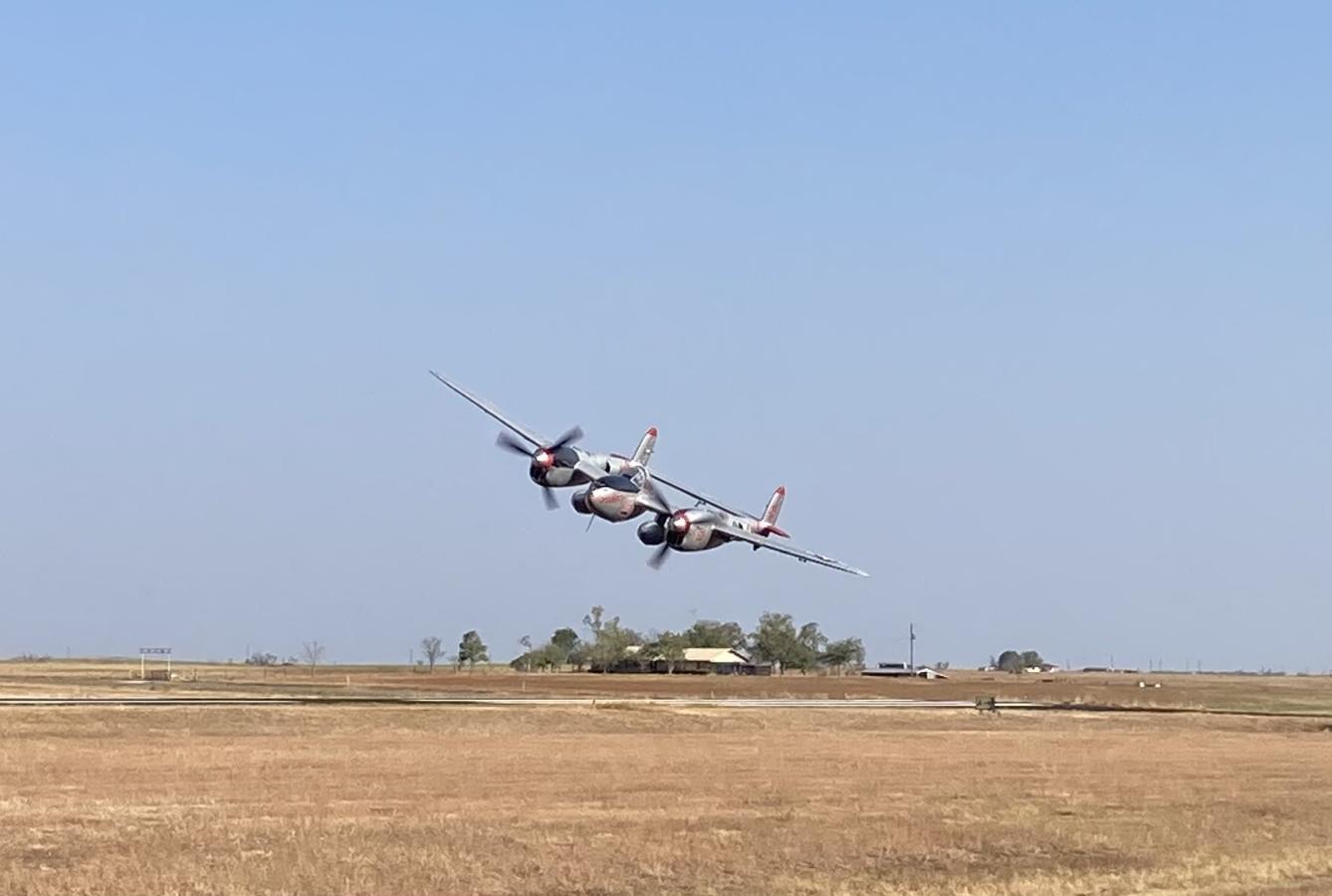

    Great pic GG
  • GliderGuy
ID:	385659 Low pass….shades of WW2!
    -GG
