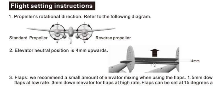

    Click image for larger version  Name:	IMG_3522.jpg Views:	0 Size:	44.2 KB ID:	428695 The set-up manual shows 4 mm of up elevator setting with neutral stick and with book CG (see excerpt screen capture).
    Also, she pitches up when flaps are lowered, so per the book…mix in a bit of down elevator as the flaps are lowered…flaps = master, Elevator = slave
    If the mechanical 4 mm up elevator isn’t set, you’ll have your hands full keeping the nose up on the maiden. Book CG is fine for starters.
    -GG
    Just wondering if the elevator was level when the trim was neutral, it might be a case of improper setup...
    Doesn't take much down elevator to throw things off.
    (Dangerous Dan)
    I think the problem with the book CG is the reference point for the 65mm. In the end book CG is a starting point. Move to suit.
