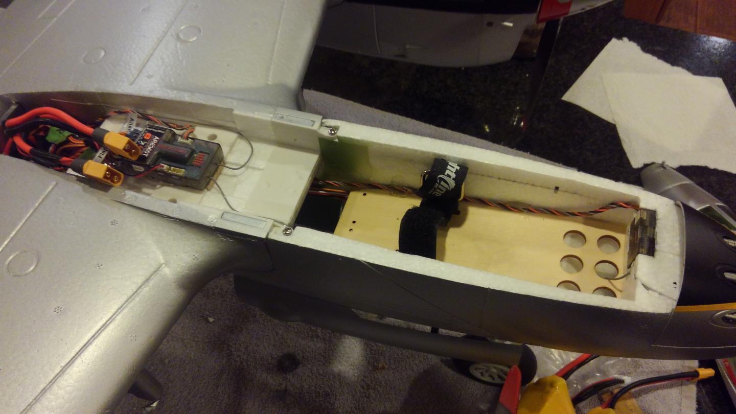

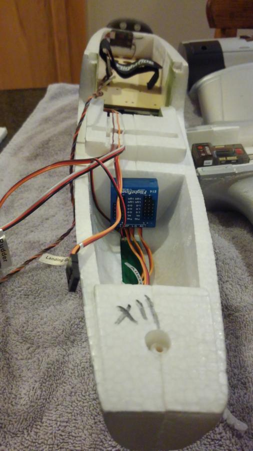

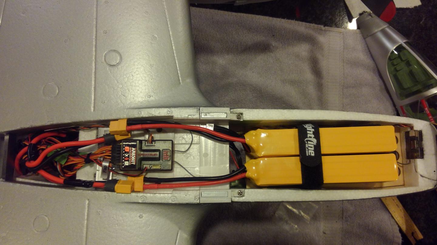

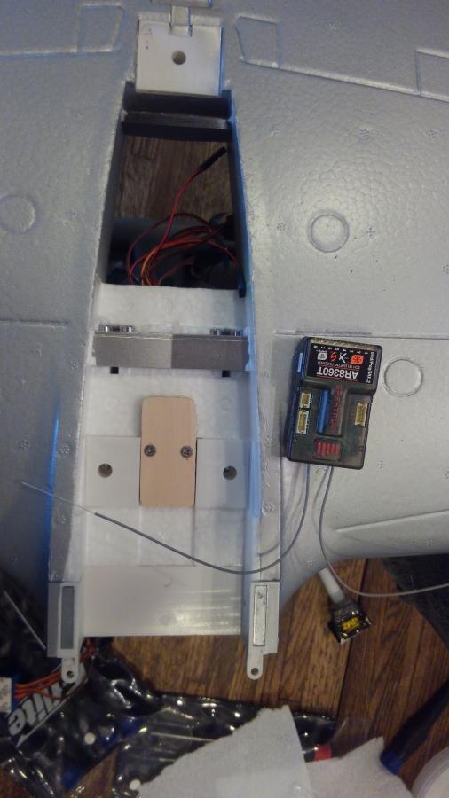

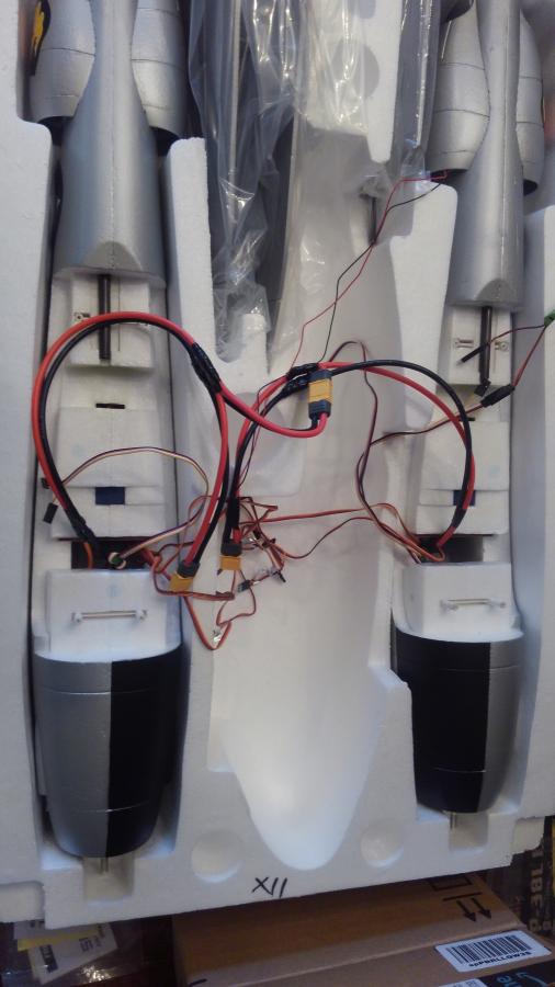

    Went with the stock sized Robarts and the suspension struts. Had to do some customizing on the axles and what not, but they worked okay. I also changed out the esc's with a pair that I can reverse the thrust with. I think I'll appreciate the ability to stop this plane. Wiring this plane is a fun challenge. Here's some pictures of how I approached it. The battery leads are also connected together with an XT 60 connector that I soldered between the leads.
