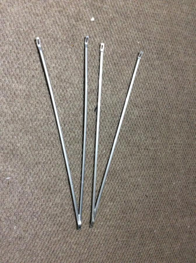

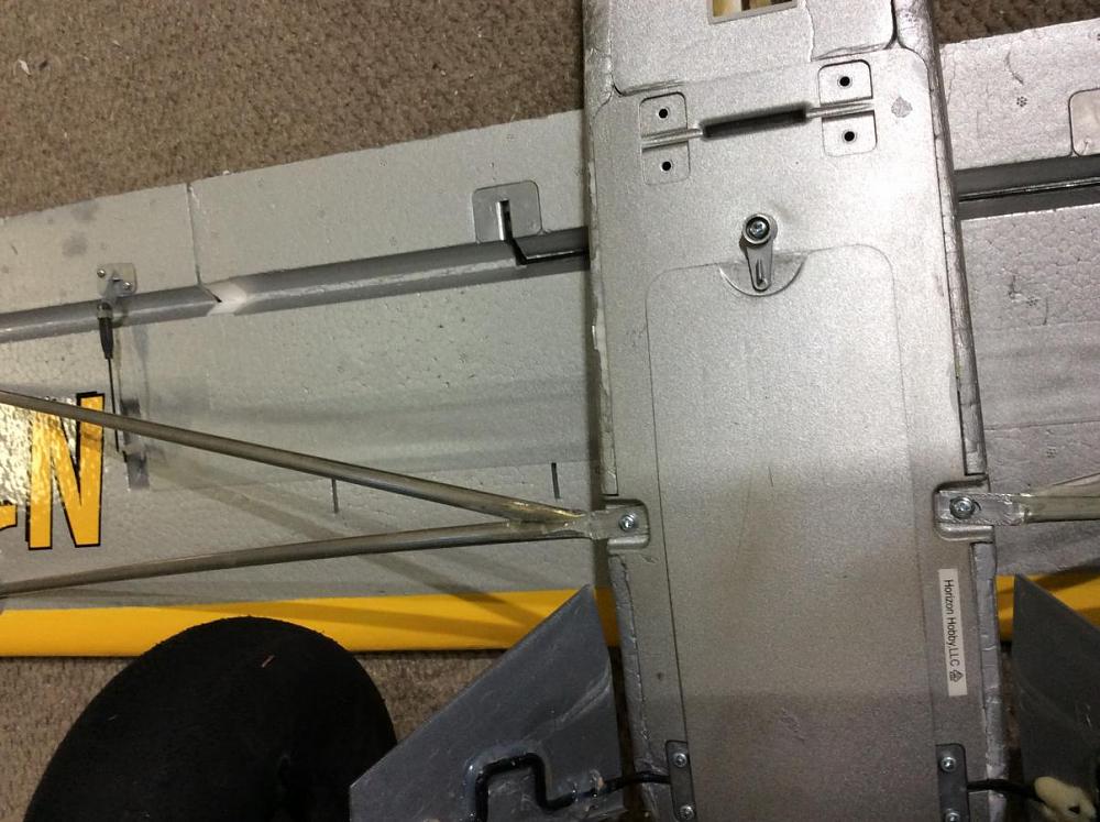

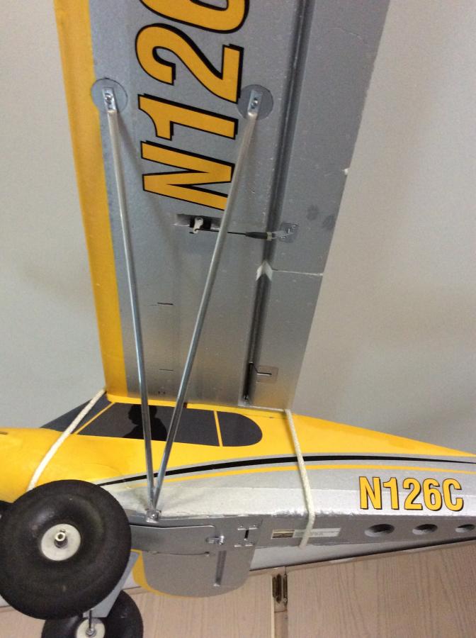

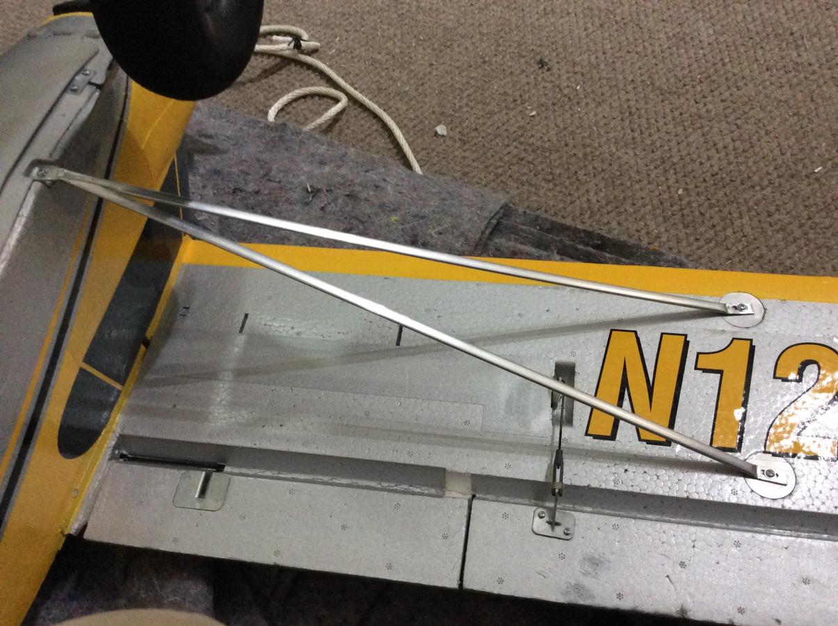

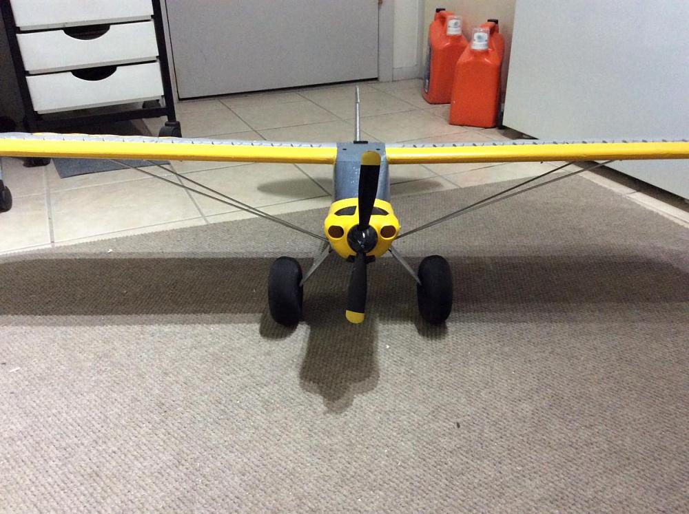

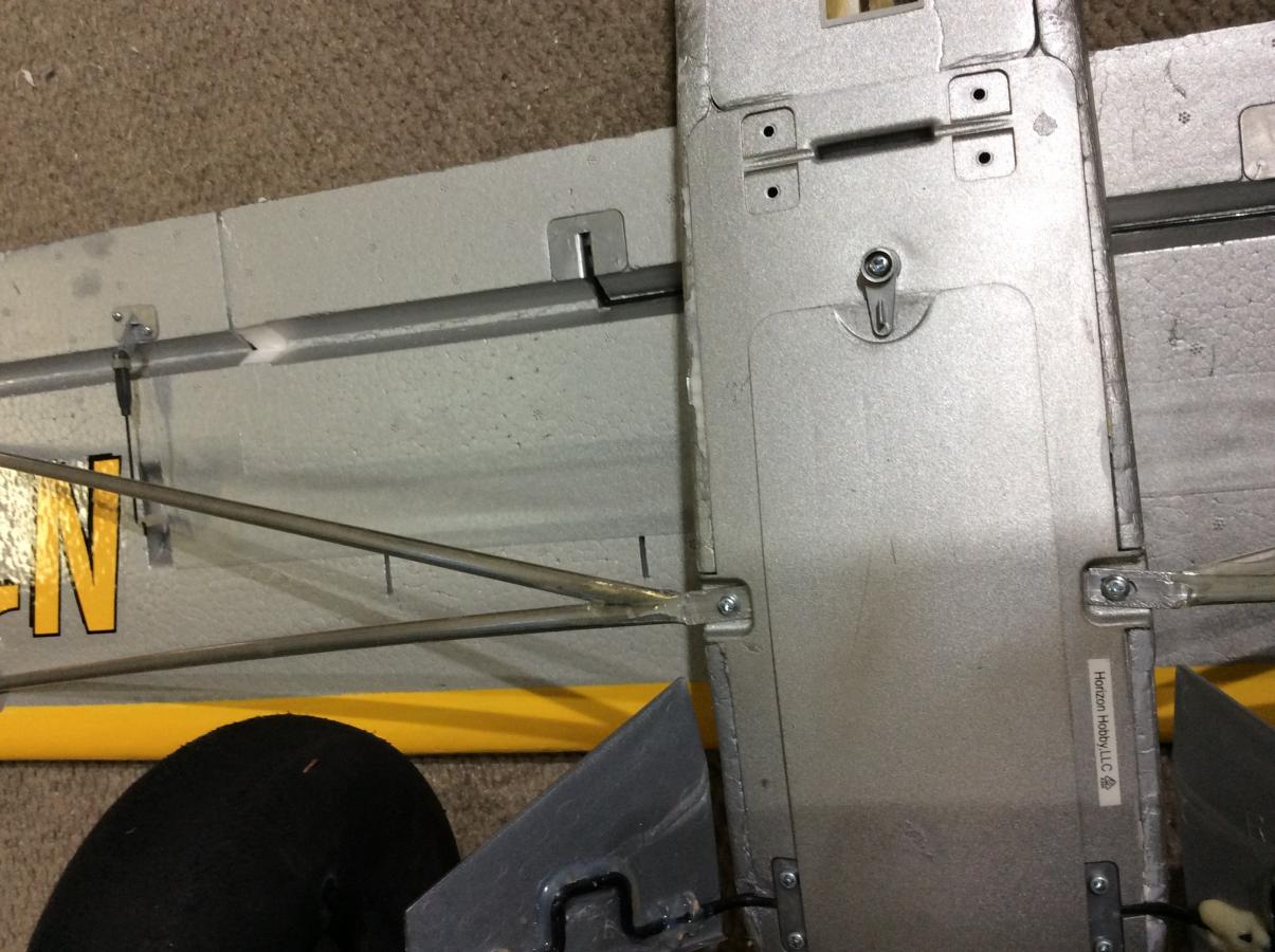

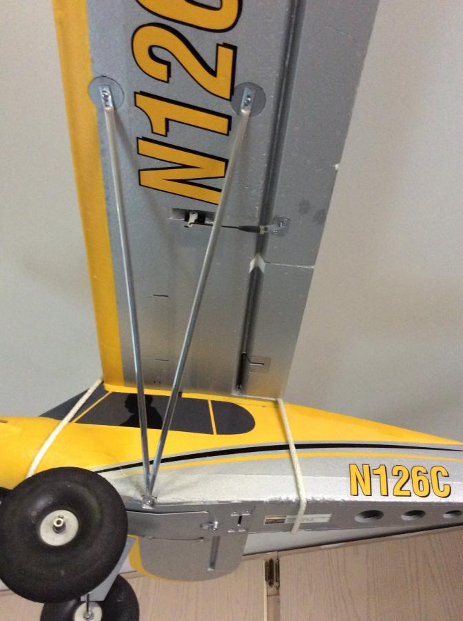

ID:	203049In the first picture, one strut is plastic original and one is aluminum- available at LHS. Cut with Drexel and epoxy assembly.
      This makes better sense and weigh some about the same. Click image for larger version

          You mention. LHS, I presume that's a US based company, am I correct? I am in Australia and would like to get a pair like these. The plastic ones are useless.

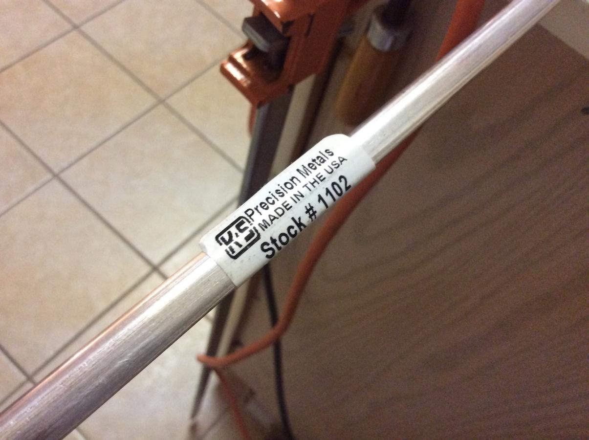

                    Can I have the link to the aluminium wing struts. I can't find it anywhere.

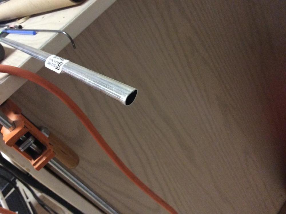

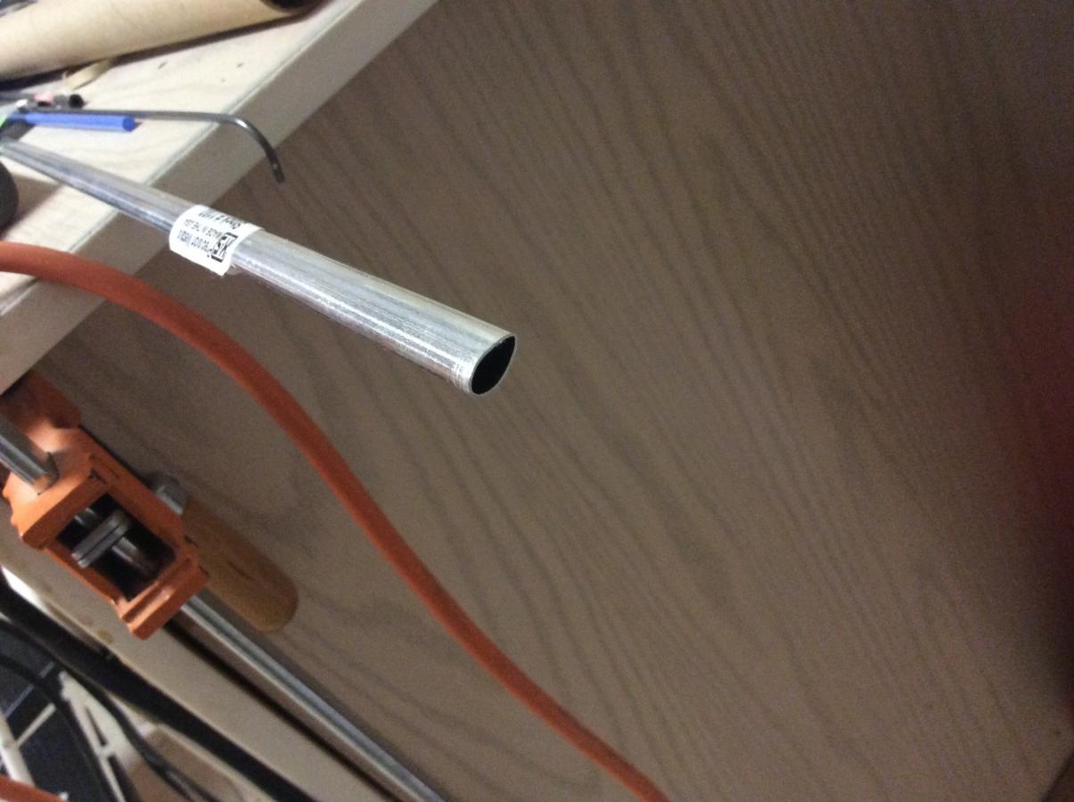

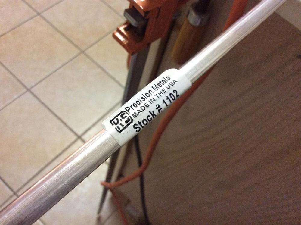

                      Click image for larger version  Name:	image.jpg Views:	0 Size:	98.6 KB ID:	208961Click image for larger version  Name:	image.jpg Views:	0 Size:	103.4 KB ID:	208962Click image for larger version  Name:	DDCF3083-4CA5-4AEB-942F-A368C806820C.jpeg Views:	0 Size:	75.7 KB ID:	208963
                      You have to make them...you can buy 3’ lengths at your hobby shop. The pictures show a length of extrusion which is the next size up, that I used for a different project - so don’t order that size. For the joint at the fuselage you can cut it with a razor saw (Dremel diamond wheel works best) and then use a file to round the inside so that it wraps into the forward strut. Use a little #400 grit sandpaper to roughen the metal at the joint, clean with alcohol and then epoxy. The ends are crimped in the vise or with pliers, then drill holes. For added strength you can fill the ends with epoxy and then crimp and clamp. Once dry, drill your holes and round the corners if you like a finished look and then rub it down with some steel wool or prime and paint.

                        Ah!! Now I see how you connected the fuselage side joint. Did you keep the strut hollow inside? Or did you flatten it end to end?

                          Ends are crimped flat so they can be easily drilled. As I said you can fill the end before you crimp, with epoxy - then crimp and let cure before drilling

                                        They are also round - wings struts are not round, they are airfoil shaped to reduce drag.
