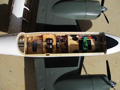

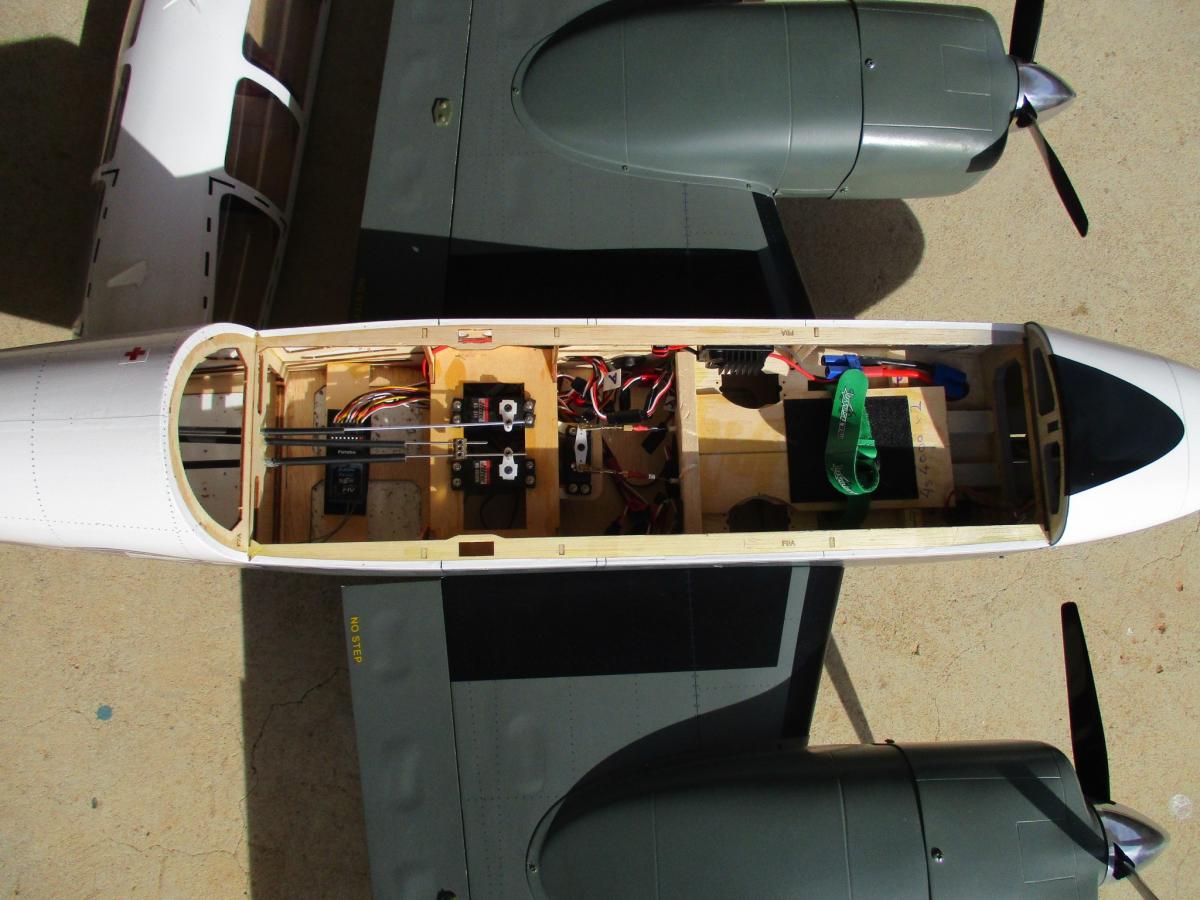

                  Click image for larger version  Name:	image_44561.jpg Views:	4 Size:	118.9 KB ID:	211533Click image for larger version  Name:	Beechcraft Baron T-42 Cochise US Army 04.JPG Views:	0 Size:	144.2 KB ID:	211522
                  The Baron would weight at 4300g empty :) no electrics motors etc , RTF it would weight over 5kgs.i used 13x8x3 blade props and that would mow the grass as it took off, then changed down to the 12x8x3 which was better this was using the dualsky motors and 4s4000 battery.
                  first Picture shows where the batteries where placed for balance and the 13 inch prop clearance on fuse.
