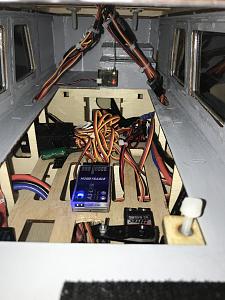

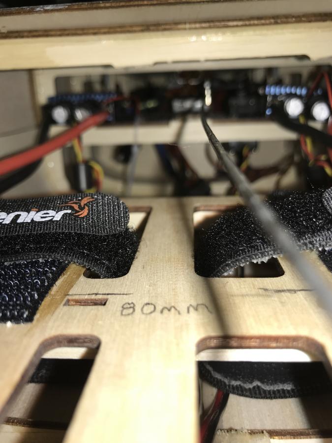

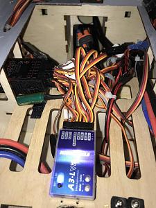

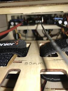

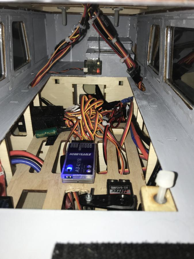

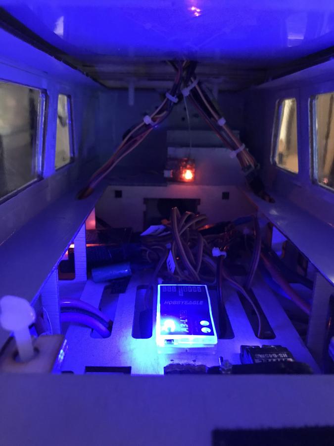

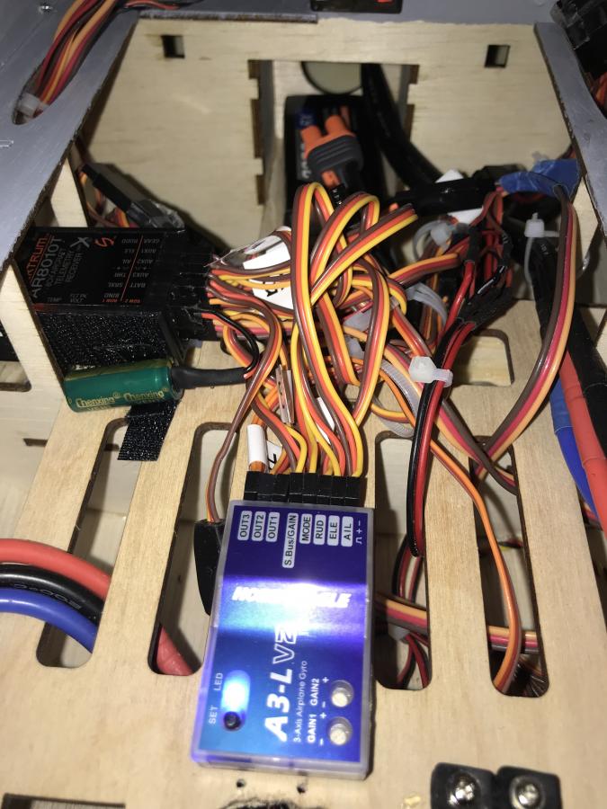

ID:	282741Click image for larger version
ID:	282742Click image for larger version
ID:	282743Click image for larger version
ID:	282744IMG_3324.JPGIMG_3332.JPGIMG_3329.JPGIMG_3330.JPG The oddball nose gear steering servo placement is the only real detractive on this aircraft as the servo is mid-center fuselage under the cockpit floor. This requires a long control rod forward into the motor mount for the nose wheel which is prone to bending and prevents full movement due to the odd angle when full right input is required. Additionally the long nose wheel steering control rod is in competition for space of the tandem flight batteries. I am able to place the batteries in the forward bay but they must be placed as far rearward as possible to achieve the appropriate COG. The batteries are angled together towards aft and can't go back any further as they hit my ESC's mounted on flat on each side of the electronics bay tray. This is not optimal but it all works for access and COG.
