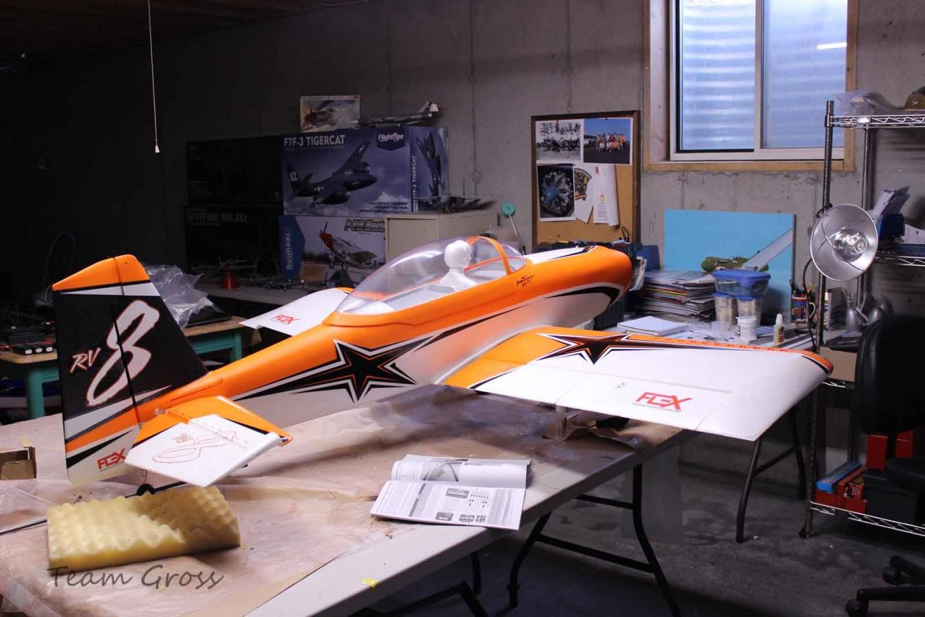

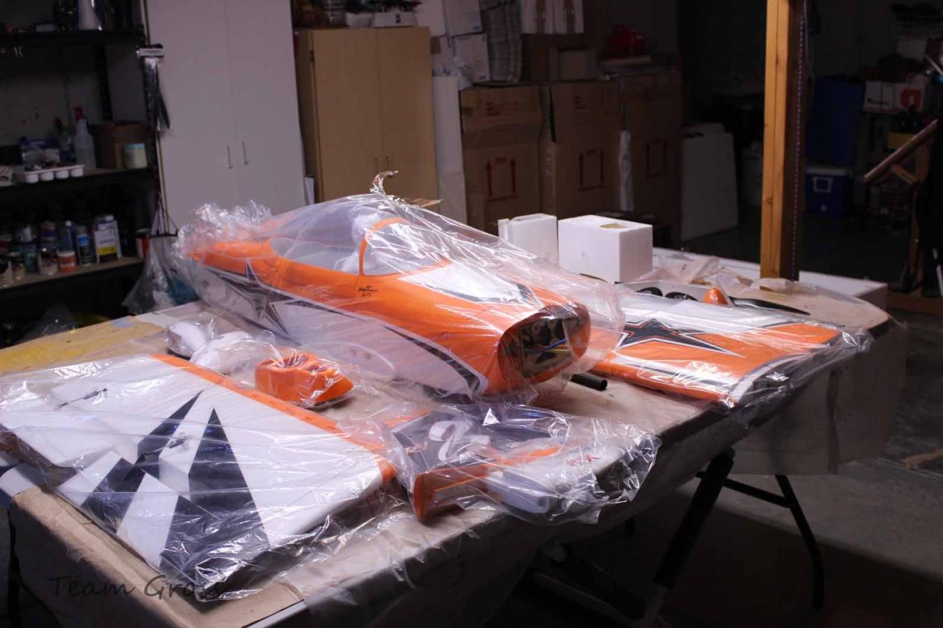

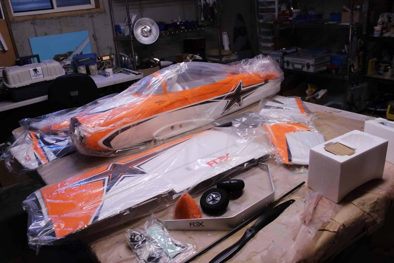

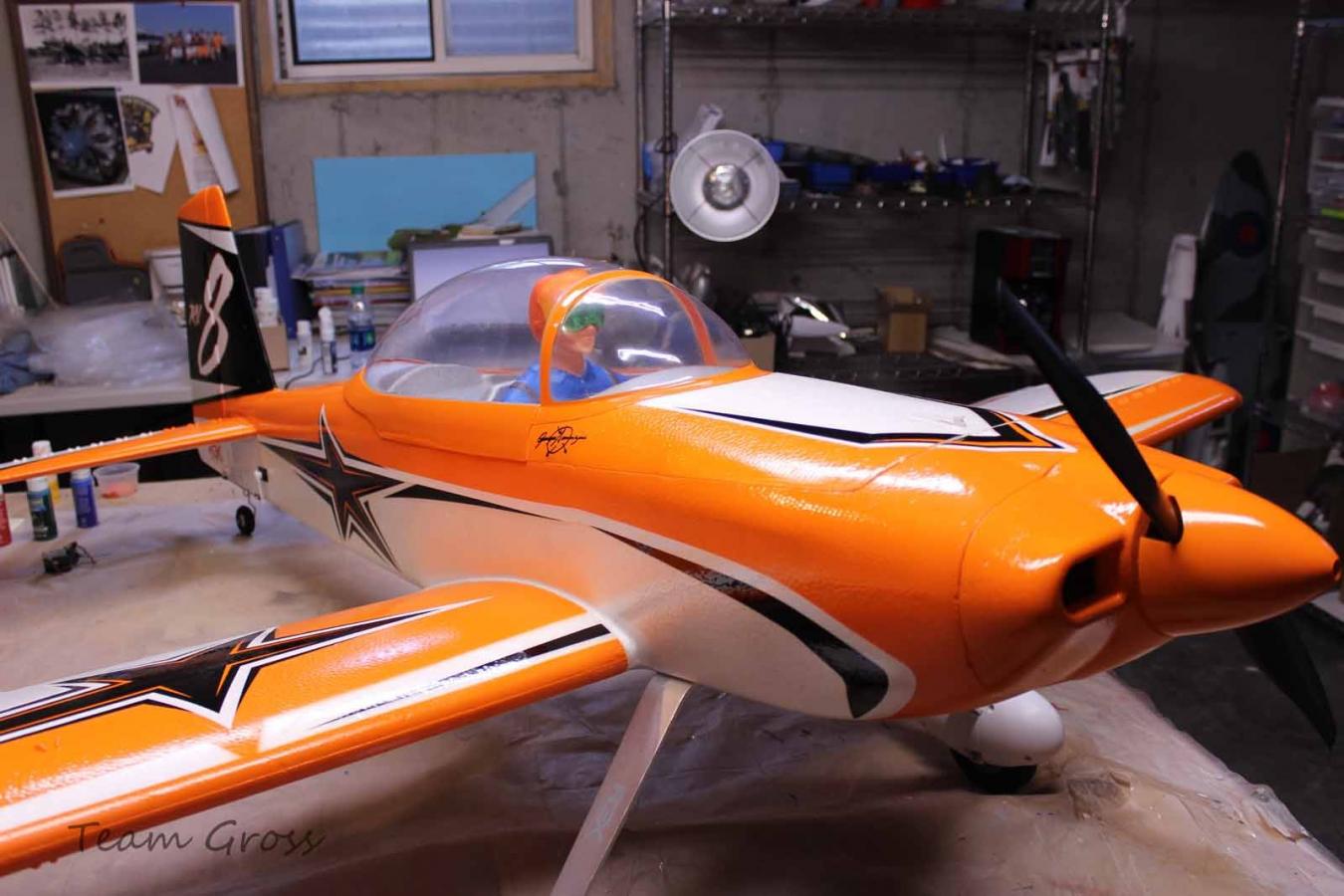

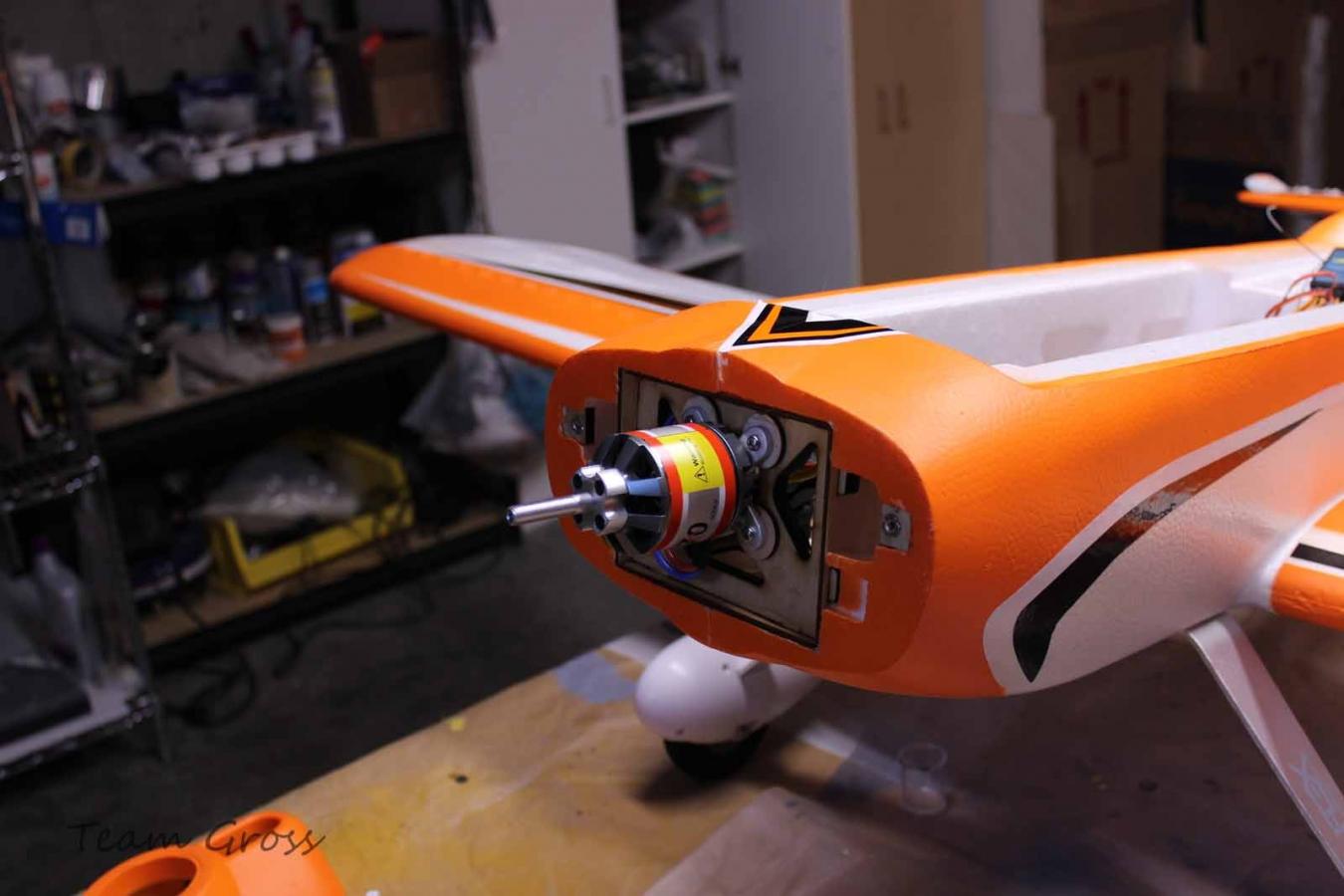

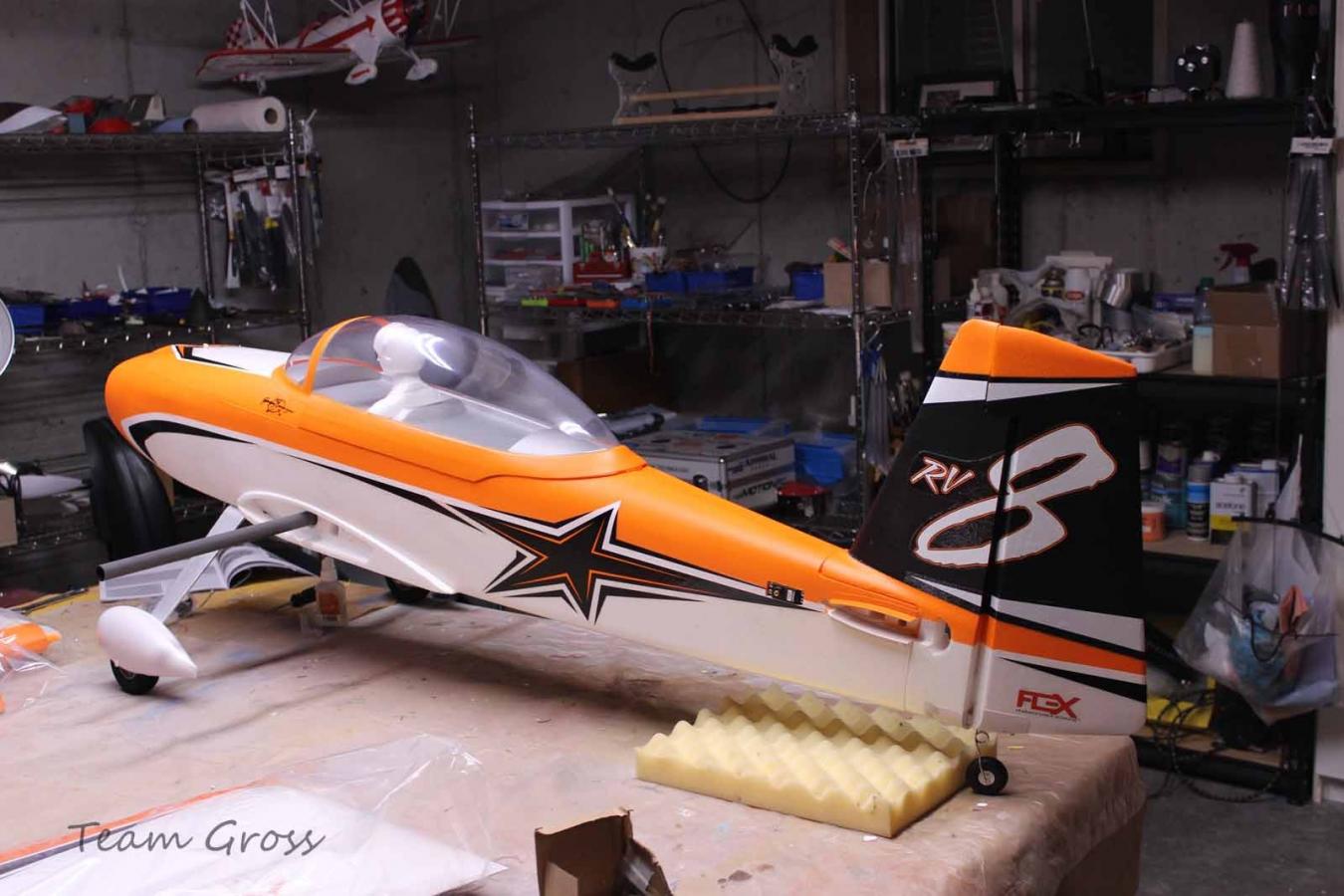

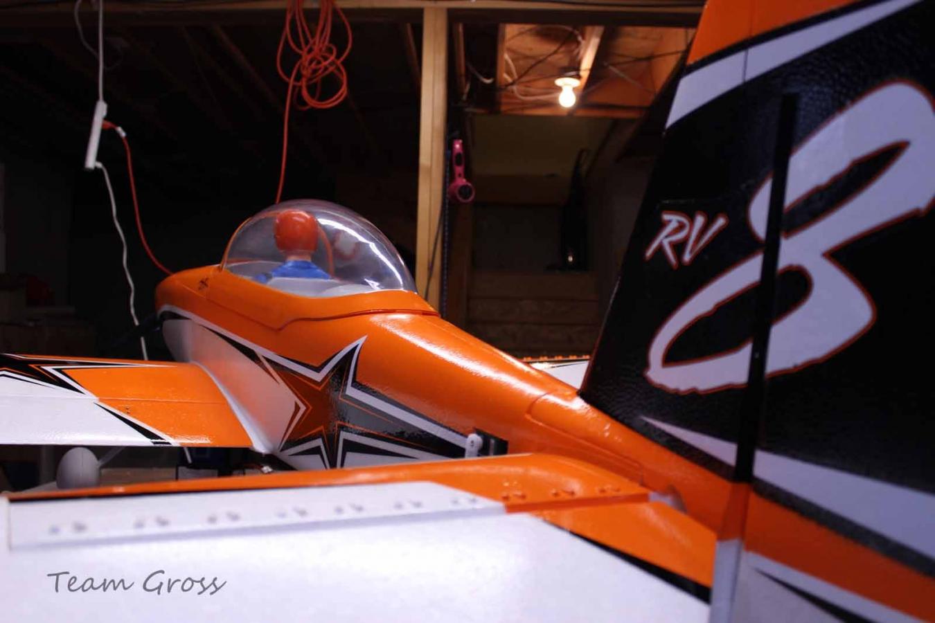

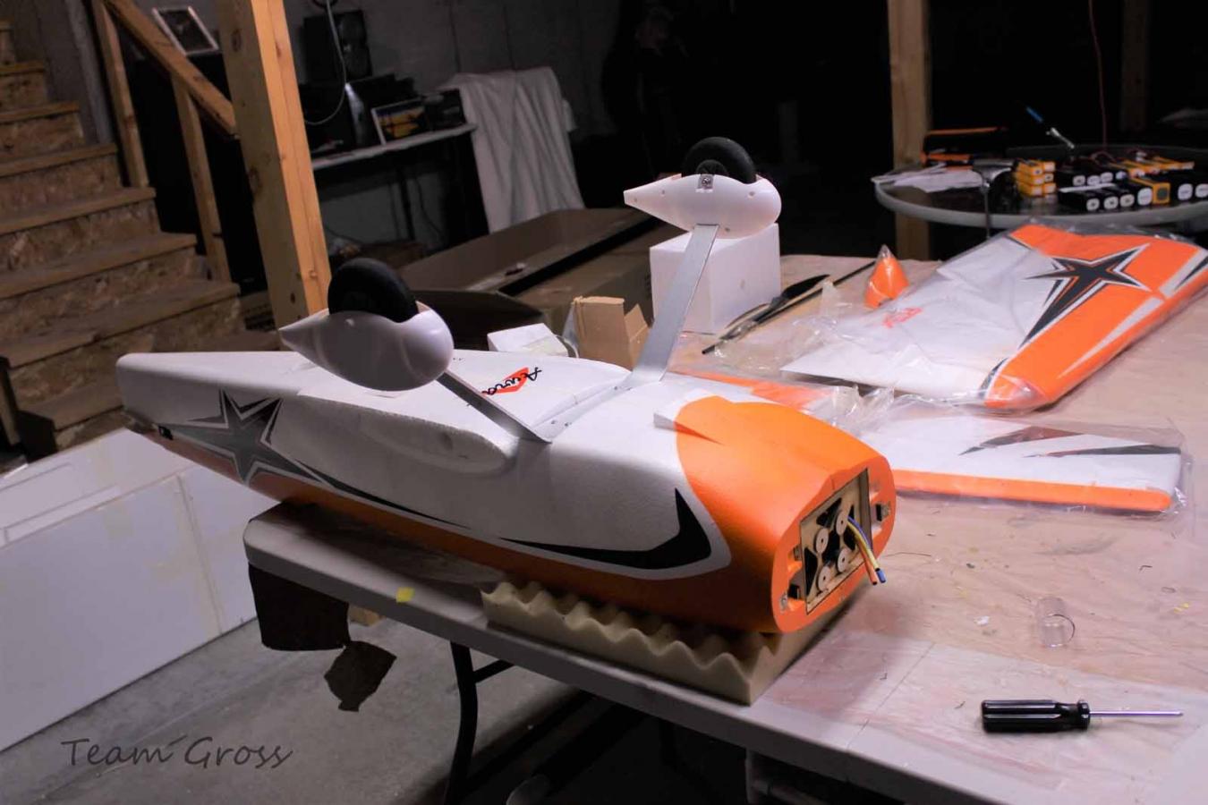

    Hey all, I've been wanting this airplane since it first came out and FINALLY I have one!
    Here's some assembly pics of the biggest bird in the fleet...

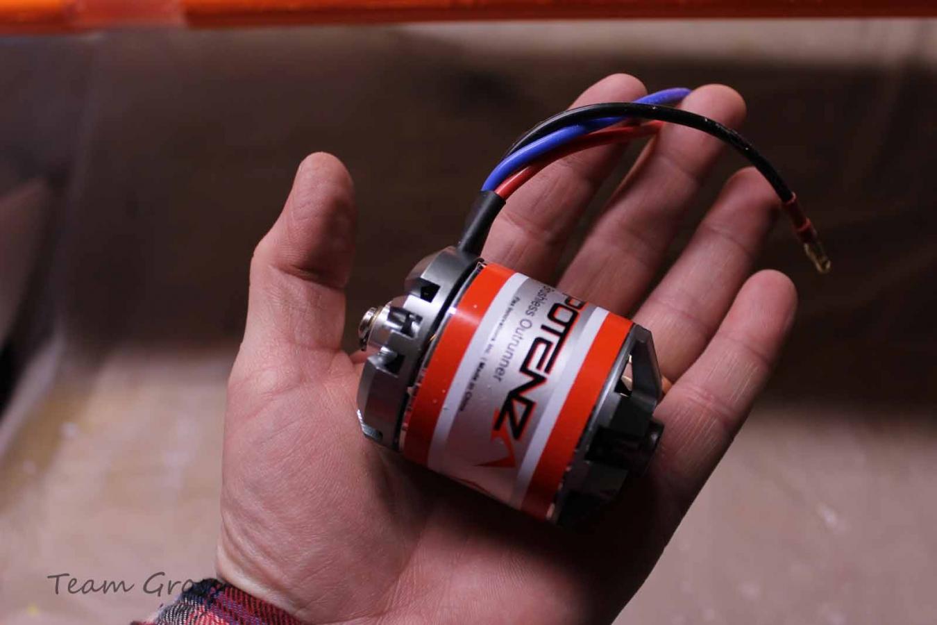

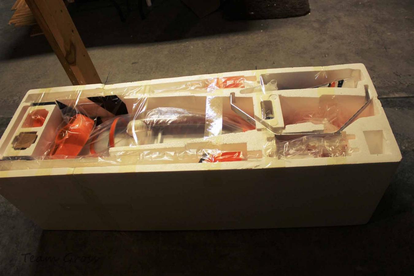

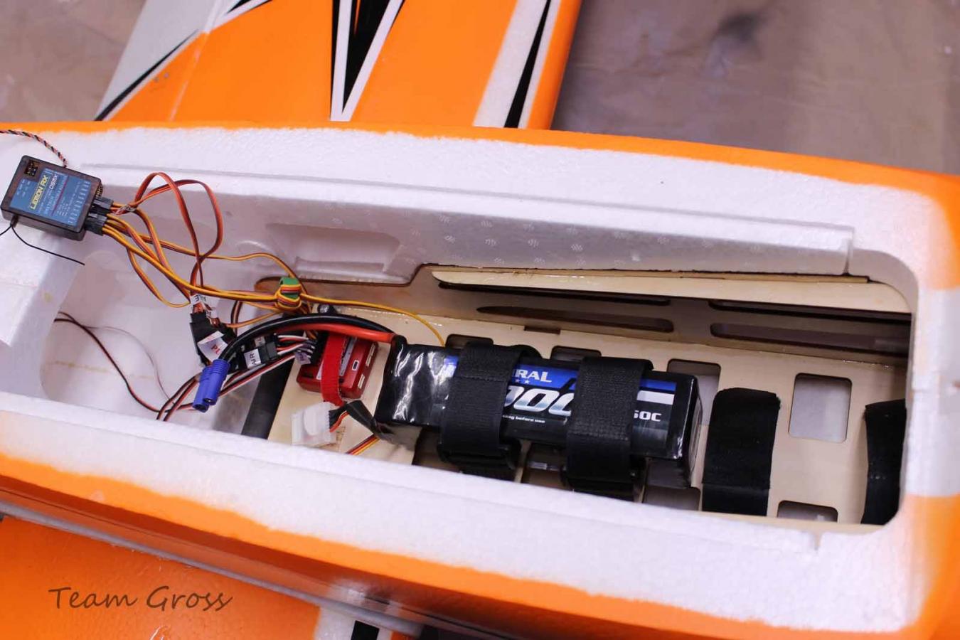

    A cavernous battery bay! That's an Admiral 5000 6s in there, note the Aura 8 gyro as well. The motor is not installed which is no biggie, the tail glues on with a carbon fiber rod running through it into the fuselage as well. In many ways, it reminds me of a big Pandora, it the cockpit hatch was the same it would pass as a Pandora big brother.

    Dan ………. 5th pic down, When did you get that Waco?? and what make is it ??
    Yep, it looks like my friend from Wy is now venturing into some 3D flying
    • #3
      That's the famed RocHobby Waco I got several years ago. She's a hangar queen now as the wing supports are made of plastic and gave out on her last flight, down she came, right in to a sage brush. Took her home and reassembled her and she's been hanging there for the last 2 years. I just couldn't kill her, even the last flight which was the best flight I'd had on her until the strut failure.

      The foam quality is good, not great but good so out with the Varathane to put some shine on her!!

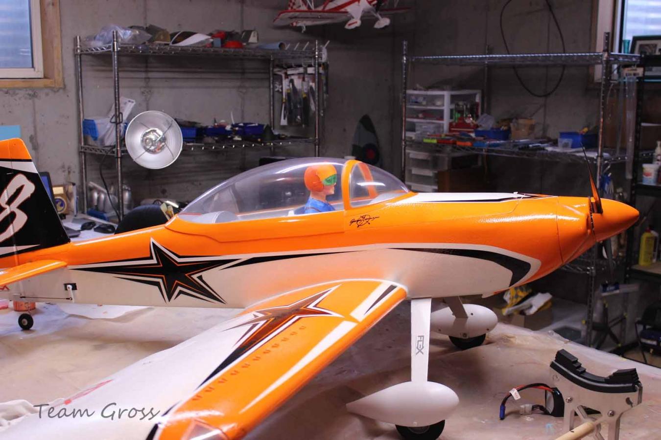

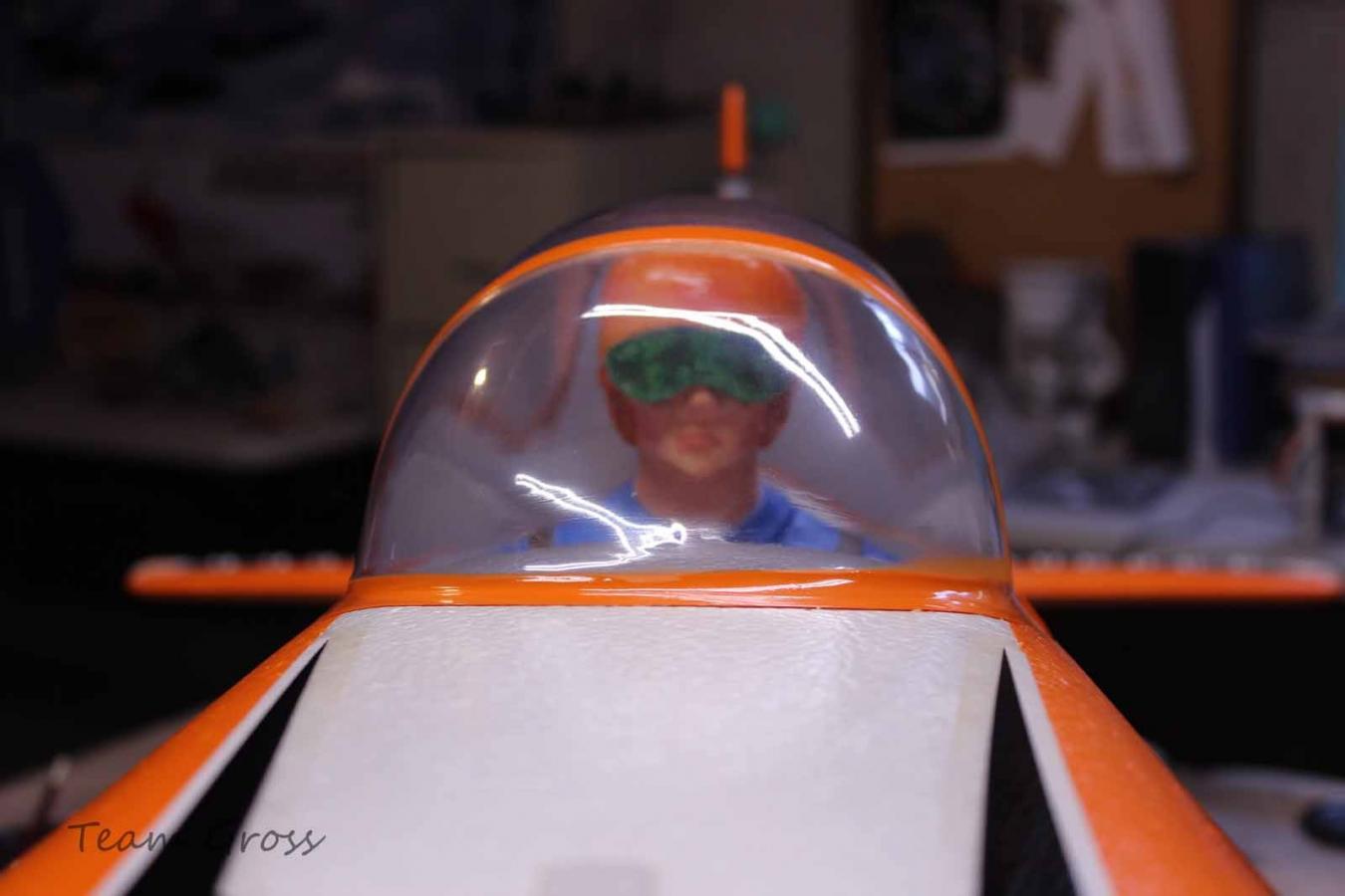

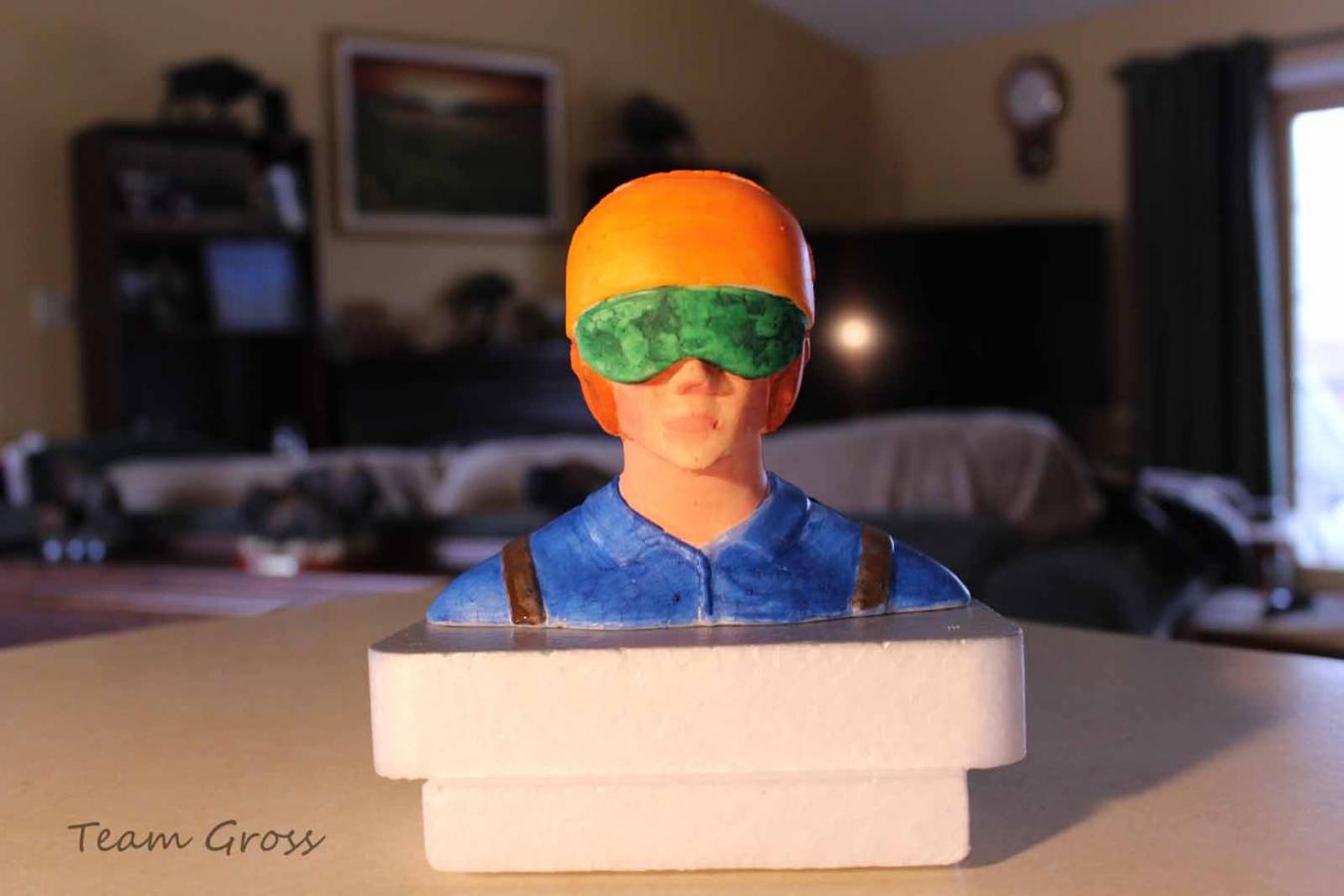

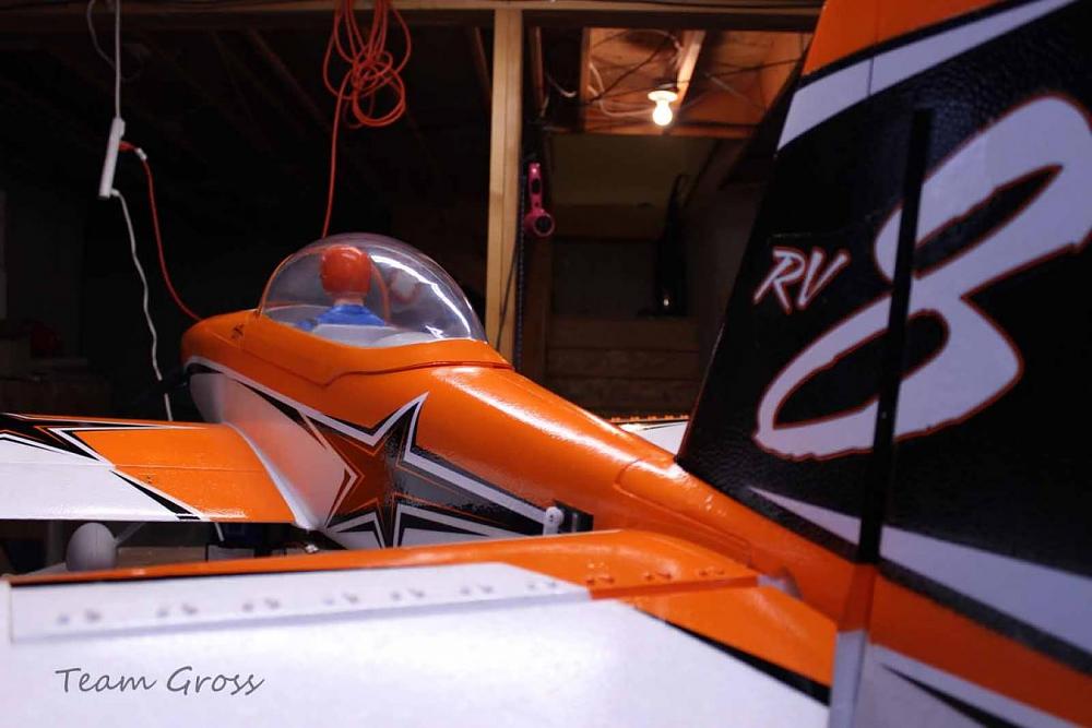

                Meanwhile, since its snowing and there's nothing better to do, out with the Spar Varathane and the paint! The pilot is made of foam and comes white with some funky decal over the visor, that soon changed, here's the results. It was a good time as I had Pilot Ryan on the PC in the background talking about Smart Batteries.

                She looks so much better now that she's nice and shiny and with a real looking pilot the airplane takes on a whole new look!!

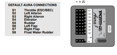

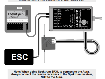

                          Well, got the Spektrum AR 8010t yesterday and hooked it up lastnight. Went back in and checked all my radio settings to make sure they were what the manual called for, bound the receiver then plugged it into the Aura 8 as per instructions
Name:	Aura 8 to AR8010t.PNG
ID:	236133Click image for larger version
Name:	Aura 8 connections.PNG
                          S1-S8 being the outputs to the servos and the SRXL being like the S Bus for a Futaba. Seems too easy to believe, but , to quote a certain politician, "Son of a B***H" it worked!!
                          Tonight I'm going to use the laptop to tap into the thing and see where all the settings are, it seems, at least for me, that it could use a bit more expo. It would seem that its much easier to go with a recommended receiver than to believe the hype about any servo working. Maybe they will, but seems much more hassle free to just go this route.

                            Not to harp on the subject of Aura or no Aura, it's always easier and simpler to use an SBus set-up whether it's Spektrum or Futaba. The advantage of Spektrum is that you can use remote receivers, but in this case a regular receiver is recommended as Grossman found out. I fly Futaba so I always use a S Bus receiver. Going with a non S Bus receiver means you have to use a PWM set-up and I can assure you that is a pain. You also can lose some functions since you can run out of ports. I now understand Xviper frustration with the Aura and his FlexJet. Setting up flaperons is not possible with it's programming. I know because I had discussions with the developers. Spektrum programming is not able to do it, Futaba can be done but it would take a whole new program to do it. Grossman56, enjoy the heck out of the RV-8. It's a great flier and I love the way it will just float around with the flaps down. I have maidened a few of them for fellow fliers and helped them with the set-up. I have the Cessna and love that but the RV-8 will be my next purchase.
