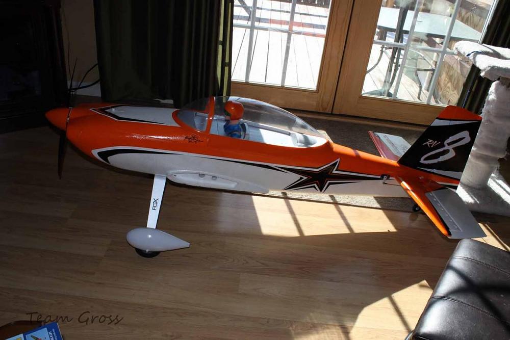

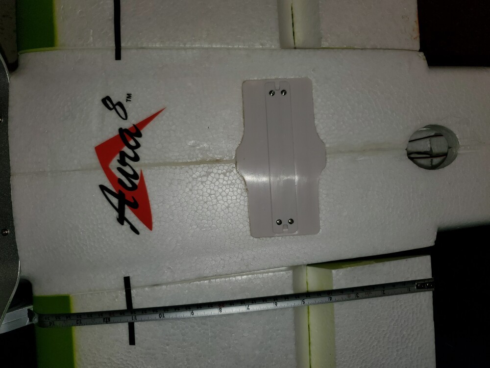

    I have a nice big aircraft stand the wife made me, got to thinking, if I inverted her and sat her on the stand, I can perform the finger method fairly easy, actually two fingers per side as I don't want to make any more dimples in the foam than necessary. Worked fine and its close enough for initial flights, she comes in slightly nose heavy, move 1/4" either way and she' either nose or tail heavy, so it should be good. Thanks for the guidance guys!!

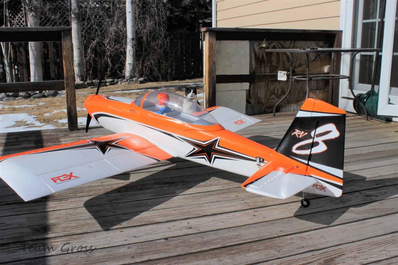

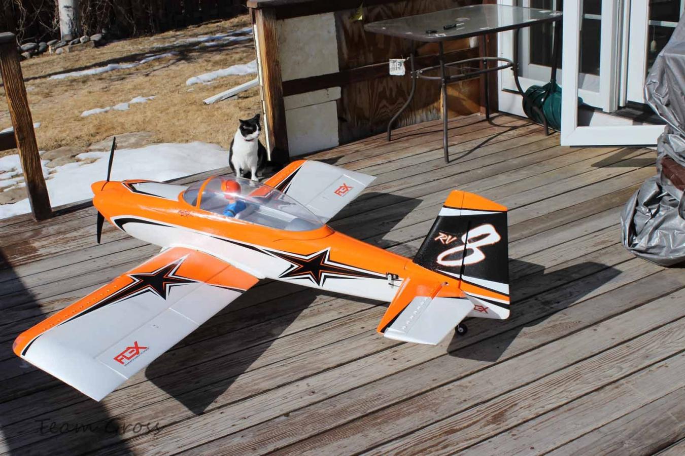

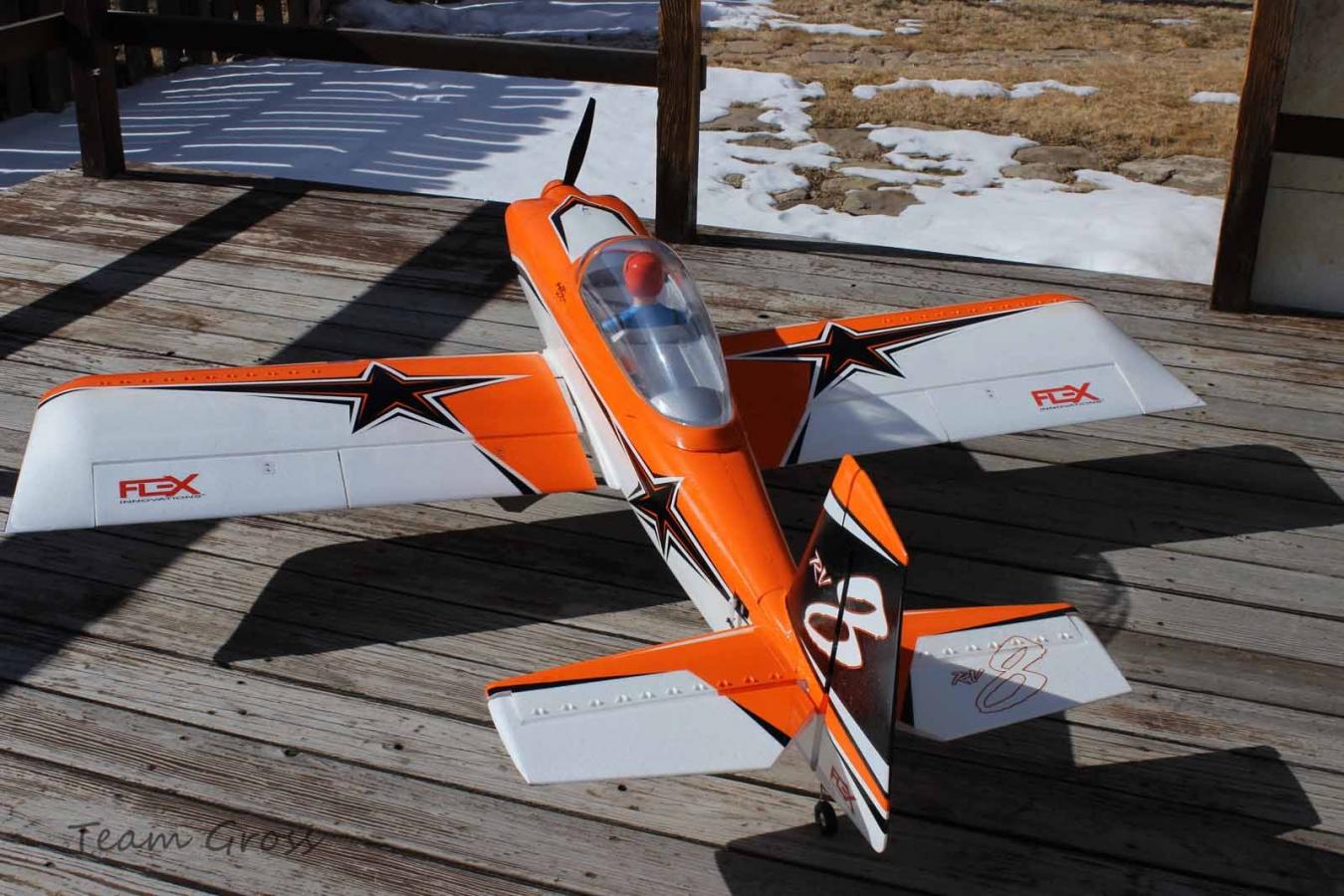

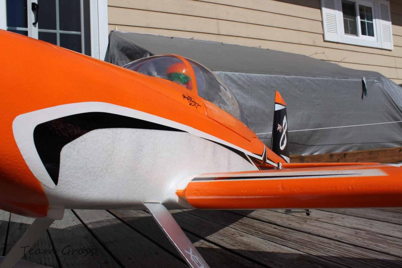

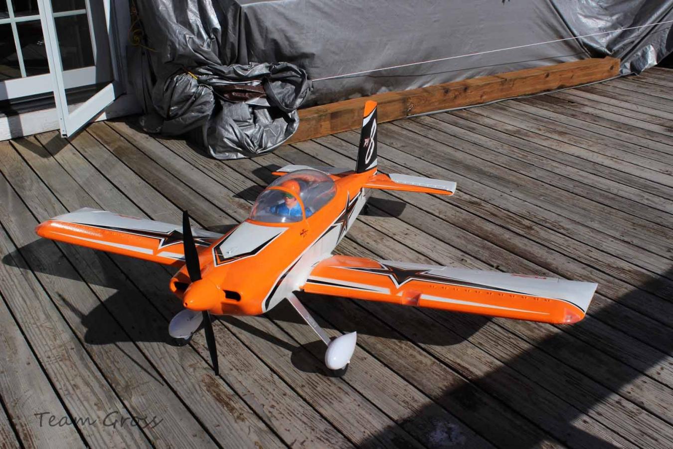

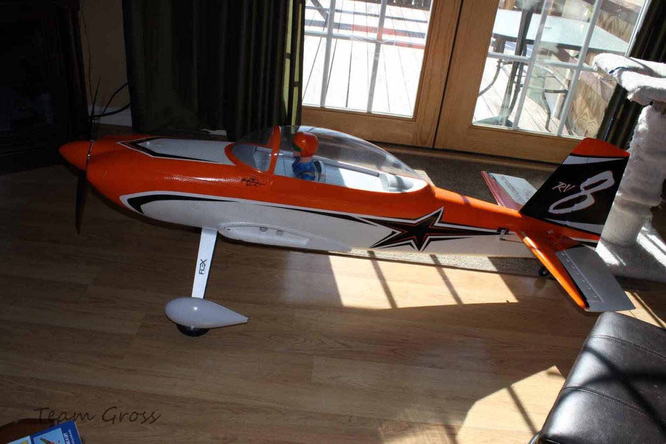

      The sun came out and no wind so I got a chance to take her out on the back deck for her official coming out pictures, a tradition of mine for all new birds....
      Of course the wings had to be removed but that proved to be a simple maybe two minute job...

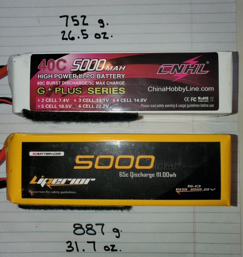

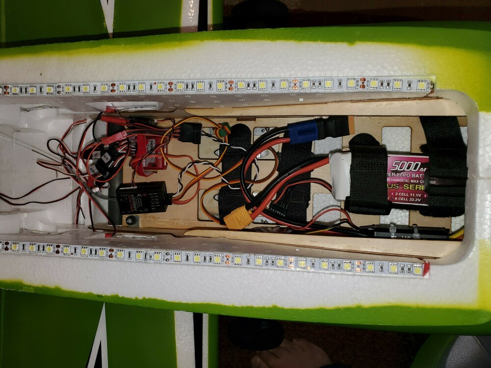

                                  How is the battery placement for everyone in the FI RV8? With my heaviest battery, a 887 gram 5000mA 6S battery tight against the firewall the plane is still 1/4" tail heavy based on a Cg 285mm from trailing edge. With my 750 gram battery it is 5/8" tail heavy? I sure would hate to have to add any lead to a foamy. I was hoping for the "Sport Flying" Cg and not the "3D" Cg.
                                    #37
                                    Go to post 6 on this thread. It flys perfectly for us with this placement.
                                    Playing at night, figured with the short daylight hours, it would be good to have some lights:innocent:
                                      #38
                                      Also you can see, with it there it will fly just fine running sport patterns as well as 3d. The arura is an amazing flight controller.

                                        I believe you when you say it works for you with the battery as shown but that is your plane, there is something different about mine. Look at where my battery is and I am still 5/8" tail heavy and I can't get the battery back any further. It is also a pain to work with that last strap under the cowl, with that cavernous opening I am still fighting the front strap. Is it the spot light and LED's in the tail that make mine heavy, should I have used Thin CA instead of 30 minute epoxy on the tail. The manual goes to great lengths to warn of the importance of correct Cg, kind of a disclaimer I think so I am apprehensive about finding out if I am OK. I have been flying RC for 30 years including EDF but I am not an advanced 3D type flyer so I am being safe with my $600 foamy.

                                          I dont think so, as I have the same night version. So all that is normal. Only thing I can think is, how much glue did you use when installing the vertical stab. I used very little on mine. Interesting situation indeed.
                                          I did use CA on mine as well. So we may be on to something here.
