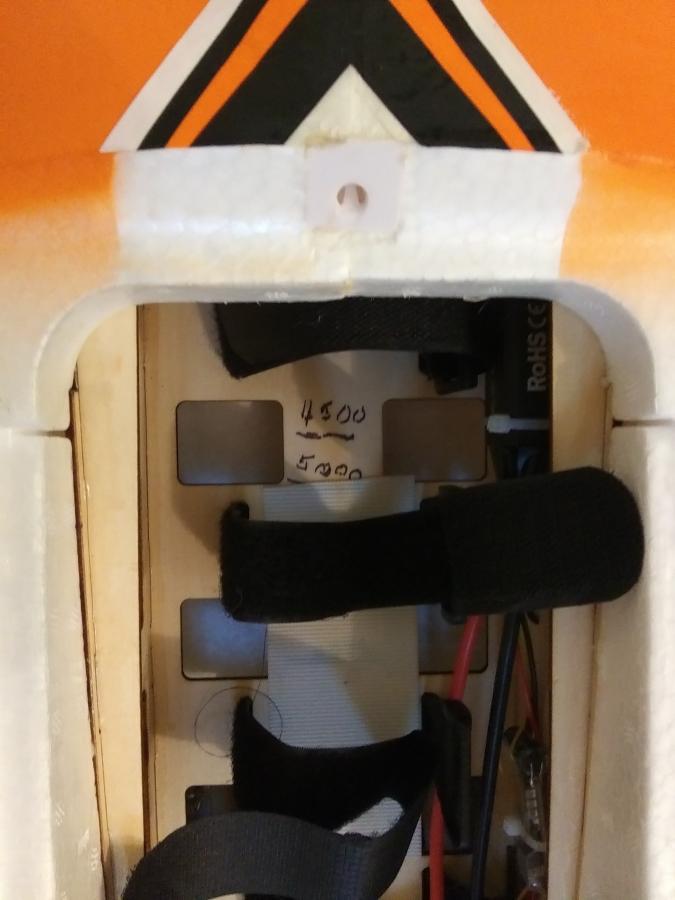

    Mine is not the night version, but I doubt that the it makes that much of a difference.
    Here's where I placed my 5000 and my 4500's (Admirals) and the plane flies like a dream. At first I had the same frustration trying to figure out the CG and how some guys had run a 6300 in this plane! I followed RM's advice and its great.
    Click image for larger version  Name:	20200909_173030.jpg Views:	0 Size:	48.8 KB ID:	273607
    Just check your throttle as well, the only thing I found that wasn't explained in the manual is that you have to adjust the timing on the throttle from the radio. Easily done, see post #32.

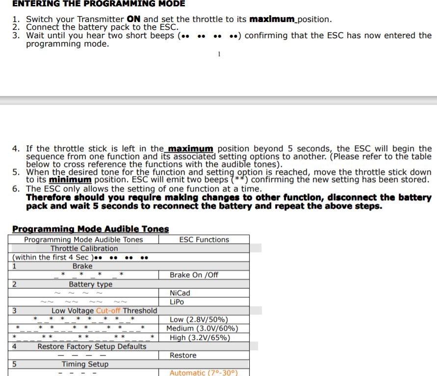

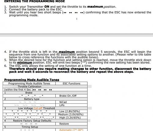

          • #45
            I found out how to turn the "hard brake" off, it is in the manual for the ZTW speed control. Below is an excerpt from the manual for turning the brake off. The manual can be found on-line.​​​​​​​
