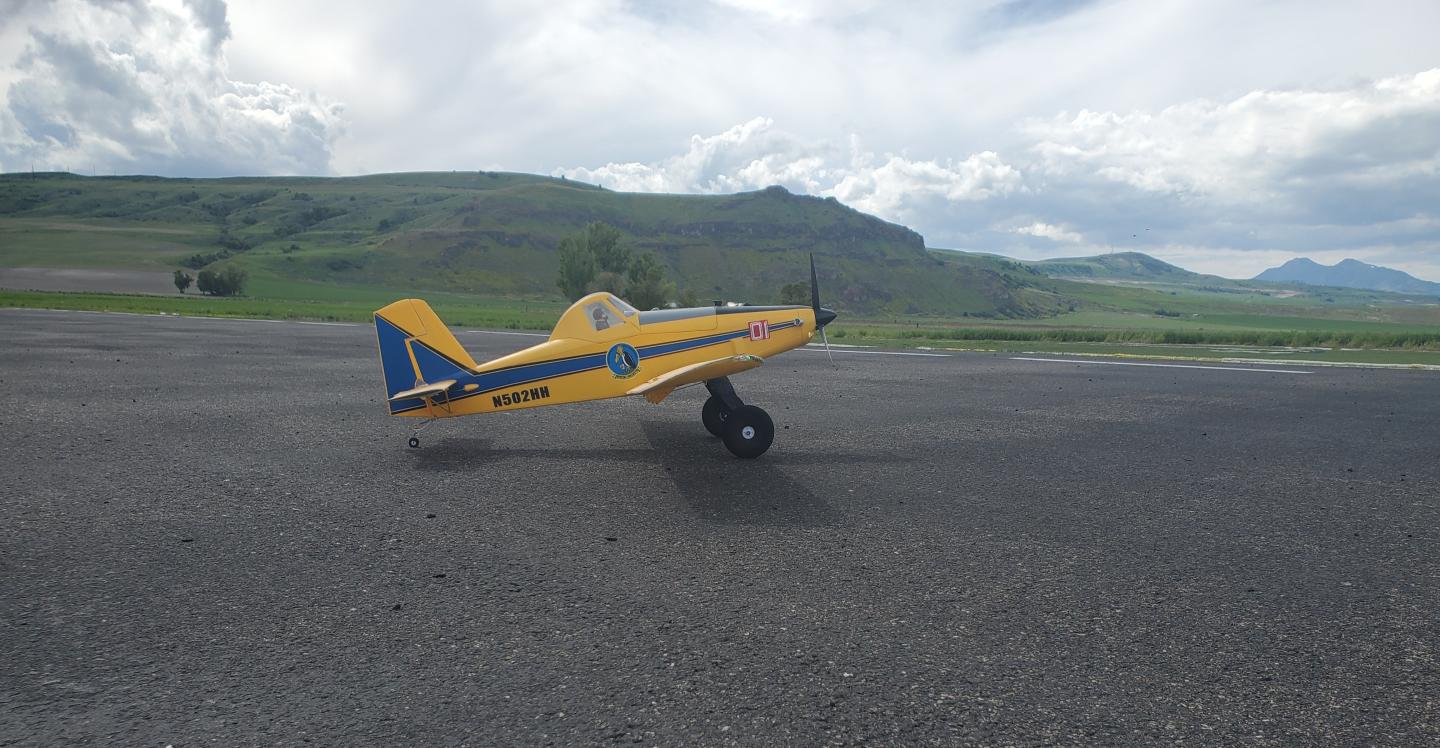

                      #30
                      Click image for larger version  Name:	20210218_201947.jpg Views:	0 Size:	95.1 KB ID:	300121 One of my winter projects. The floats are on backorder. I was actually evacuated from my house last summer because of a fire. Two fire boss ATs showed up just in the nick of time to save a house down the road from us. My avatar photo is one of them making a drop. He actually ended up catching a power line with his floats, fortunately they either have a cutter on them or the power of the plane over comes strength of the cable. It was already a tense moment, we were really scared for the pilot for a moment. Everything turned out ok in the end. But I bet his seat cushion suffered that day. No houses lost, no planes lost, no one hurt. It was a campfire that wasn't put out properly and was left unattended.

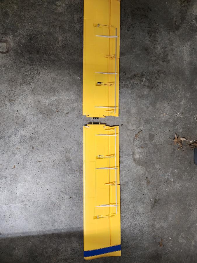

                        #31
                        I think I might try to add a sprayer rig to my air tractor. Going to use a Miracle smoke pump and push water through aluminum tubes under the wings. Designing a tank to fit in the battery hatch, then the plumbing. Mounted the tubes.

                          #32
                          I think I might try to add a sprayer rig to my air tractor. Going to use a Miracle smoke pump a push water through aluminum tubes under the wings. Designing a tank to fit in the battery hatch, then the plumbing. Mounted the tubes. ​Sorry for the double post.

                            #33
                            Awesome! Even just having the rig hanging off the wings will be cool!

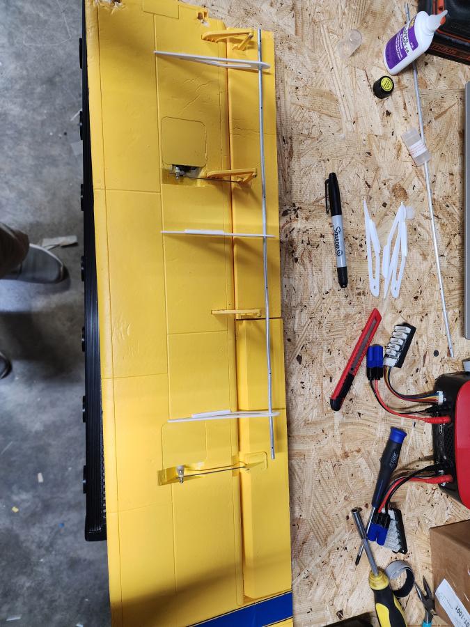

                                  #36
                                  Got everything mounted and plumbed. Test run on the ground had water spraying equally from the 5 holes on each side. I plan on mixing in a little food coloring or milk to make the water more noticeable. Test/Maiden this weekend.

                                    #37
                                    Got everything mounted and plumbed. Test run on the ground had water spraying equally from the 5 holes on each side. I plan on mixing in a little food coloring or milk to make the water more noticeable. Test/Maiden this weekend. Click image for larger version

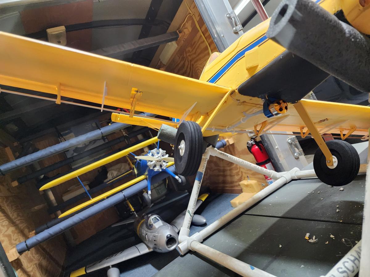

                                      #38
                                      rlcamden Very cool! It's so damn fun to fly. Eager to hear how it goes! I like your trailer setup, it actually confirmed an idea I had for my trailer, of using metal closet rods and plumbing insulation for pads. I need to add a third tier to bring more planes. Thank you sir!

                                        #39
                                        Here's a better look at the way I have it set up.
