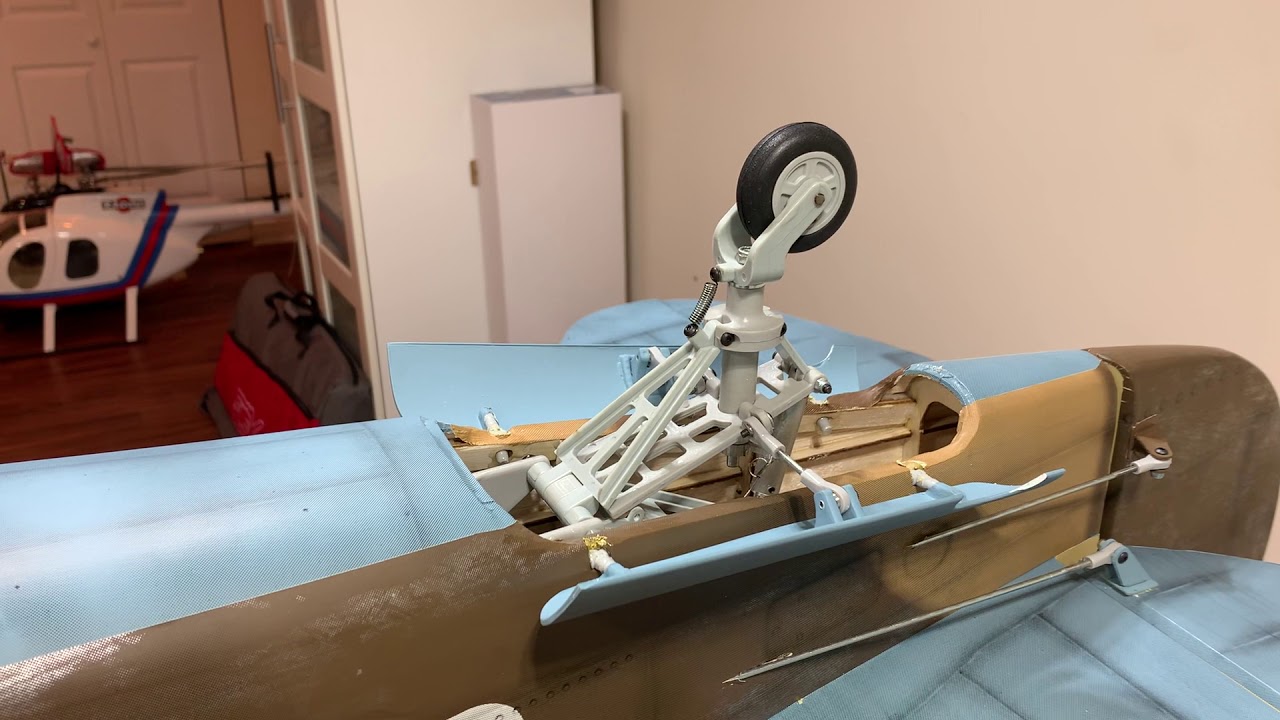

                #67
                Almost done.Put some effort (hours) to the tail gear.

                      #70
                      Hey all,
                      Short question for those with the P40/Corsair/P47
                      I have an issue with reversed retracts. The mains are coming out the tail retract is going in. Any idea instead of a reverser?
                      Made several trials by letting the the mains unplugged or the tail but it seems it does not work.
                      Any ideas?
                      • Michael Rader
                        • Nov 2020
                        • 27
                        • Chicago
                        #71
                        Solved
                        • TwistedGrin
                          Hobby Squawk..... CLEAR!!
                          • 376
                          #72
                          What was the fix?
                          TwistedGrin
                          • Michael Rader
                            • Nov 2020
                            • 27
                            • Chicago
                            #73
                            Had to plug the tail servo lead wire the wrong direction to the box. Don’t know why but it works.

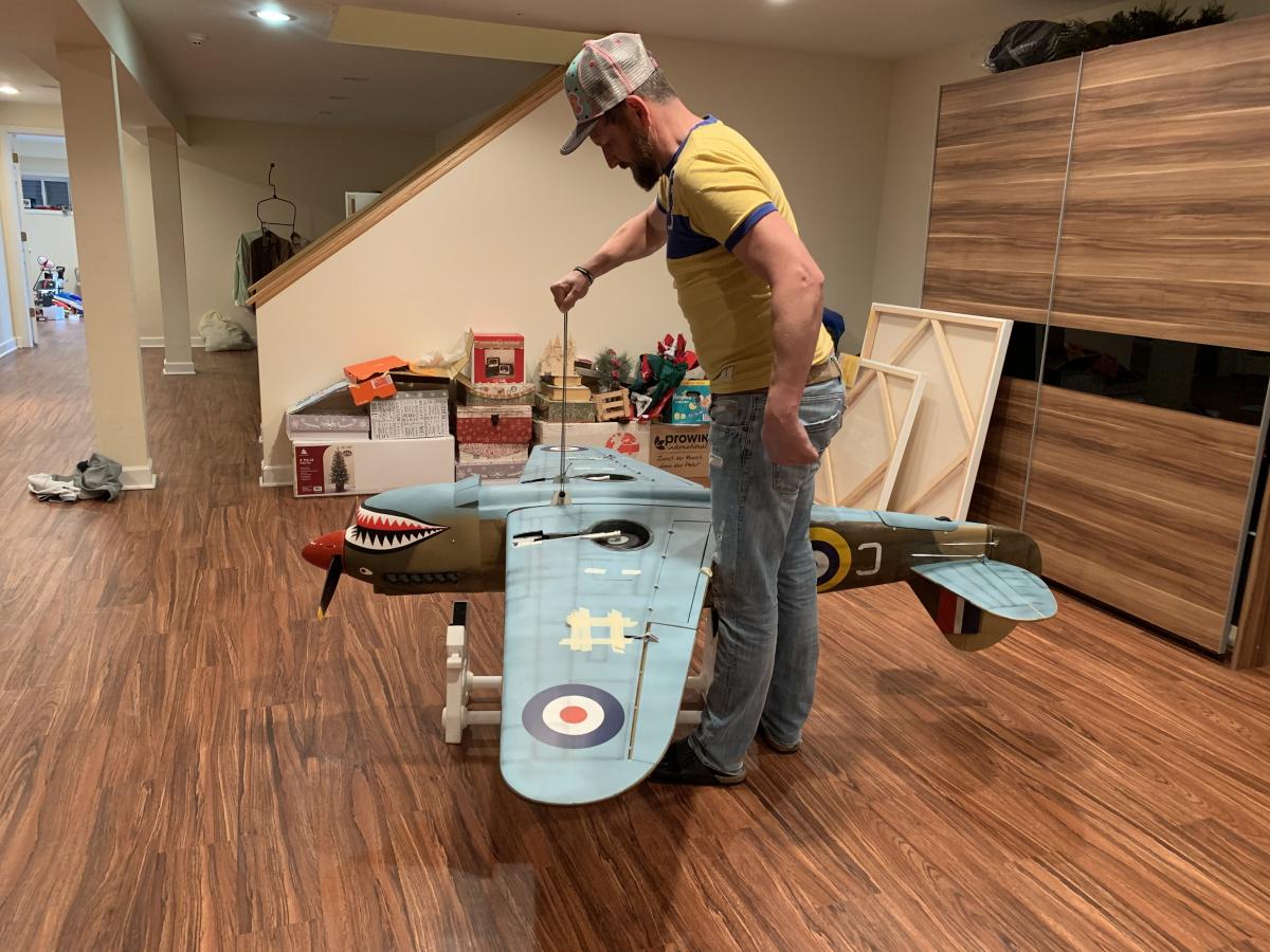

                              #74
                              CG is set on spot.

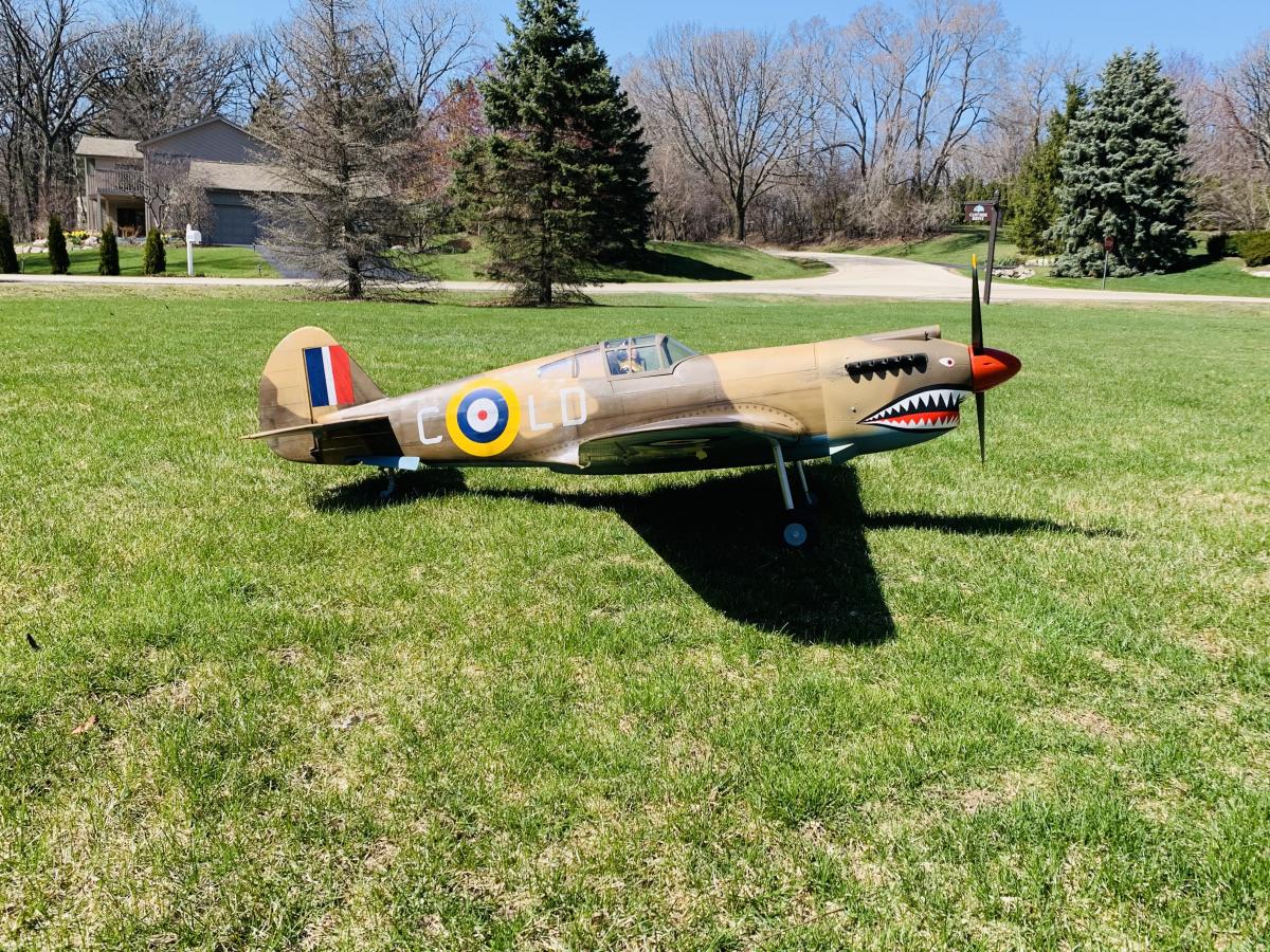

                                #75
                                1st time fresh air for the P40.

                                    #77
                                    Gents - any comment on how this bird flew....light wing loading...floaty...heavy fast landing....still on the fence for this airframe
                                    I am searching for a nose spinner that is sharp pointed intead of the stock round blunt
                                    TwistedGrin
                                      • 4873
                                      #78
                                      MR, Very well done. She's a looker. Love the RAF desert scheme on this bird. Best, LB
