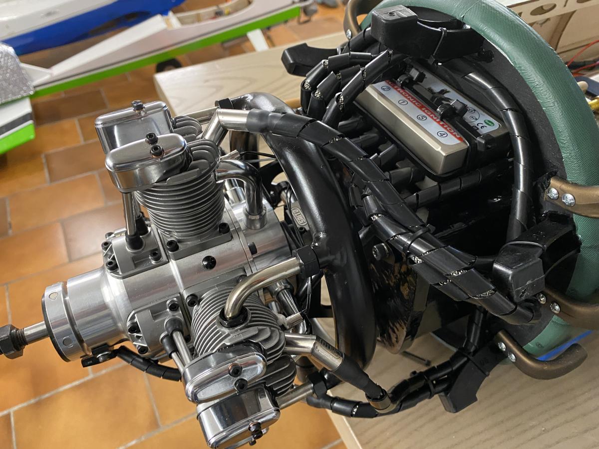

            I haven't glued my tail cone on. I wait for the balance. Thank you for the hint. Engine and cowl assembly finished. Im am testing some positions for the elektric components. I will use two LiFe battery packs to geht some wight under the ruder servo.
            Next i make the wiring clean and properly and let the engine run the first time in his final place.

                  I can´t order the servos. Not in the shop inventory in germany. I do some embellishments....

                                Here are some build updates:
                                Cowling with sound absorption and some grid in the air intake.

                                Test run with the engine in the plane is done.
                                I adjust a 5x temp sensor (PBS-T250) from PowerPox Systemes to runs with futaba telemetry and
                                program the Multiplex WingStabi with SBUS.
