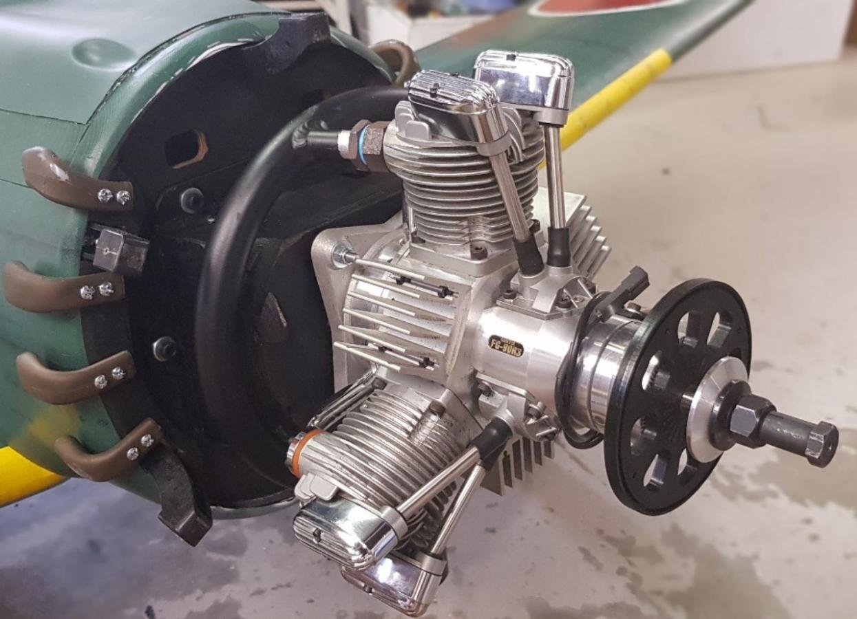

                #87
                Originally posted by nicco
                So you removed material from the engine mount (to fit the exhaust) and then you added some carbon fiber + epoxy on the inside to reinforce it, is that correct?
                Yes, for the Keleo exhaust ring, if you go with the standard flex pipes you'll be able to route them clear.
                What is the recommended distance between the ring muffler and engine mount?
                It sort of wraps around it so you need to take away material to get it to fit. My exhaust clears the mount by 9mm. The reason for that distance? That is what it was after linishing.
                You could cut off the front and sides of the bolt-on mount, add another plate and use long standoffs
                How large is the place for tank and electronics, can I fit a smoke system as well?
                Very large, the whole top fwd half of the fuselage comes off like many aerobatic models. Yes.
                Maybe the picture shows the mount better. It has 5mm spacers in this image that I've taken away. You'll have to expand and lengthen the cowl slots for the stub exhausts to get prop clearance. The ignition sits on top of the mount behind the engine.
                What I really like about the access to the fuselage and this mount is that you can reach in and prime the engine with your finger, rotate the prop until your finger is just wet, then put the top/canopy back on. This engine starts every time hot or cold within 2 flicks that way.

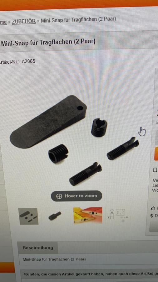

                          #92
                          Hello Nocco,
                          you will have many fun with this great plane.
                          Here is an idea for a removal tail.
                          Mini wing fix like Multiplex Multilock:

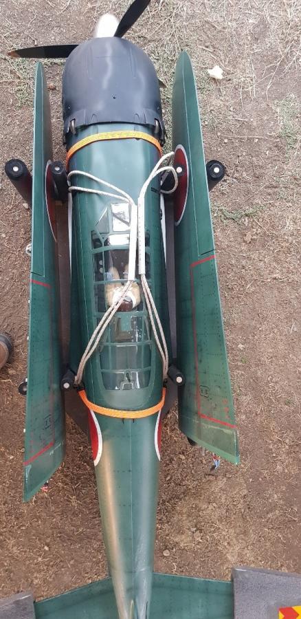

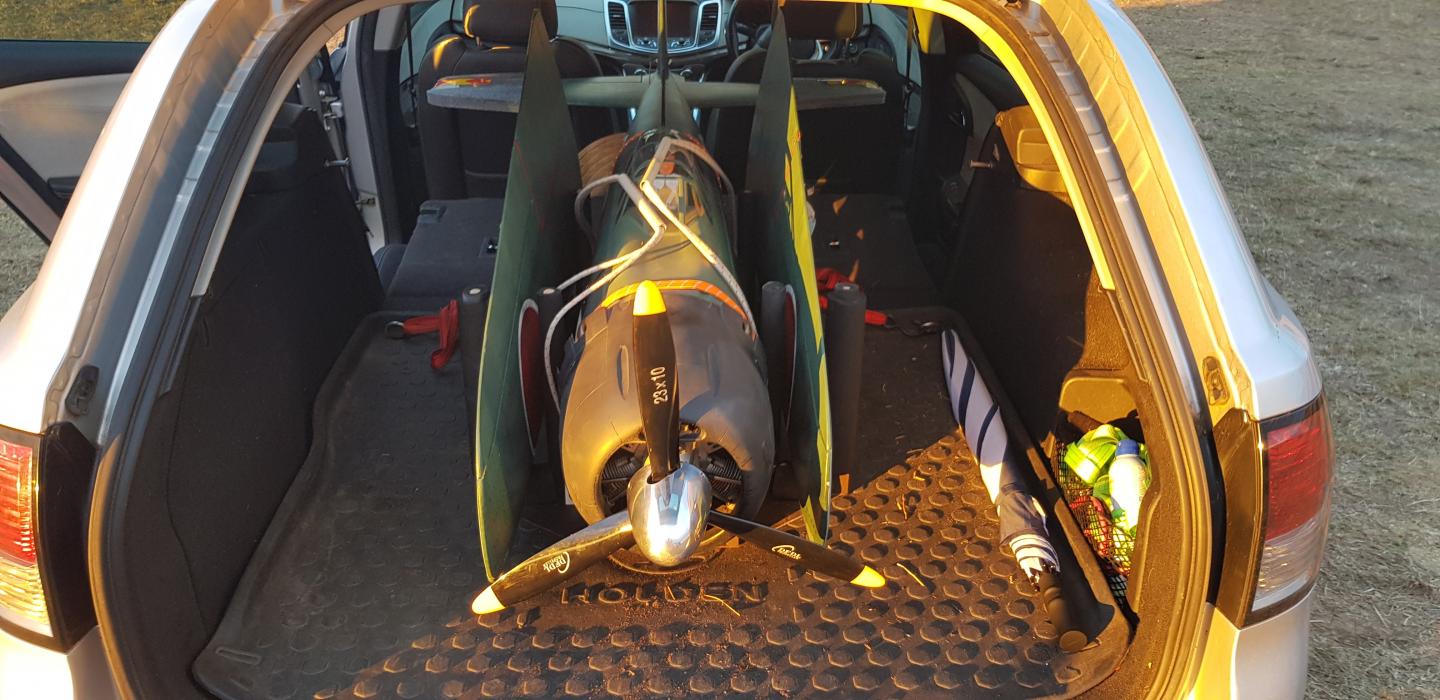

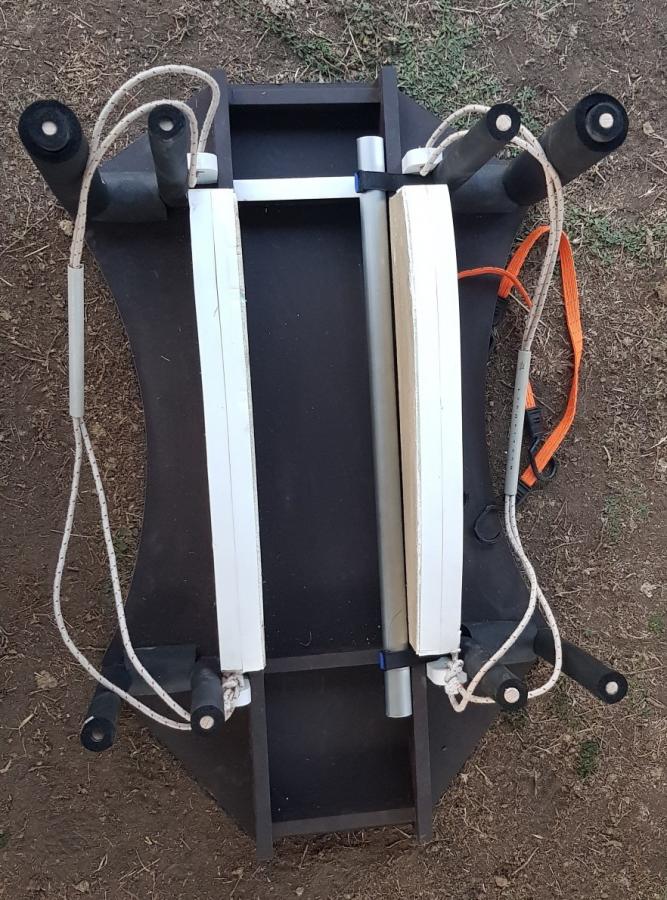

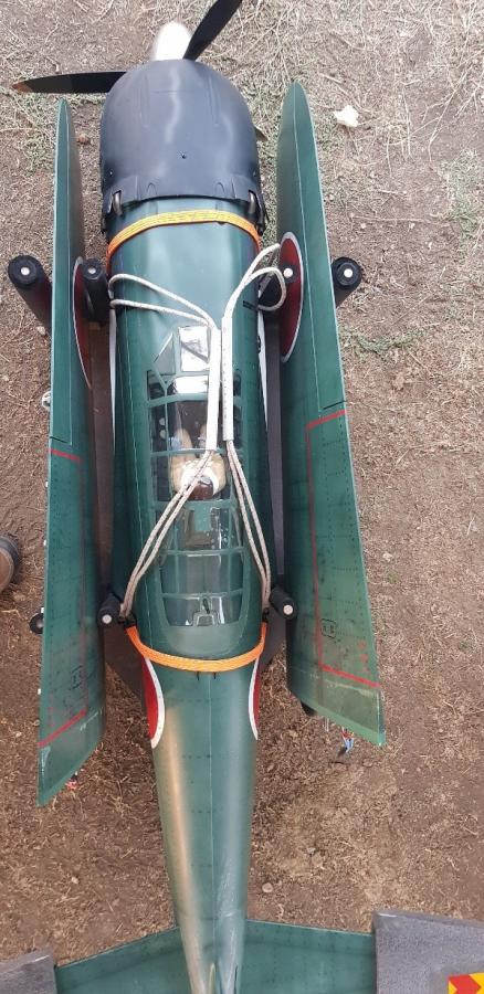

                                #95
                                I do unless its very windy, you can some landings see here. I flew it again today.
                                Made a holder for it, luckily I have a car it fits in.
ID:	261801Click image for larger version
ID:	261802Click image for larger version

                                    #97
                                    I didn't know how thirsty the Saito would be, so went larger, the tank I have installed is 700ml, I am looking for 15mins duration, it seems to be very good on fuel so I'm going to change down to 500ml. I can't say exactly how long it flies on a tank as I didn't time my flights. I fly Jeti and probably rely to much on its cleverness, I forgot to setup auto logging. Yesterday due rain and low light, the available flying time was shortened to three flights, the first roughly 10mins, the next about 5 and the last was two fast circuits and a landing. I used about 1/3 of the tank. I will probably have the smaller tank installed for a warbird meet in two weeks. Sorry it isn't a definitive answer to your question.
                                    Dennis, on the first flight yesterday I did have the right hand gear not fully retract. It came out OK for landing and worked without a problem on the ground and a later flight. It did the same on its second ever flight. Can't see what might be causing it. Might be air load, so speed related? I'll be monitoring it on future flights, until I'm confident I won't fit the belly tank. Glad your model is OK, they do fly very nicely.

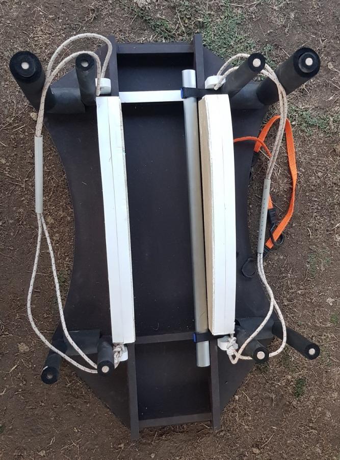

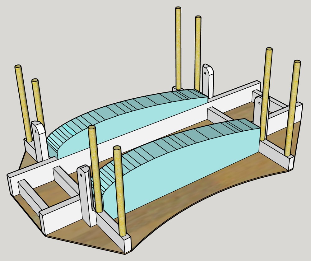

                                        #99
                                        Hi Joe, thanks, the carrier comes from this Sketchup drawing I did. It was inspired from a background shot in a German YouTube video about an r/c Warbird display from 15yrs ago.
                                        Its good for plug in wings, but can be altered for other types. I got tired of wrapping wings in bubble wrap and blankets and having them move around and get damaged. I also have the unfortunate habit of forgetting wing joiners, so have a spot to velcro it on the stand. Not very visible in the image posted above are foam covers for the stab tips.
                                        The cross pieces are lap joints. Everything is glued except the harness supports, they have single bolts. The foam is lagging for hot water pipes. The wing supports are blue foam.
                                        I've asked my friend for his CMP Zero's CG and any relevant info.
                                        Click image for larger version  Name:	Zero stand.jpg Views:	0 Size:	127.5 KB ID:	261938
