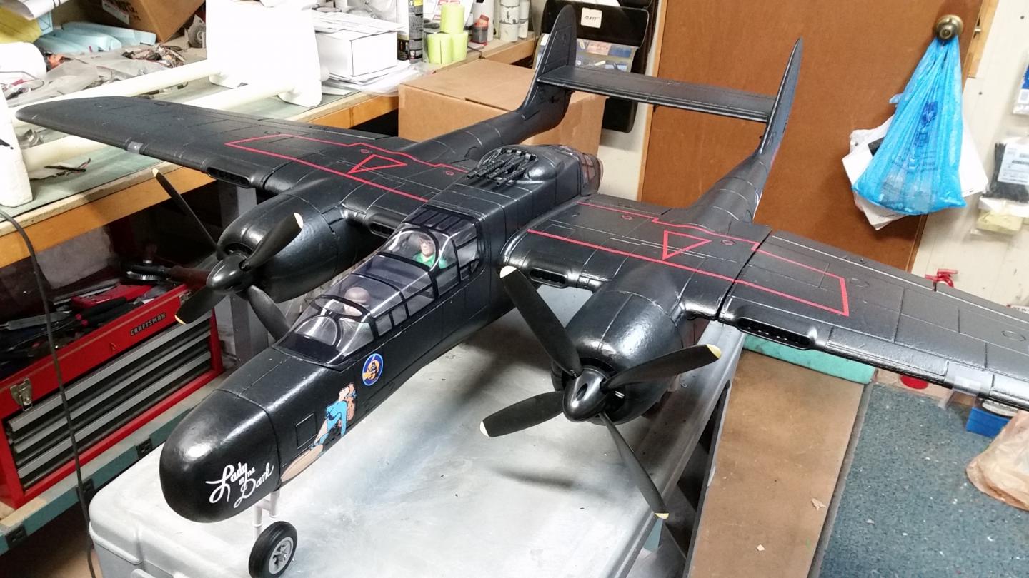

    This is Papa Boozers first attempt at posting something on the Squawk, so here we go. First things first ,why a Dynam airplane for the very first? It was the one that was in line for one of the Boozers projects. The plane did not disappoint in things that had to be corrected on the assembly or should I say build. The new design has all the servo wires coming up though the center of the wing, but the wires were not labeled. So, I had to use the servo checker to trace what was what, a pain! Second, there was no room for the receiver, cut out large hole where wires all come out for that. Also, guys please check all servo before assembly, they are know not to work! Fit and finish is not the best, things did not go together very easy. Third, main landing gear was installed but, factory left out Allen screws. took Dremel tool and enlarged opening around gear to be able to take gear out to install screws.....another pain. When installing the wing outer half no room for wiring, had to use the Dremel again. It came with water transfer decals....what a pain....most broke apart before I go them on the plane...did not stick well. I am not a fan of water decals! When I was a kid with plastic models, they were crap. With all said, why the Dynam plane? It's the only P-61 foamy on the market, like twins, and a good challenge. I got it with is plane. With all the time spent, I am hoping this plane fly as good a the twin cruiser Dyman has out, it was a pain assembly but, was worth it in the end. So, if you are will to put some time in and have some headaches, go out and purchase a Dynam product. Remember guys what the Boozer say: " You get what you pay for." and " Go out and Fly with you Buddies." Till next time....Papa Boozer/Dots. P.S. Watch for upcoming flight video on this plane on the Merry Boozer Channel and Subscribe. Pictures will be added later..

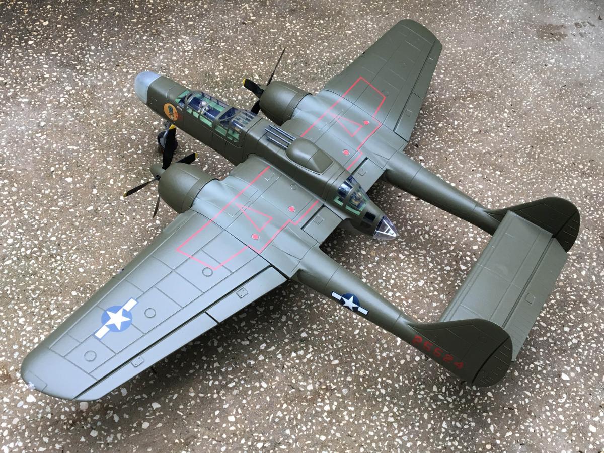

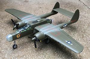

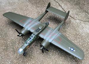

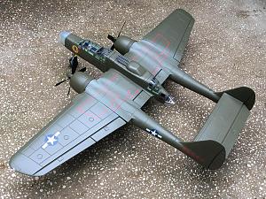

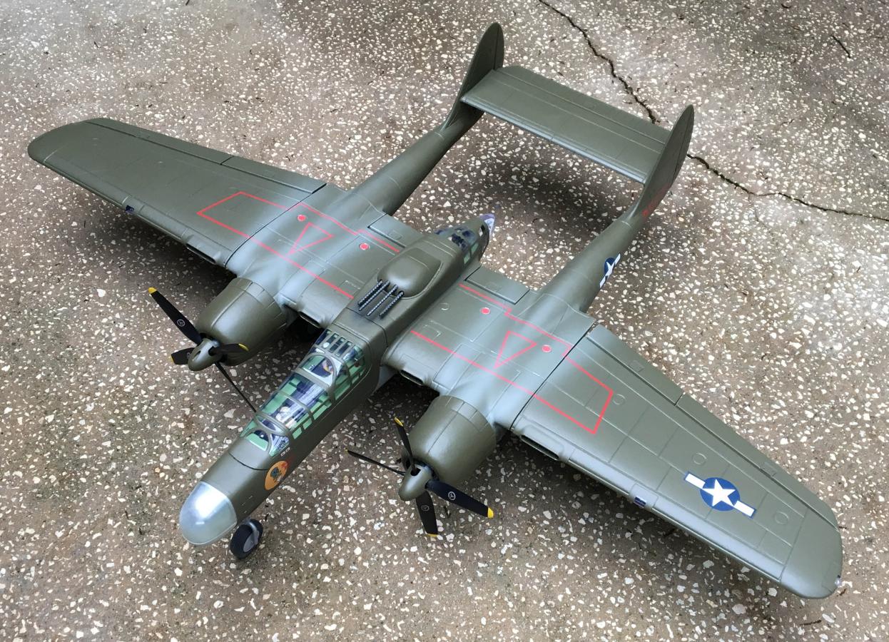

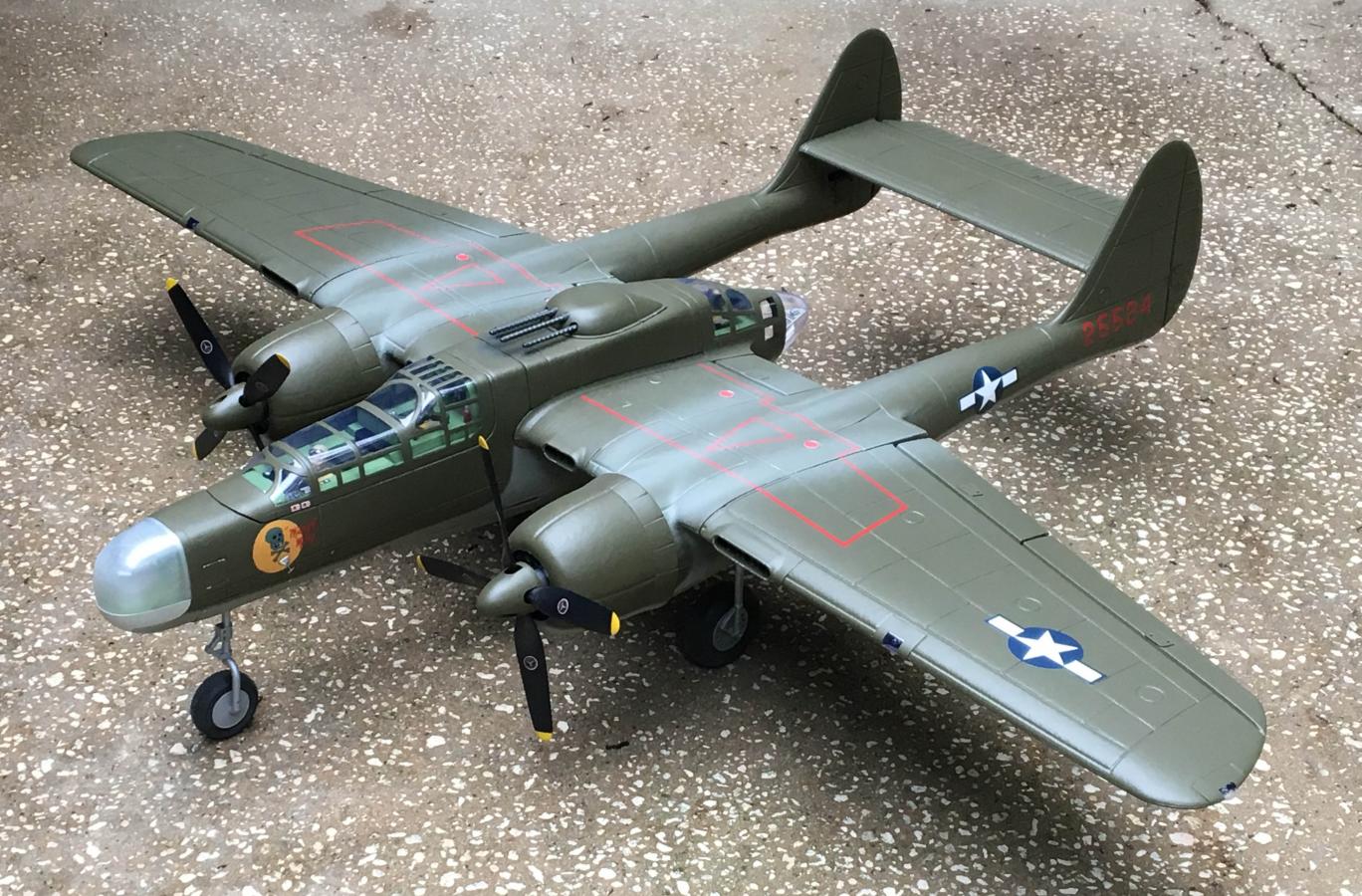

              I got one of the early production Dynam P-61's and spent many weeks replacing nearly everything, and repainting. New motors, retracts, ESC's... Details included a correct top turret (non-rotating gun fairing, actually) and simulated translucent fiberglass radar nose enclosure. Nose shortened to make it an "A" model. Markings are for "Moonlight Mickey" which downed two Betty bombers.
              As hoped, it proved to be a terrific flyer, especially with upgraded motors to give it "warbird umph". My father did one "stock" at the same time, so it was easy to compare.
              The Black Widow is one of my favorite planes... oh, to have a foamie 1700mm version...

                Papa, I love your rivet detail, it really makes a nice impression from a few feet away - I mean that pic looks terrific. Thanks for your review!
                The issues you noted during construction are fairly typical, as OV10 said, but just like you I enjoyed the challenge of making everything right - especially because this is such a terrific model. Couple of other things to note:
                • Black foamies don't do well in the sun - I coated mine with a satin clear-coat (water-based polyurethane) to protect it and seal the decals. (I used Callie Graphic decals and threw out the water-slide ones)
                • The nose-gear mount is very weak. I epoxied in some hardwood rails for the retract unit to sit on. I also replaced all the race-car wheels with scale wheels.
                • The retracts don't work in cold weather. (so, meh, I fly this one when its warmer)
                • The tail booms flex a lot, so I added CF tubes on the bottom (sunk them in the foam) to reinforce the booms.
                • I modified the 50-cal turret so the guns were in a more realistic (and totally badass) stance.
                • I moved the pilot back, and painted the prop tips yellow.
                • I added some weight inside the nose cone, because the model was tail-heavy. (There are lead weights inside the tail fins but I couldn't find them)
                The elevator is relatively sensitive, so keep the control throw down and use expo. I think mine flies great and I love the way it looks!
                "Lady in the Dark" was a real P61 and had the last confirmed air-to-air kill of WWII.

                    MrSmoothie that paint job is fantastic!!! I love the streaks on the wings that adds so much to the model. Also I see you did a clear canopy on the nose did you make that or is it an illusion with paint. Fantastic job guys all around love seeing these custom birds.
