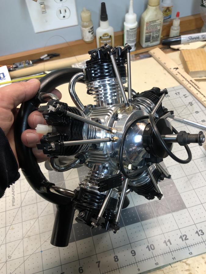

                  I ordered the UMS 5-55 today from ch- ignitions
                  Great price could not refuse

                    Im gonna look up the ums 5_55. I was gonna get another saito r3 but ill take a look at that as well. Im gonna paint my f8f in rare bear colors and ordered trim sheets from Callie.

                      The UMS 5-55 is not a powerhouse but should have enough so it’s not underpowered. I have to experiment with a couple different props ranging from 20 to 22 “ and different pitches.

                        Oh yea got the Ums5-55 and it looks like a work of art.
                        But in reality it’s only an expensive paper weight till I can test it out an give an honest opinion on its performance.

                          Really looking forward to how the UMS performs. The Saito radials have a ton of issues you basically have to retrofit a brand new engine if you want reliability and efficiency.

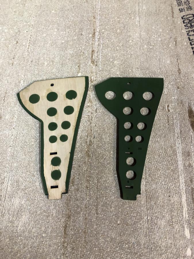

                                Any one have the same problem on the strut gear door fit.
                                Well it doesn’t.... not even close.
                                And for some other reason the manufacturers put a3/32 shim under the gear mounting tabs. Not sure why.
                                I think I’m going to build new outer gear doors to fit or omit them completely. Just seems like a lot of extra drag with not having doors to smooth things out.

                                  I cut a wedge out of the wood backer so i could form to the wing shape

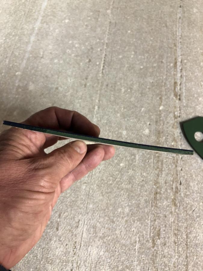

                                    #97
                                    I think I’m just gunna fabricate new ones.
                                    Then just glass and paint.
                                    The doors that came with were about 3/32 to an 1/8” to small for the wing opening not to mention they were also warped slightly in the wrong direction.

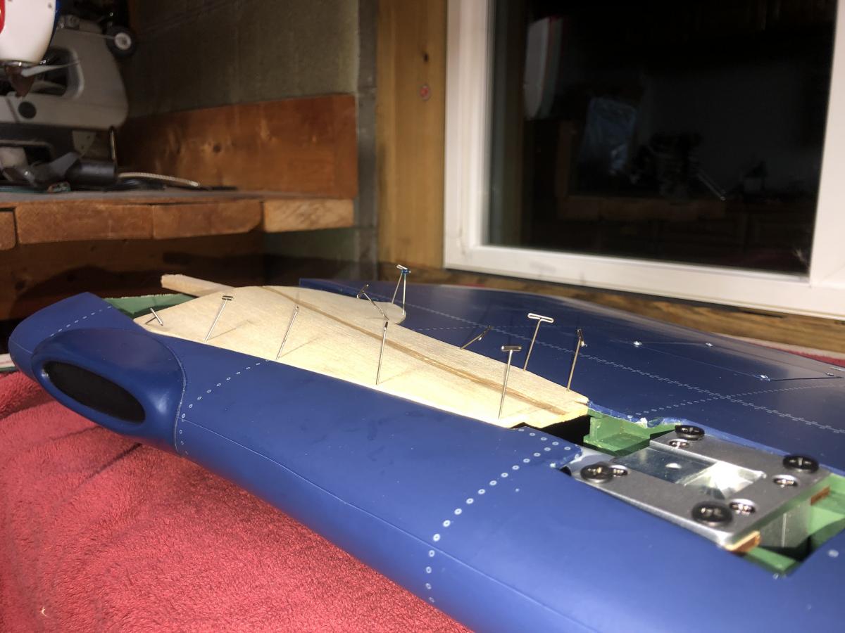

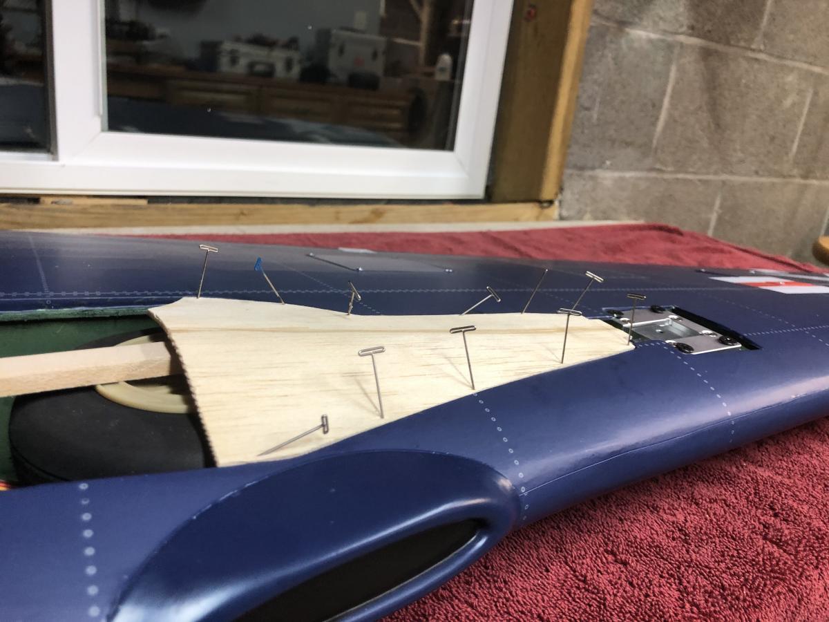

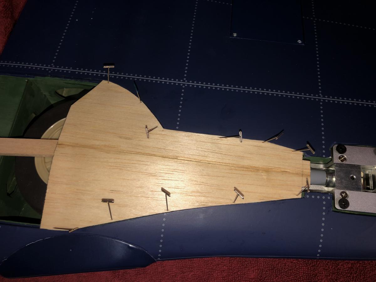

                                      #98
                                      Plan is to fit new balsa gear doors soaked in ammonia to shape and dry. Then reinforce and fiberglass to fit with the the wing as intended. I’m planing on 1/8 ply as a backer like the original but will not alter the shape

                                          #100
                                          That will look great?
                                          I’ll do something similar during my winter recovering. It’s such a nice flying model.
