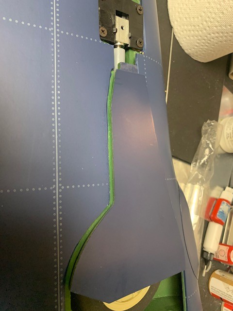

                    Well one thing went easy and that was the retracts. The gear doors if 100% flush with the wing inset will rub on the stock wheels. So take note on the gear leg connectors and make sure you select the longer one for insert closer to the wheels.
                    I attached my retainers ( loose ) and played with the doors to see how flat I could get them and clear the wheel. I am happy with the overall fit and know the doors will not impact my trim based on the final fit.
                    Not sure if these retracts are still for sale, they were the original Bearcat retracts from VQ & appear very robust.

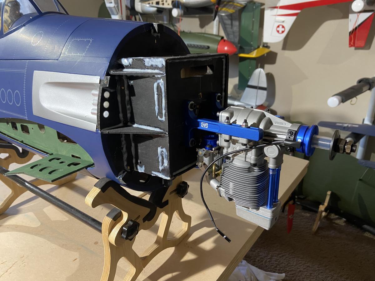

ID:	293250 When i assembled my cat I reinforced the Firewall with triangular stock. Used fiberglass control horns, clevis on both ends of the pushrods and added a support for the rudder torque rod which Im still not 100% happy with.
                                          Why they would include EZ connectors for a model this size is beyond comprehension.
                                          So I used the clevis’s from the wing pushrods to complete the fuse pushrods and then used 4-40 clevis and rods for the wing controls.
                                          It’s a superb flying model on Epower!
