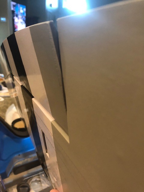

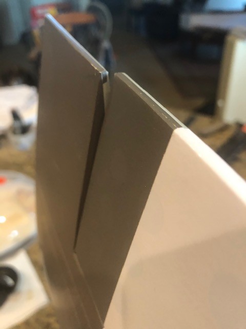

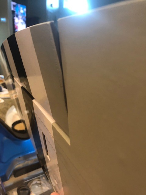

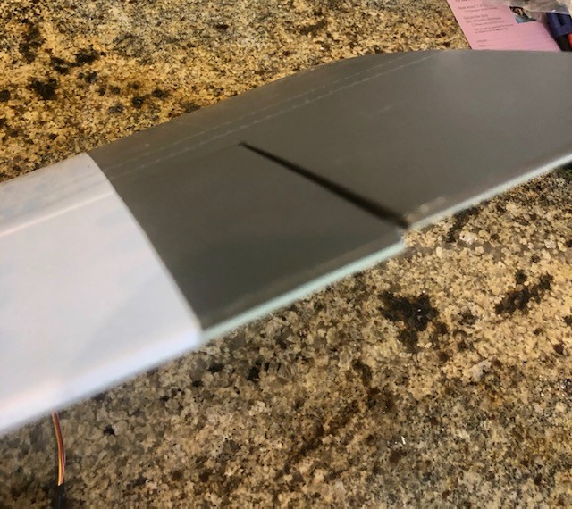

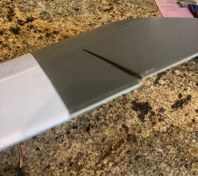

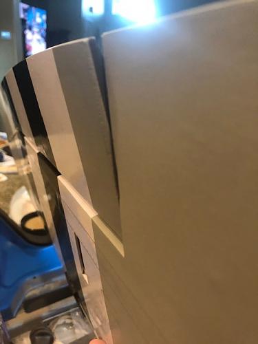

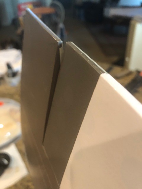

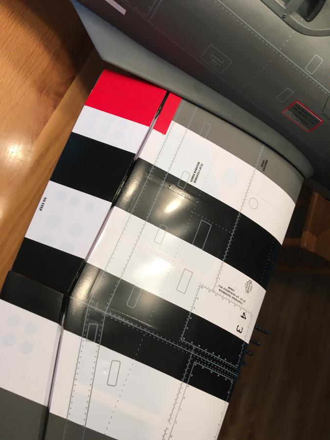

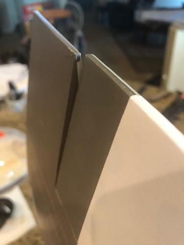

    I haven't installed the servos or anything yet. This was just the initial inspection from the box. I lined the aileron up with the wing tip then then the flap up with the aileron taping everything in place. The flap was all the way up where it wouldn't move any further up without pressure. The outer edge of the flap lines up with the aileron but the inner edge is about 1/8" lower than the wing root (the width of the trailing edge). The right wing lines up perfectly, it's just the back of the left wing that has the slight warp. I hope these pics are more clear. Is it possible to straighten balsa like foam, if so, how? Thanks, looking forward to your maiden.
    Click image for larger version  Name:	IMG_0613.jpg Views:	0 Size:	35.3 KB ID:	259333Click image for larger version  Name:	IMG_0612.jpg Views:	0 Size:	42.4 KB ID:	259334

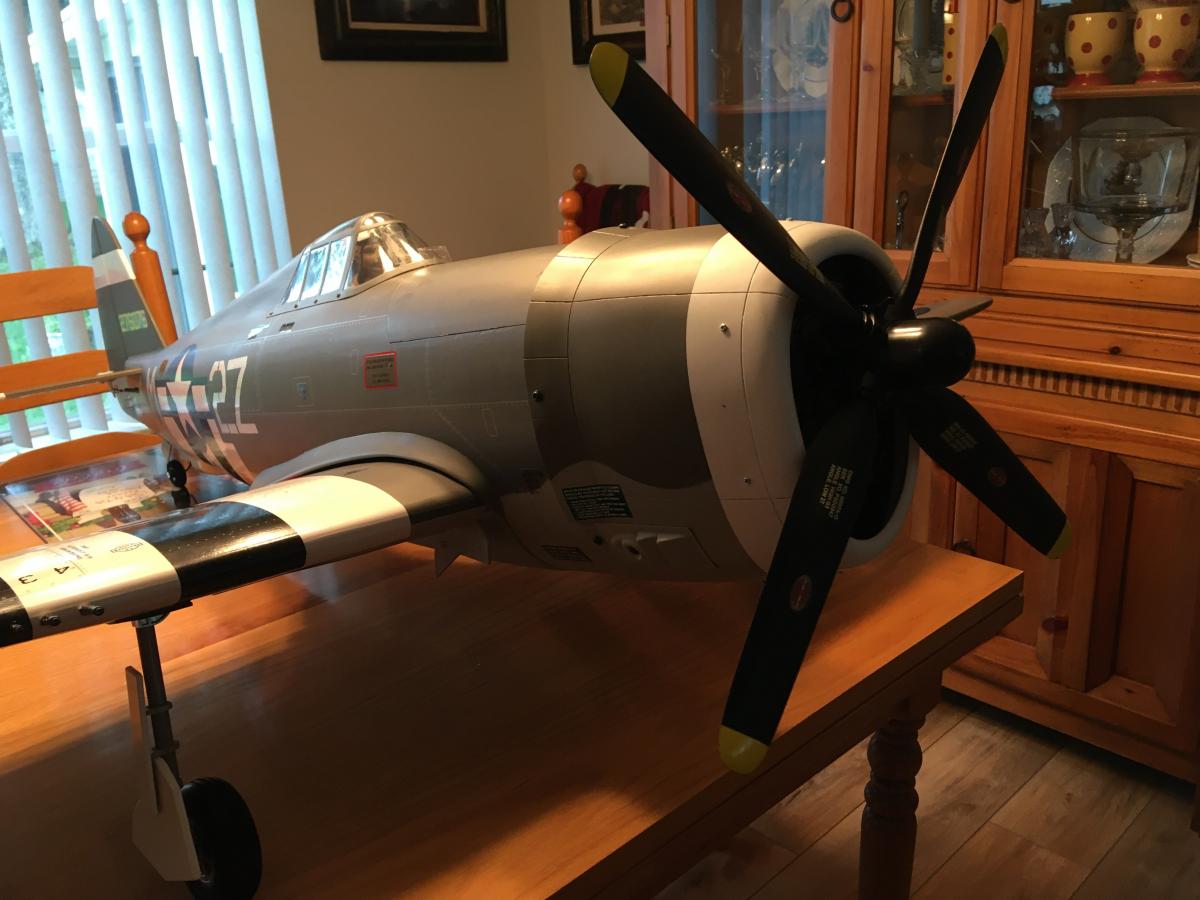

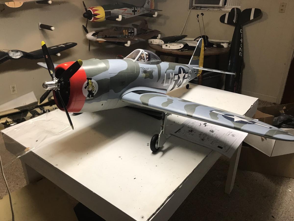

    Belike, Thanks for your interest. Good questions! If you look at the picture on the second entry. I show a photo of the FMS power plant with prop. It is off the 1700mm Corsair. The decals come with the prop from FMS. Come by the Merry Boozer Channel for the maiden.
    Thanks Papa, unfortunately I see that plane has been discontinued and while the blades are available, the hub isn't. I'll keep looking to see what I can find, a P-47 just doesn't look right with a 2 bladed prop.

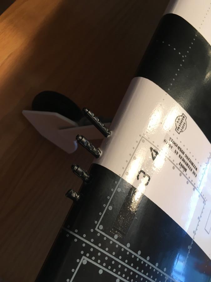

    Have another question, this is my first balsa model so I'm taking it slow to work through things. As I'm inspecting everything it's looking good with 1 small exception. There is a slight warp in the left flap. When I line the left aileron up with the wing tip, then the outer edge of the flap to the aileron, the inside edge of the flap doesn't line up with the back of the wing. It's offset about the thickness of the flap edge. I know how to bend foam to bring it into alignment, but how about balsa? How to I straighten the flap. It's not huge but its enough to bug me.

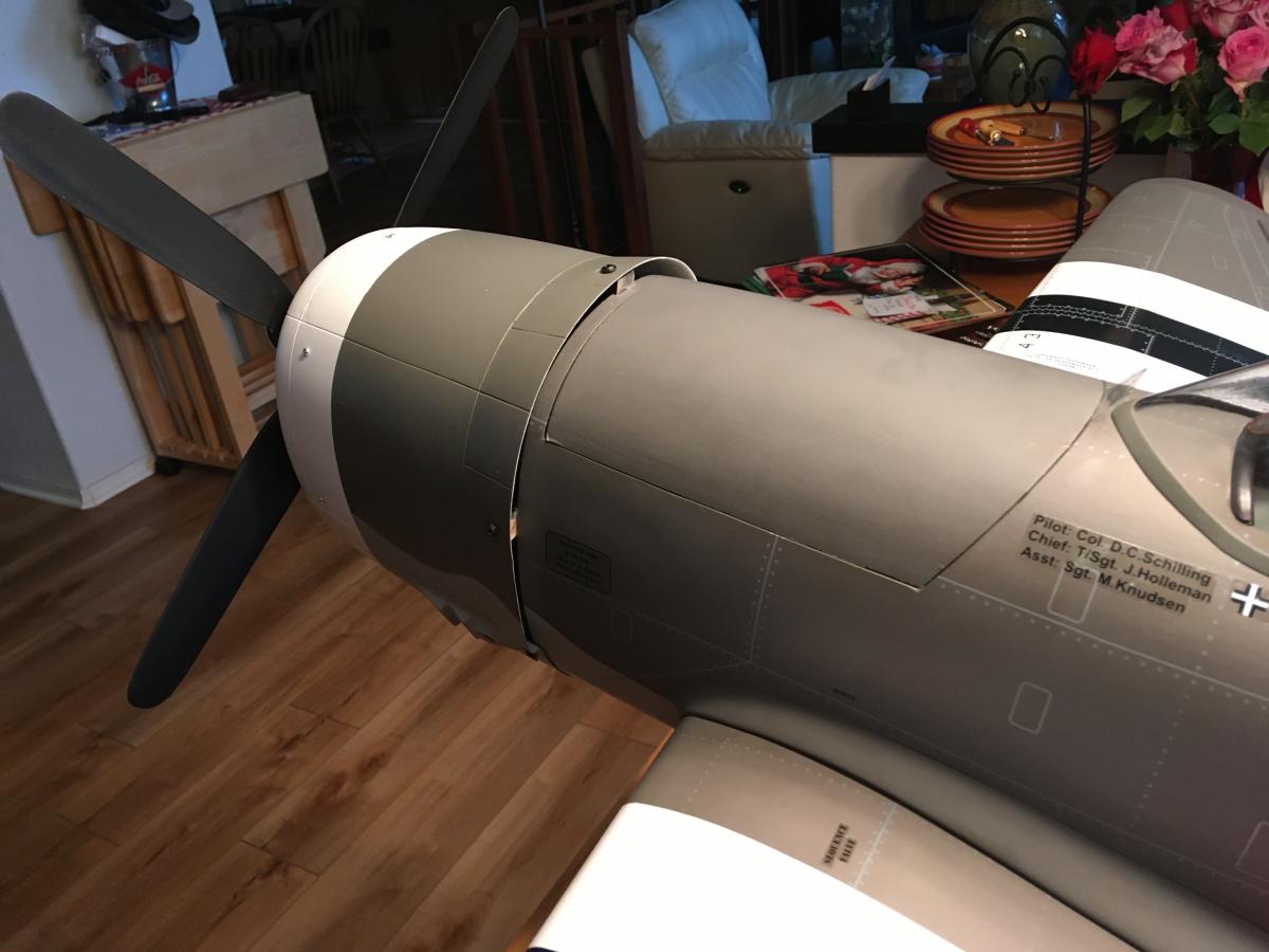

    Rcflyer79, When the wheels were retracted the first time, I did have an issue with the wheels hitting the wing cheating. Fix with a Dremel tool and enlarged the hole. The wheels did not go down all the way, I may have a 1/4" hanging out of the wheel well. For what it would have taken to fix, I will take it. I always, on ARF's Re-glue or CA the firewall, just for safety purposes. Good point, should have noted that in the build. Wing bolt holes were aligned close, all I did was make the holes larger, for a little wiggle room. As stated earlier, used larger head nylon wing bolts. Great point in the Re-glue. Motion must have did so re-design of this plane, with what has been said so far, I do not know this for a fact. Thanks, for your come back! Papa

    Rcflyer79, When the wheels were retracted the first time, I did have an issue with the wheels hitting the wing cheating. Fix with a Dremel tool and enlarged the hole. The wheels did not go down all the way, I may have a 1/4" hanging out of the wheel well. For what it would have taken to fix, I will take it. I always, on ARF's Re-glue or CA the firewall, just for safety purposes. Good point, should have noted that in the build. Wing bolt holes were aligned close, all I did was make the holes larger, for a little wiggle room. As stated earlier, used larger head nylon wing bolts. Great point in the Re-glue. Motion must have did some re-design of this plane, with what has been said so far, I do not know this for a fact. Thanks, for your come back! Papa

    Do your gear doors hang down when the gear is retracted? Mine weren’t even close to closing all the way because of a wing rib in the way that the wheel was hitting. Also my firewall was loose and needed glue too. My wing bolt weren’t even close to lining up and I had to move the spar in the fuse back a half inch in order for them to line up. I used the FMS 1500mm power system in mine. Mine was the bubble top hairless joe camo scheme and I got it over a year ago when they were called VQ and sold out of Texas by VQ warbirds now legend hobby.

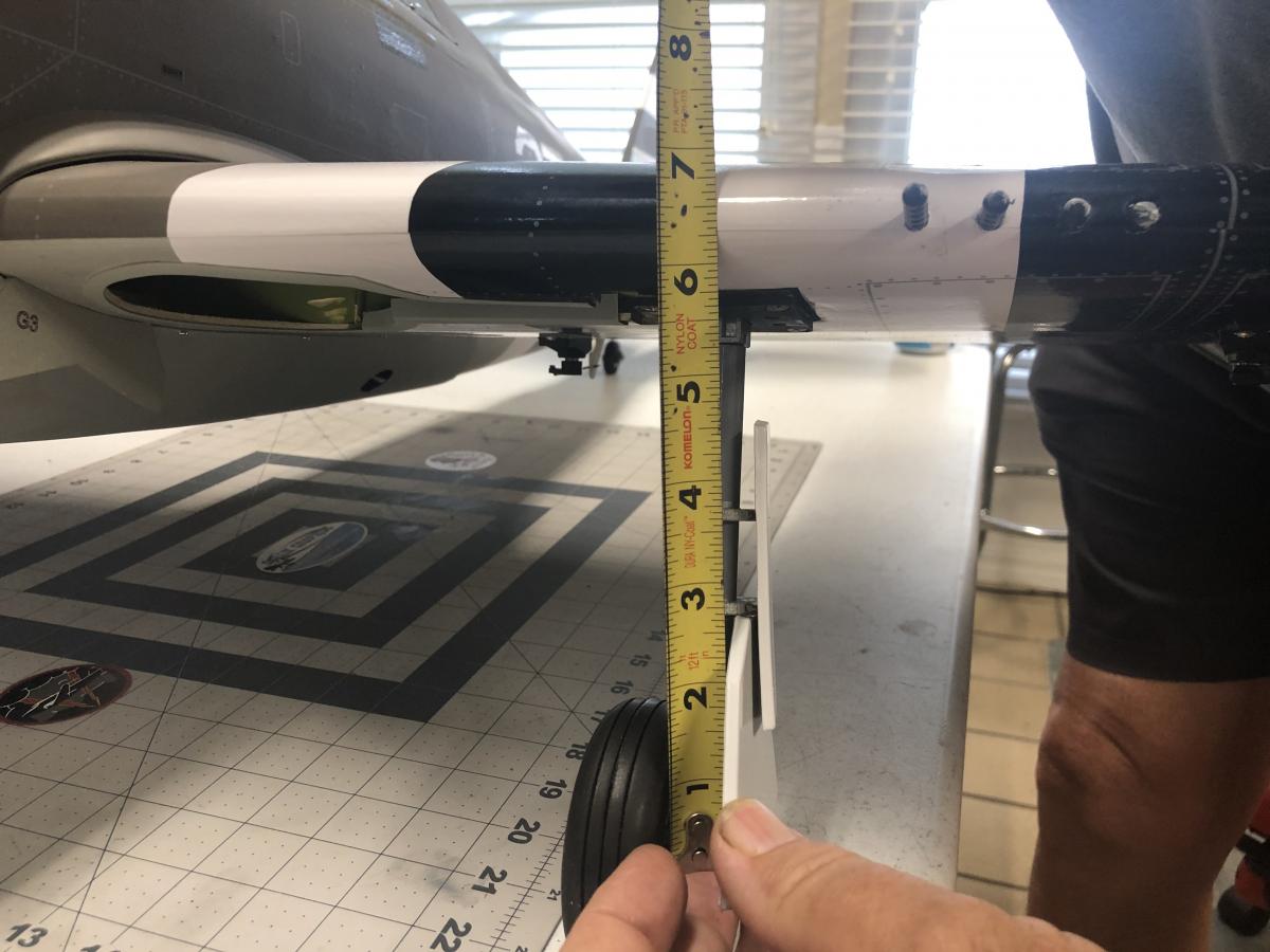

    What is the length of the main gear struts from the top of the strut to the middle of the axel?
    5-7/8 see picture below 😉
