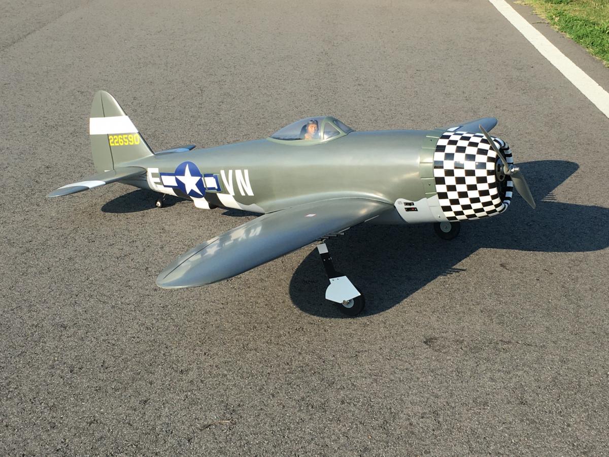

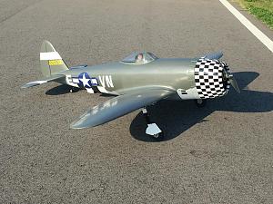

    Evan D, Great looking bird! I also have had some Top Flite models in my day. The last one I built was a sixty size B model Mustang.. This was in the day before Top Flite made ARF's. I remember not being to impressed with the wing design of that model. I rebuilt the wing twice, the last time using foam board in the middle sections with over lapping carbon fiber. This was just to keep the gear from coming out when landing. This was also in the days of air retracts, what a pain. Had a two stroke 91 OS engine, now I am show my age. I still have that bird, and one day, plan on a rebuild. This time making her electric powered, since the P-47 come out so sweet. I know your bird is a great flyer, never seen a bad flying jug. Fair skies and soft landings with her, she is a real lady.
ID:	263983 The P-47 is one of a few warbirds that fly well as a model without changing tail shapes or airfoils. The others are the Zero and Focke Wulf. Hard to go wrong with them. I’m flying my TF P-47 today.
    Congrats on the build and flight MB.
