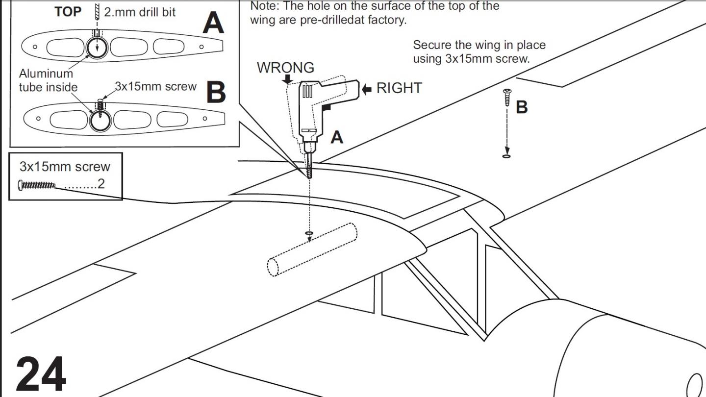

    did you have any problem screwing the self threading 3mm screw into aluminum wing tube ?

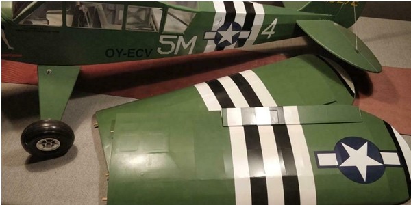

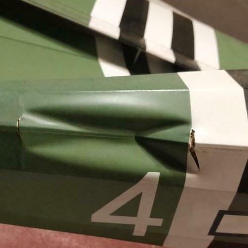

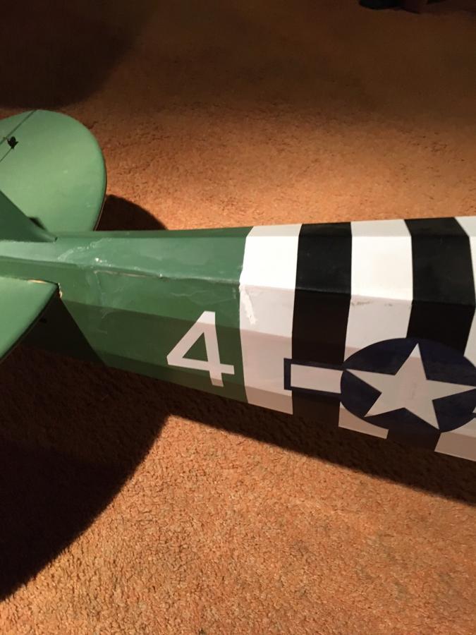

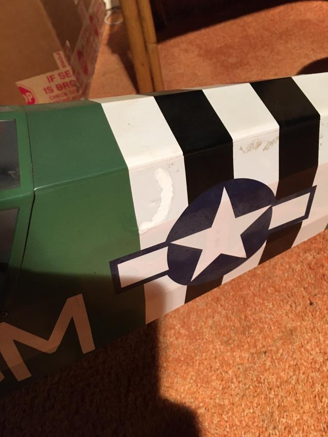

      Bought me this second hand, was not finished completely.
      It had some damage but I repaired it allready.
      It's an easy build, just put the parts together.

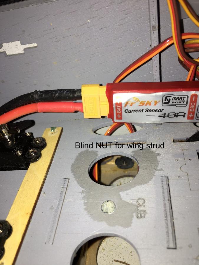

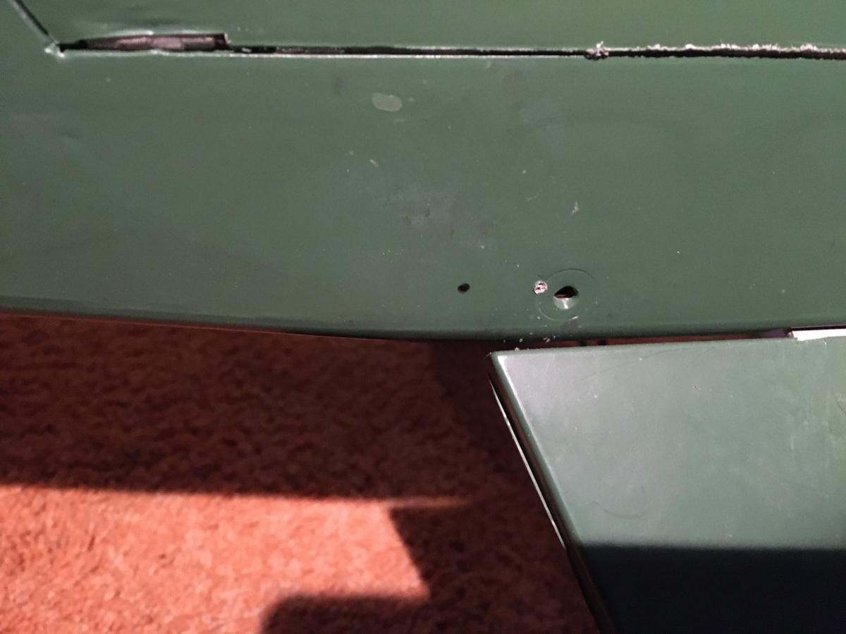

      But I noticed during installing wing struts in manual #26 they say 3*15mm screw, but this is wrong.
      In fuselage there is a blind M3 nut installed and looking at covering in bright light I found where to puncture covering.
      See pics below.

        In manual it's explained very well?

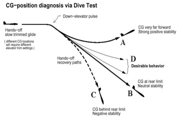

          In manual they say CG is 65-70mm form LE.
          But I have some thoughts about this, I fly a lot of planes.
          But when I fly a plane for the first time, also I fly new planes for fellow club members.
          I always keep the 30% rule from LE in mind as a starting point.
          For this plane wing has a dept of 27cm, so 30% = 81mm.
          Well I will see in first flight with this plane how it will behave in the air.
          For me I test this flying straight in the wind high altitude, throttle to zero and see what the glide path is.
          I want to see a glide path around 30-45 degree.
          A plane with a slight nose heavy CG is good to fly.
          grts Hans Click image for larger version  Name:	CG in flight.jpg Views:	0 Size:	31.0 KB ID:	294325

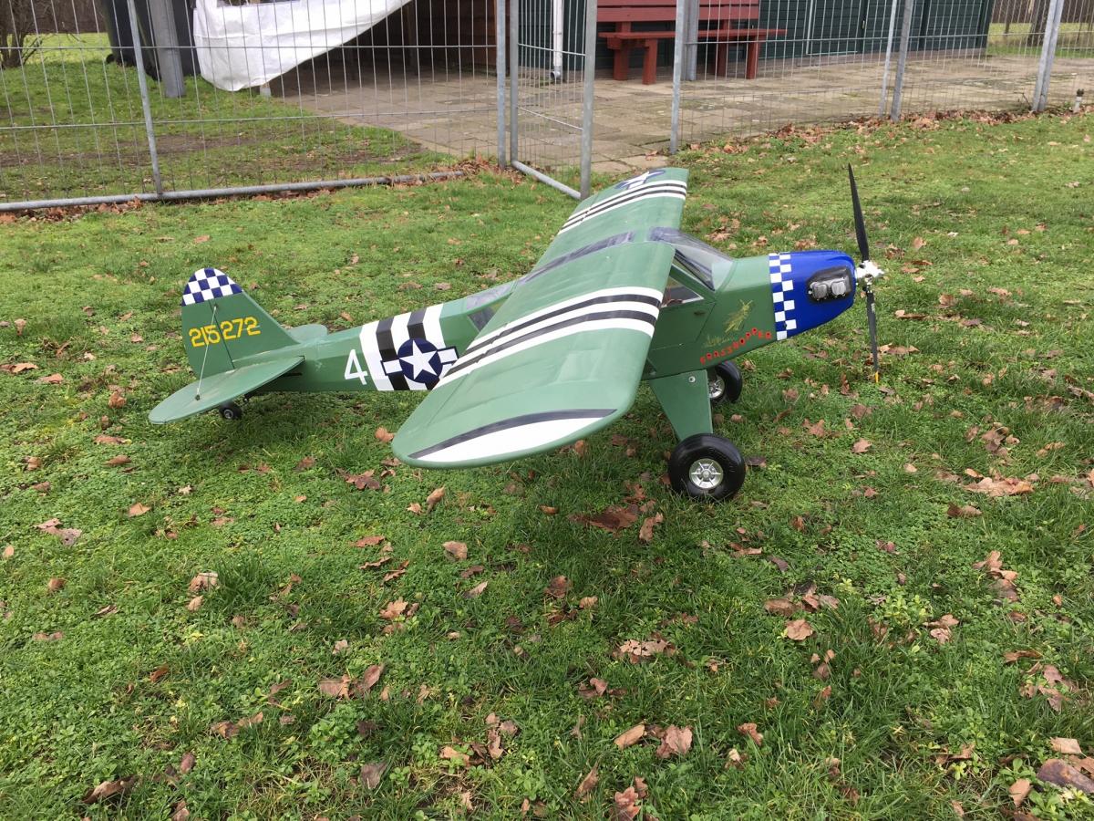

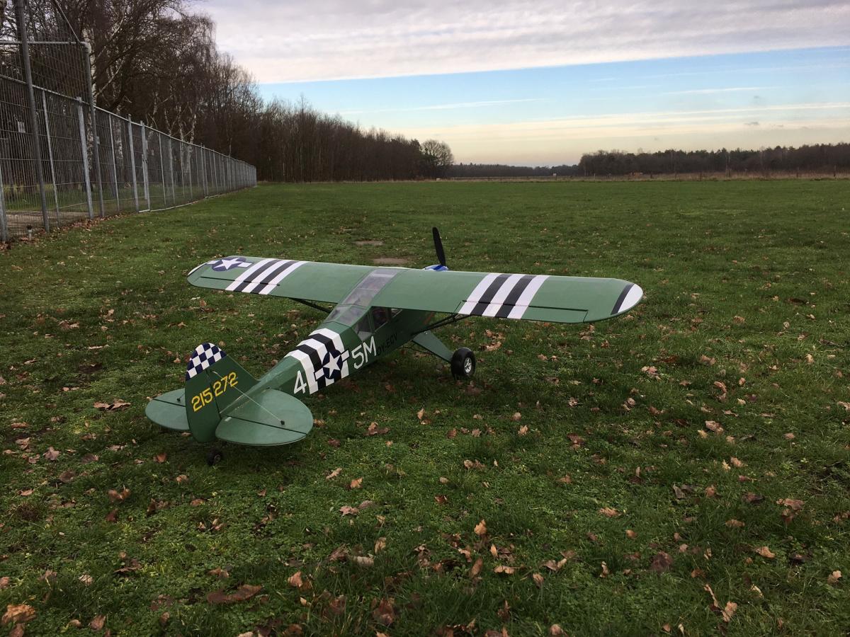

            Today I flew my VQ L4.
            Used an FMS 14X8 and with 6S my telemetry gave me a current max 47A, Voltage 23.6V=1109watt max power.
            Cruising current is between 10-15 amps and reading my watts in flight around 100-150watt.
            It was a bit windy and performed CG in flight test, CG was around 70mm.
            In flight my LIPO moved a bit backwards so I had a plane slightly tail heavy but I could handle it.
            At home I modified my lipo area with a wooden stop for my lipo so it can not move more back for the next flights.
            Hopefully tomorrow it will be less wind so I can trim and balance my plane better.

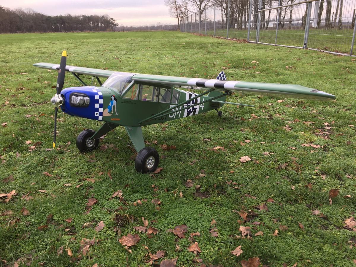

              Update CG
              Flew today, securing my LIPO better than yesterday, CG=75mm and it flew just great.
              Grts Hans
