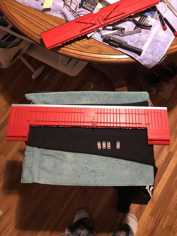

      • Wild Man
        • 526
        • Rapid City, S.D.
        #63
        After the last landing in the grass, the spot landing. I went out to pick it up because of the wind and carry it back to the pickup. I notice one of the hinges hanging out of the Elevator on the left side. When I got it back in the house to take care of the Hinge I noticed when pulling it back to get the hinge back in three more of the hinges were not glued in you can see in the photo so I will have to take the Elevator off and completely rehinge it. when I took it apart I found that none of the hinges were actually glued in and the only thing holding it together was the foam between the horizontal stab and the elevator surface. not good
ID:	311203Click image for larger version

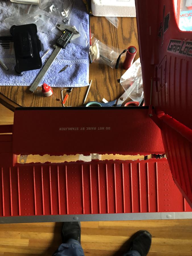

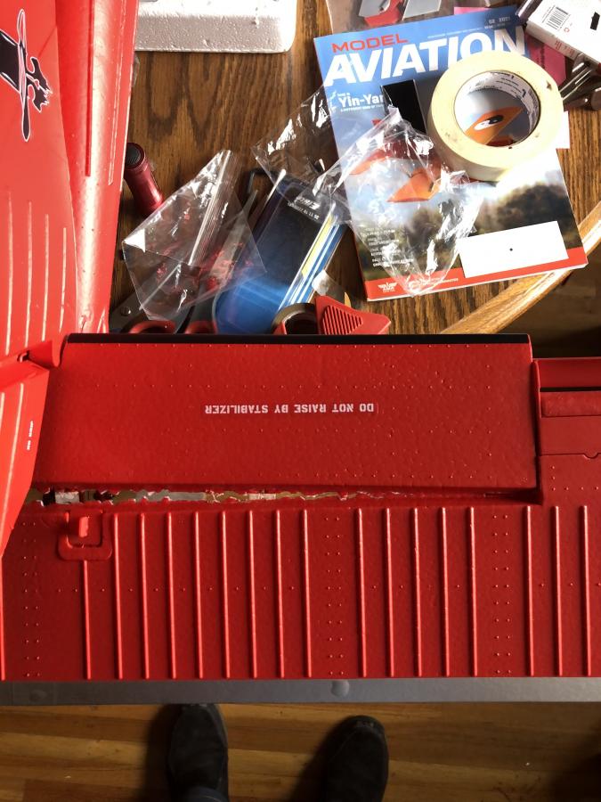

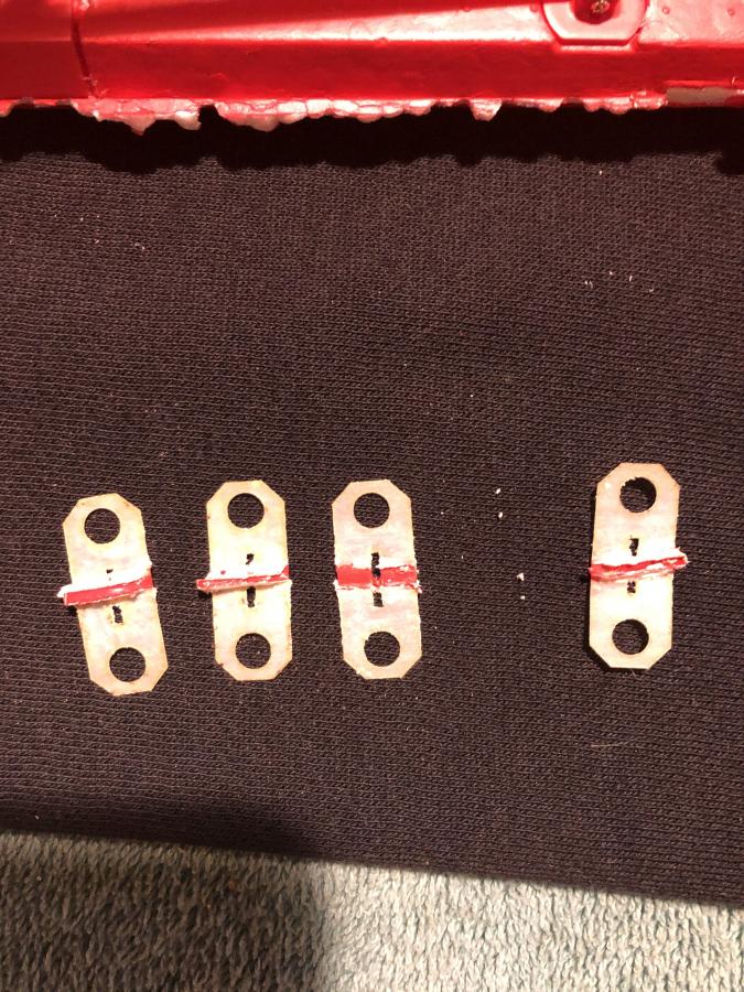

          #64

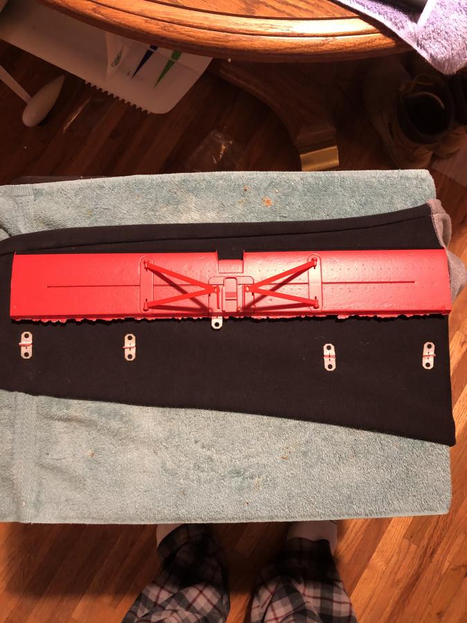

          I am lucky I did not loose this Bird After taking the stab and elevator off the plane. I found four out of the 5 hinges with no glue in the slot, just on the foam in the center and only one hinge was actually holding in the stab I am going to replace the hinges and put hinge tape on too also hinge tape the rudder
ID:	311287Click image for larger version
ID:	311288Click image for larger version

                I will be checking mine when it arrived. Many thanks for the 'heads up' on this fix.

                  Other than the Elevator hinges having almost no glue. I haven't Yet had any problems with the servo's They do specify not to run the travel over 100%. I know my Spektrum Trans will go to 125 but I avoid doing so on any plane. I always stay at the recommended 100% throw, unless other wise stated. When I need more surface throw I change the linkage

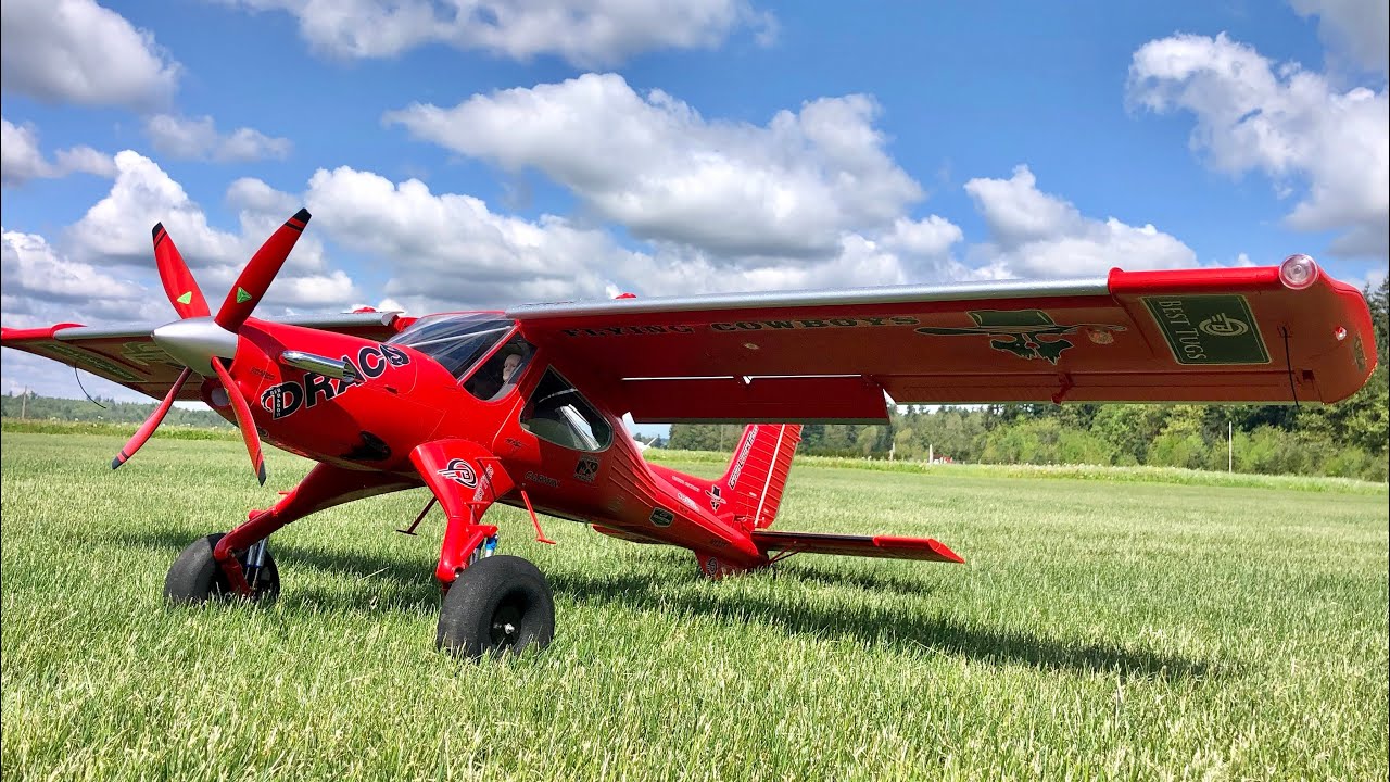

                      heres my maiden

                        About those hinges .................................... What I can't figure out is how can plastic hinges be inserted into what started life as a full length foam hinge?

                                The gear breakage thing has been (so far) directly related to side loading when landing. If you learn to use your rudder (and crab) when landing in a cross wind, you won't have any side loading on the gear.
                                The hinge thing appears to be a very isolated occurrence. When I get mine, I plan to reinforce the glue in those hinges before I fly.

                                    #77
                                    You tell me. Those are the original hinges. I usually use hinge tape on every thing but it looked good. After I rehinge I also used the hinge tape. Have been back to flying the Draco. The reverse thrust option an Awesome addition to any plane I also have reverse thrust on my E-Flite 2.1 Cessna 150

                                        When I get mine, hopefully in about 2 weeks, I'll inspect all the hinges carefully. I may reinforce them anyway with either a "hot glue hinge" or a "FoamTac hinge". You can see the hot glue hinge done in one of Flite Test's YouTube videos. Those hinges, I think, are a bit stronger than a hinge tape hinge.

                                          #80
                                          I am not talking about hinge tape hinges. I replaced the original hinges with pined hinges in the same slots, Then put hinge tape on
