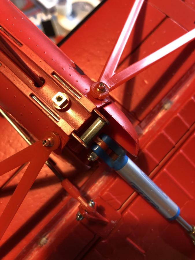

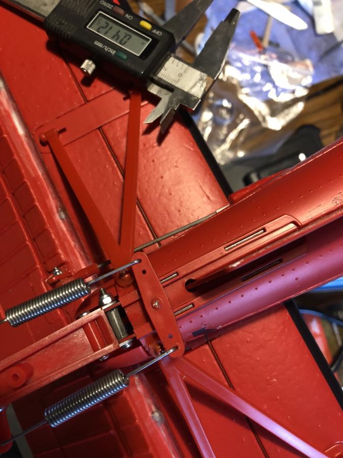

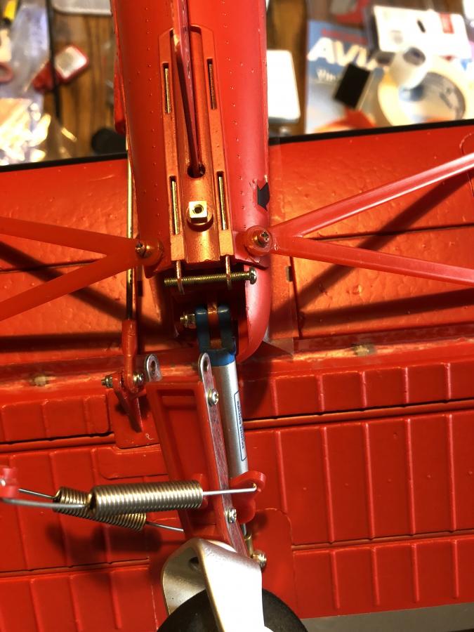

                  I am going to do the same xviper, as soon as my replacement stabilizer and strut assembly gets here. Xviper here is another update I have done on the tail wheel assembly. The sliding bars had a little glue on them that I removed, and after many, many touch and goes and reversing the thrust to stop it the tail wheel assembly was flopping from side to side I found that the sliding bars that the tail wheel assembly attaches to were bending together and the holes drilled in the bars are larger then the mounting screw so I made a carbon tube spacer to put between the two sliding bars in the fuse. Now the tail wheel is very tight and does not flop at all and the steering is much better

                    The Horizon rep on the other forum finally said that those 2 metal sliders should not move in any way. In fact, they should be held firm. For some reason, they figured that the paint would be enough to hold them from sliding. Many of the guys that have this plane, have now glued those sliders completely solid. I'm going to squeeze FoamTac or hot glue down into those slots that we see the metal sliders through. Epoxy may be too permanent. There may be a reason in the future to remove those sliders to do any repair or maintenance work.

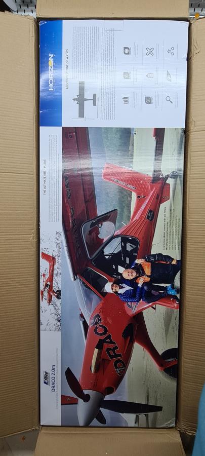

                      Hello People, i just received the long waited DRACO. today i will start the series of the unboxing and assembly, also suggestions in case i think are needed. I hope to do the maiden next Sunday, may 23rd. Click image for larger version

                        You're gonna have some fun! So, Chris from The RC Geek (great youtube channel) suggested replacing the stock wheels with Dubro 5.5" inflatable tires. The stock wheels make for pretty bouncy landings. I got the Du-bro's and it makes a world of difference. But... I think the 5.5" are just a tad too big. Flying without air in them as Chris suggested but they can tend to rub against the shocks as there isn't much clearance. And, the tires will pump up a bit of its warm out...especially on pavement. So, I just ordered the 5" tires. Should give some more clearance.
                        they are heavier than the stock but they really don't effect CG. They actually help getting her down with full flaps! She'll just float with a head wind lol. Maybe lose 60 seconds or so of battery time but totally worth it. I was getting 12-14 mins of mixed flying on a 6s 6000.
                        have fun man. She flies amazingly. Horizon really stepped it up on this one!

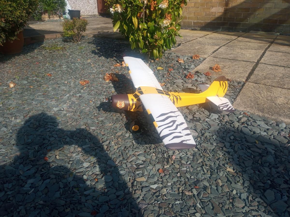

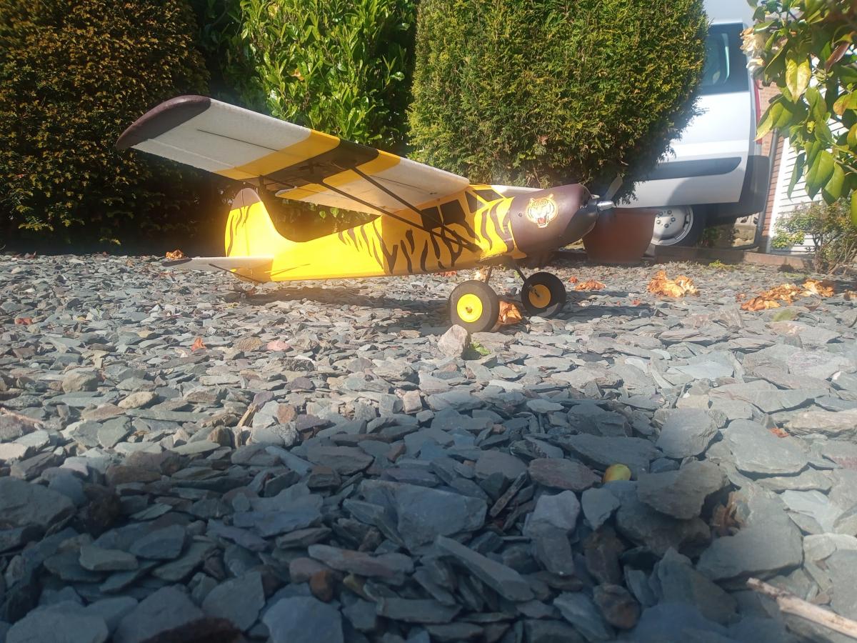

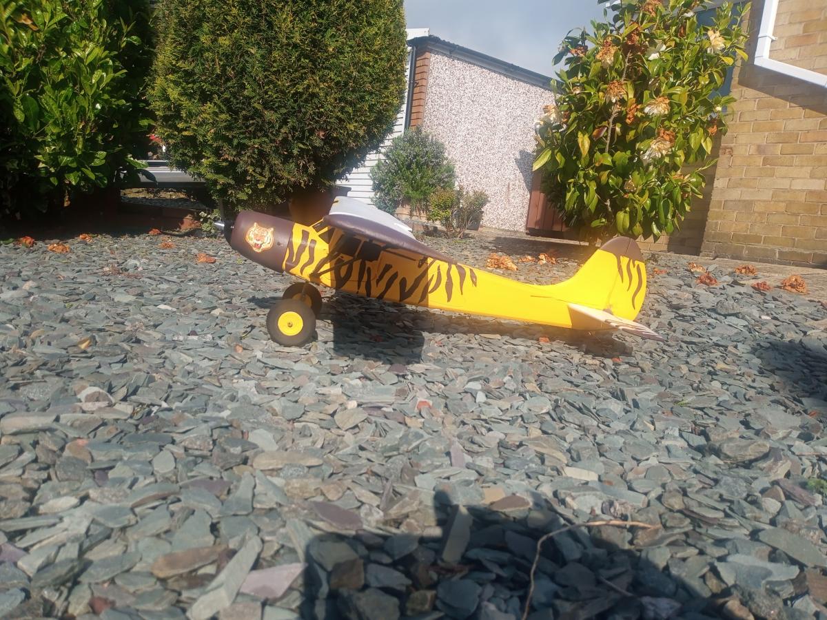

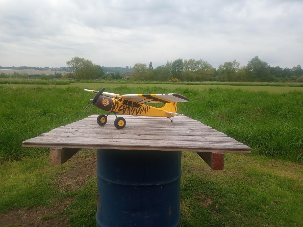

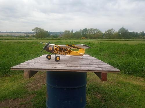

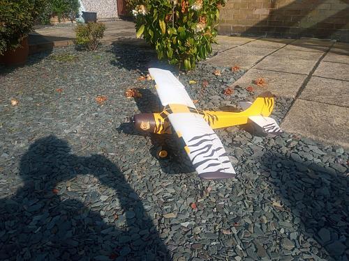

                                The Draco is very nice, its also £500 so I got to thinking about the old STOL plane which I bought for £30 in 2014 but the years in the loft had not been too kind with a broken elevator, weak landing gear and broken motor cowl. The white epo and blue stickers and faded numbers and markings did not help so I splashed out on a new propeller, new hinges, a bit of wire for the landing gear and raided the paint store so I now have an almost new bush plane with almost sofisticated landing gear and a new lease of life. The sofisticated 2 position flaps ( run off the one servo of course ) give great STOL characteristics when mixed with 10% down elevator and it loops, rolls, stall turns, bunts and stands almost still flying into a light wind. No expense was spared to create this fantastic model ( £3.50p to be precise ) A massive 210watts of power blast this 585gm monster into the sky using an impressive 2830 1000kv out runner with a 10x8 jxf prop fed by a 1000mah 3s lipo lasting 4.5mins per flight. Battery access is via the state of the art door handle on the port side of the plane. Horizon must be shaking in their boots

                                  Very Nice Paul, you now I Love the Tiger!
