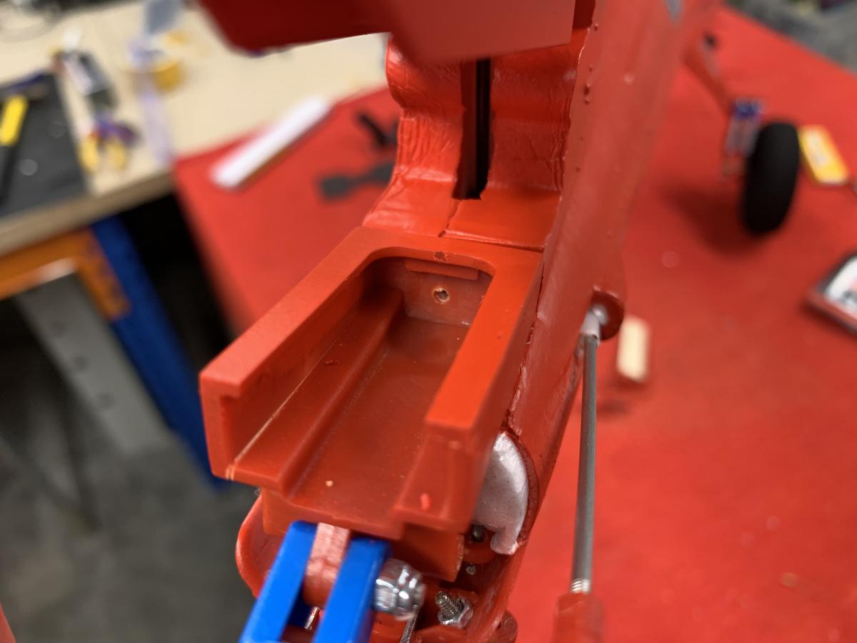

                                      Ok, damage report after hitting the fence.
                                      Elevator receiver split. A little CA and 2x M2x30mm screws with locknuts from left to right are keeping things together now.

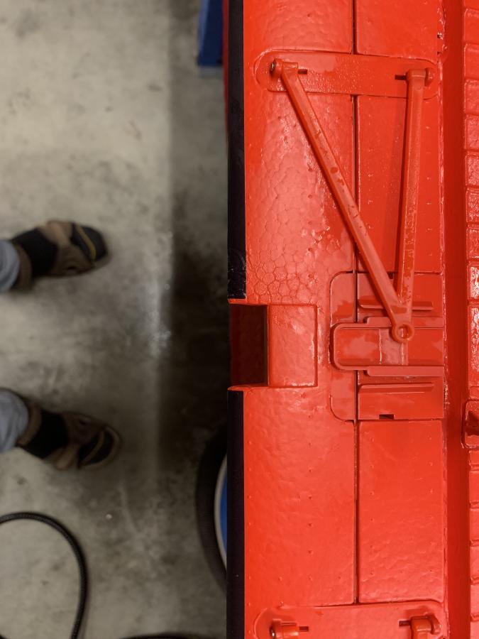

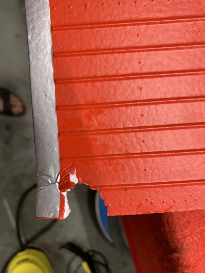

                                      Elevator is missing a chunk, missing piece "re-expanded" and glued back into place.
                                      Elevator alignment cut-out widened. Re-expanded for tight fit.

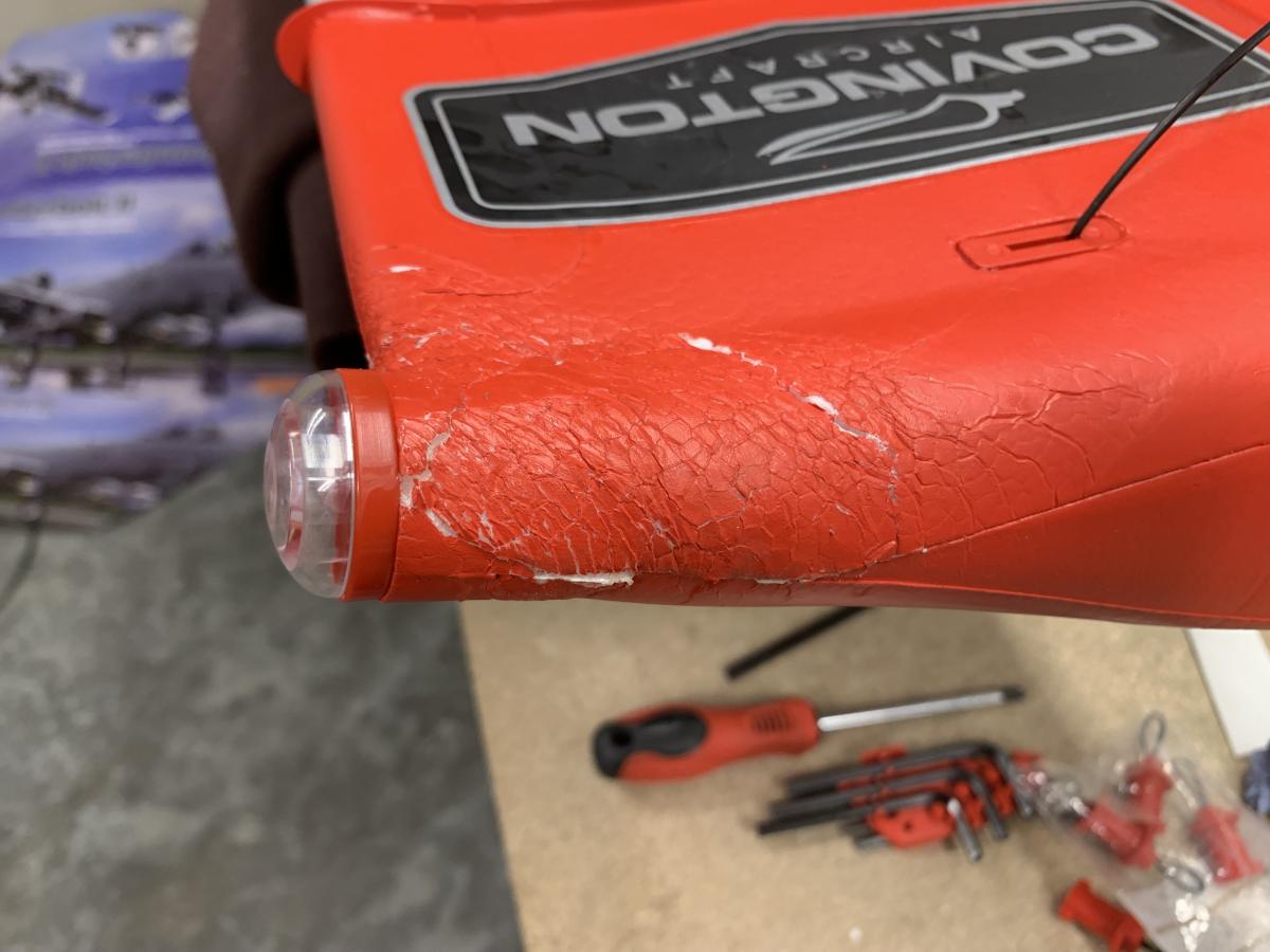

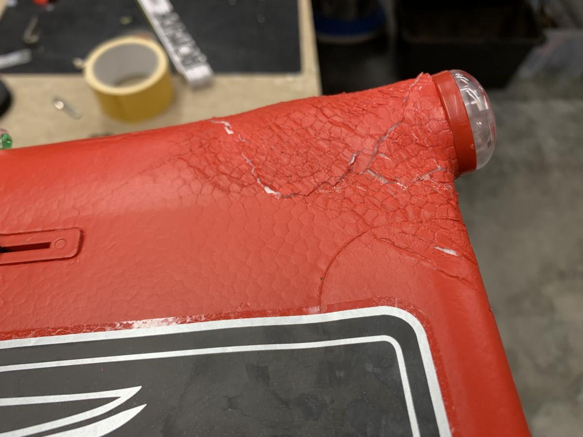

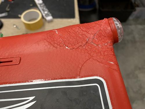

                                      Wing tip light was torn out. Re-expanded some parts to make them fit again.

                                      And oh yes, I got myself a little steam cleaner (Kärcher SC3) to re-expand the foam where it was dented. That's a fun activity! The foam doesn't even gator that much.
