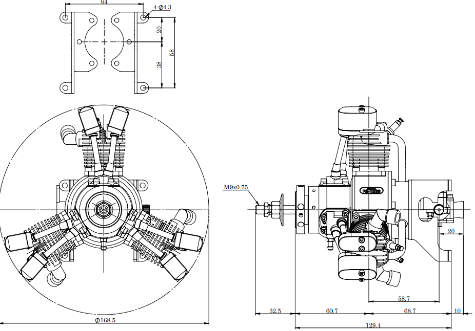

                                          I just ordered the Nexa Hellcat. I wish it was bigger, but I love the covering and scheme. I am trying to find the right powerplant, but I cannot find the dimensions of the cowling. It says the clearance from the firewall to the prop is 106-108mm, yet the engine that MotionRC recommends (NGH 17cc) has a 113mm distance. Someone put a Saito FG11 in theirs and it fit perfectly at 115mm...and this leaves no room between the engine and the firewall! Some of these airplane plans are so frustrating! I am actually looking at the FG19-R3, but the clearance is 130mm, with a radius of 169mm (6.7inches). Plus it weighs a lot more than the NGH 17. Captains RC has a great video of it with the FG-11 here: https://www.youtube.com/watch?v=Gf9xj0tNbZw and says that a 14 would probably work very well in it. I love his exhaust mod that he does and will probably do it. You can see kind of what is done here: https://www.youtube.com/watch?v=OeVZMG_gbQo. If the R3 won't work (which I doubt it will), then I will go with a 14 if I can find one. I am ordering the E-Flite 25-46 100deg retracts. What do ya'll suggest? My previous experience is my DLE-20 Phoenix Corsair, Dynaflite PT-19 with a DLE35RA, and my TF P51 with a DLE55RA (not completed). I had these planes equipped with engines recommended from friends and I am still trying to learn what is best for what. I have lots of electric experience, but I want to use gas in my warbirds.
                                          Click image for larger version  Name:	Saito FG19R3 Size Drawing.png Views:	0 Size:	167.2 KB ID:	315369
