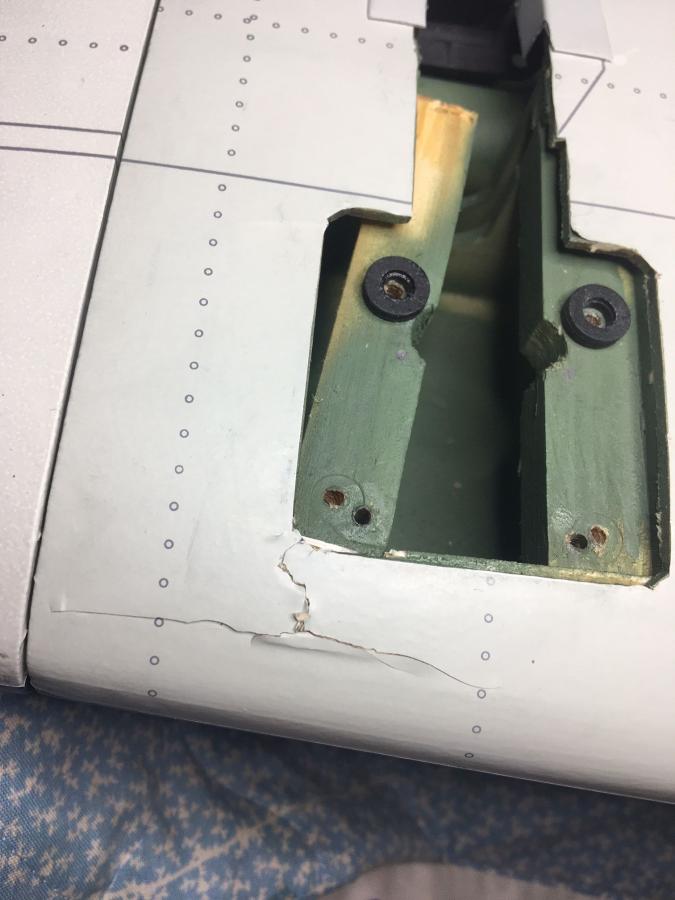

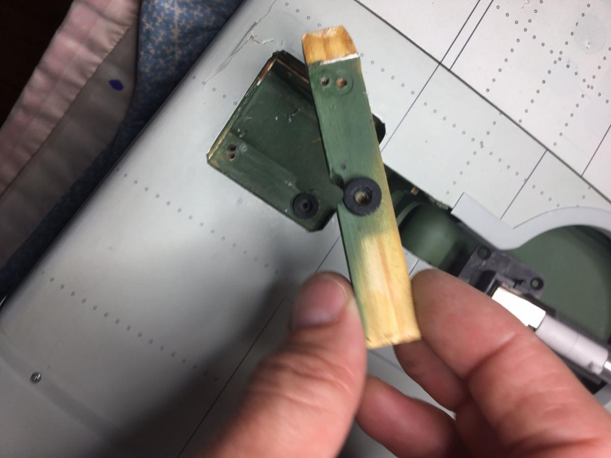

            Finally got mine off the ground yesterday!
            The maiden was smooth, but the week before while testing ground handling I broke one of the braces for the landing gear (pics included).

              Well I have about 25 flights on her now with the Flightline retracts holding up very well. In my previous post I showed the landing gear brace having broken off on the left wing. After gluing it back in with epoxy, The same exact thing happened to the left wing. So if you haven't already, probably good preventative measure to add some glue to those braces.

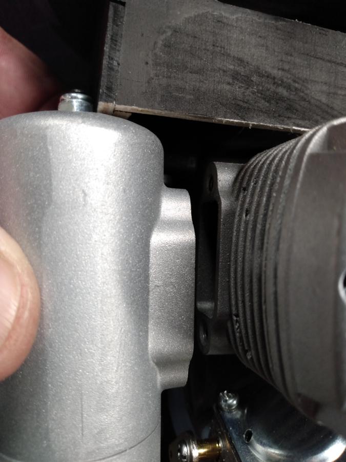

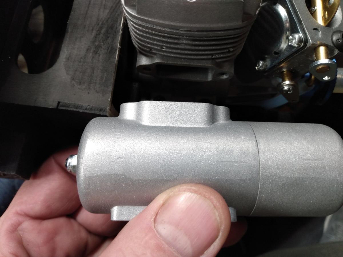

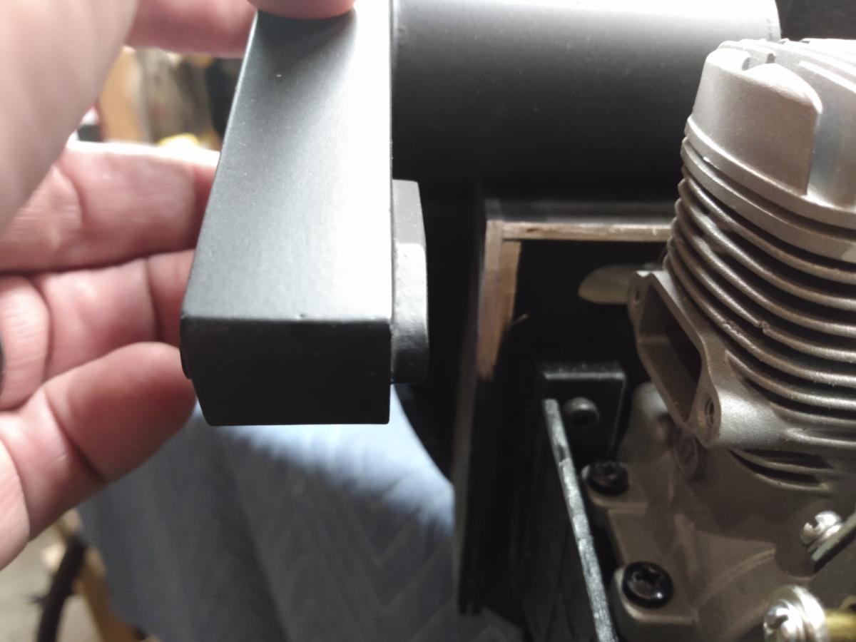

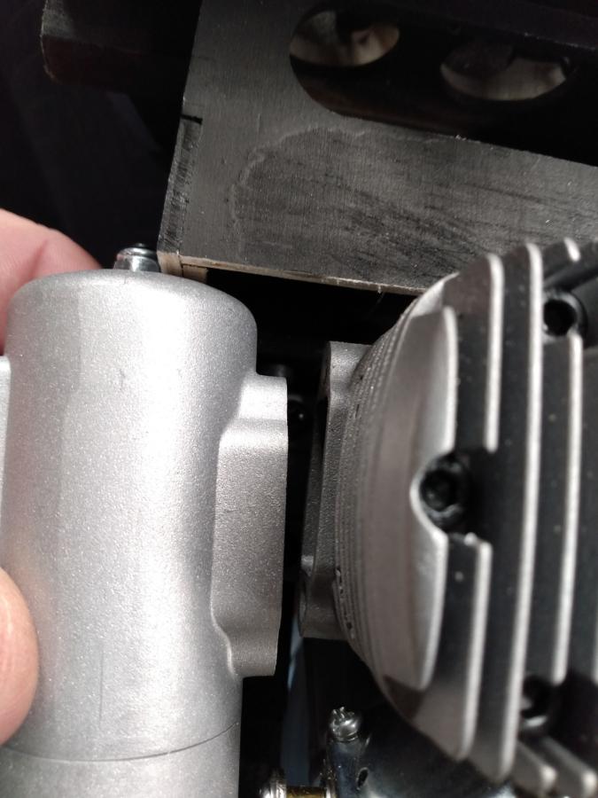

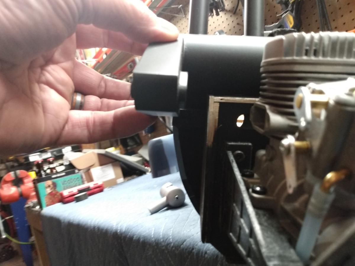

                      Hello to all, My name is Don.
                      I bought a Nexa F6F about a year ago and am just getting around to getting it built. I have already emailed tech support over at Motion RC, but figured I would ask here also on this specific thread. I see that one member, "James" one of the Admins had to do some chopping on the engine mount box to clear the stock muffler with the NGH 17 engine ( I think that is what he has, that IS what I have) . How has that held up? any issues with structural weakening? Have any of you put on one of the Pitts type mufflers? if so, how did you do it?
                      Another question that I have is for set up with the NGH engine; I have never had a gas engine before and am curious about connections, wiring etc, for set up. The instructions that came with the engine do not cover any of the installation and connections. (Or I missed it and/or did not get them)
                      Thank you very much in advance for any assistance with my questions and (Minor) issues, I very much appreciate it, and look forward to responses..... I hope.. :-)

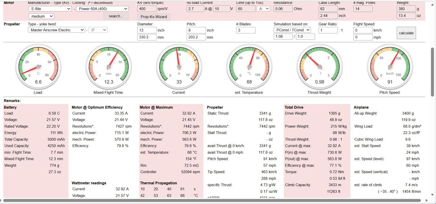

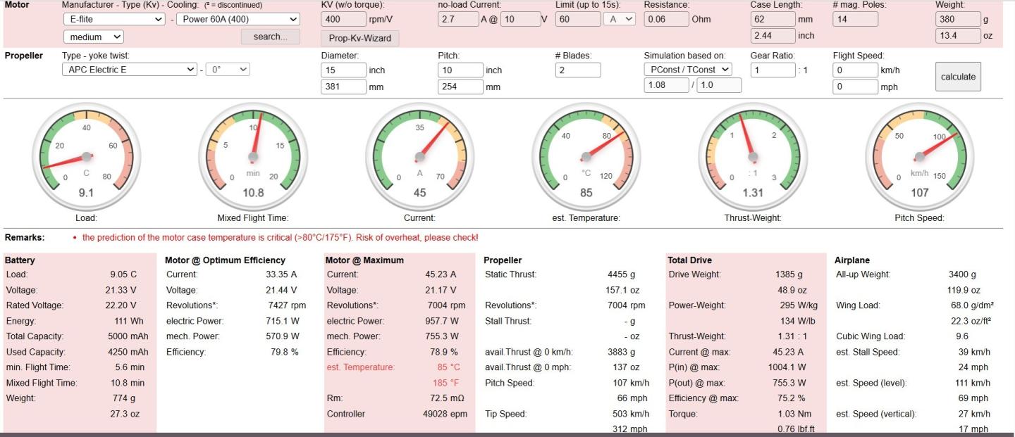

                              Has anyone found a better electric motor for this plane? The suggested motor even on 6s is not cutting it for me
                              • #75
                                Is this the Admiral 5030 400 kv motor? What prop are you using?
                                • #76
                                  Yes, running a 3 blade 13x8 MAS
                                  • #77

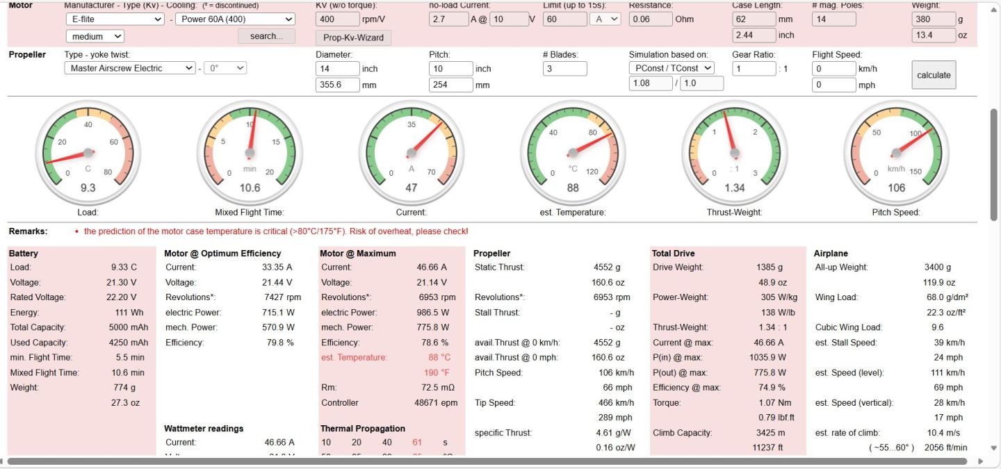

                                    Well, I see your problem, it's not the motor. The KV of the motor, prop and cell count of the battery work as a set. A 13x8 is just enough for scale flight. If you want some more speed and vertical performance, put an APC 15x10e on there, less than $10 or you could put a 14x10 3 blade elec Mas for $20. You could put a higher kv motor in the plane, but that's a more expensive option and unnecessary as you are well below you max current. I'm attaching ecals runs for your plane, assuming a 7.5 lb weight. ecalcs doesn't have Admirals in their data base, but I selected an eflite 400 kv motor to run the numbers. You will get about 25% more performance with either option. The 15x10e is going have the best performance overall.
                                    • #78
                                      Thank you. I will give that a try
                                      • #79
                                        Thank you, I will give that a try
                                        • #80
                                          I used the E-Flite T-28 2.0 prop and it woke her up for sure. Thanks for the input guys
