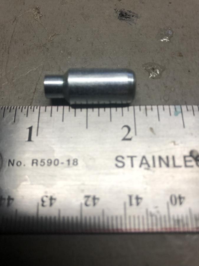

        OK I added weight to the plane to correct the CG
        I have a picture here of what I use it’s a RC part I found in my hobby room it weighs 8 g and I placed it in the nose next to the propeller as far out in front as I could without touching the prop
        It helped quite a bit but we shouldn’t have to be adding this much weight to airplanes we buy that are ready to go
        I may have to add a couple grams more because it is still a little nose light
