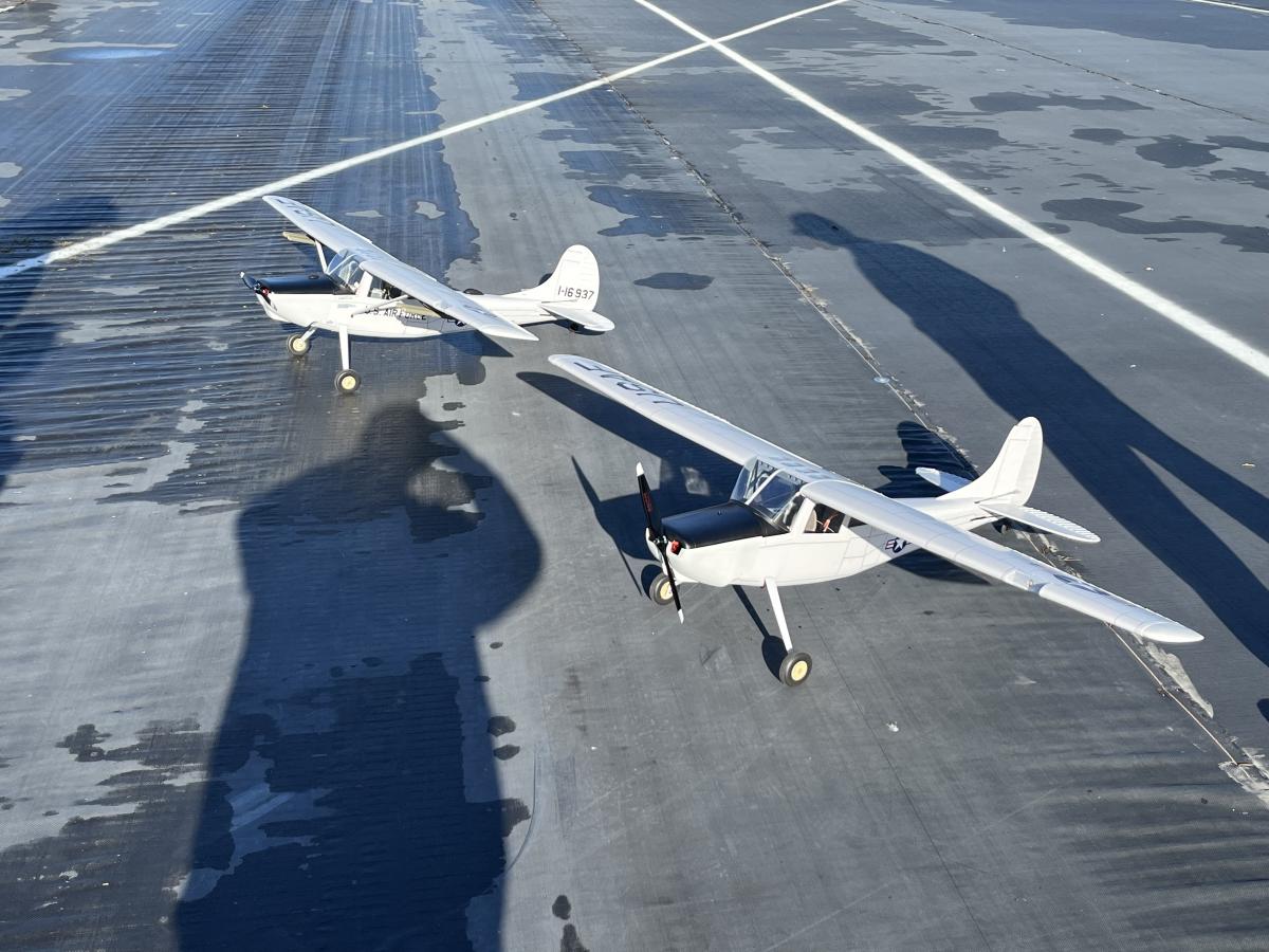

          My old Bird Dog

                            Just finished up my L-19 and I noticed several problems. The motor specified kv rating is 400kv which shows a prop speed of 42 mph. Which seems low. I haven’t seen any flight reports with this motor installed. The other thing I found is that the wing strut attach holes are too far out which the fuselage strut attach point is incorrect. When I balanced the model she needed 8 oz of weight. So I modified the motor mounts to move the battery forward into the dead space between the firewall and motor mount. Now I only had to add 4 oz to balance. The motor I used used (Bad Ass 3530-700kv) touches the cowl beneath the motor for which had to be clearanced out so the motor won’t rub. Maiden flight is this weekend.

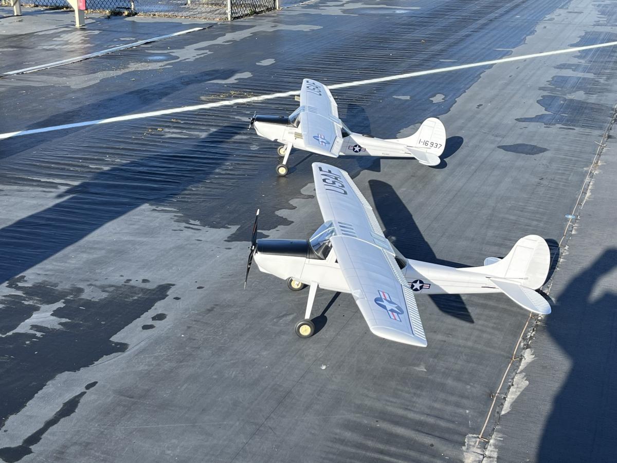

                                We test flew both Bird Dogs and didn’t have the outcome we hoped for. Both models are very squirrelly on the ground. The tracking sucks on smooth surface. The first in took 4 or 5 tries to get airborne. Mine was just the same but the result was a stall on take off as the p-factor took it hard left. Had to try to horse it off and it snapped to the right. Took the nose off. We put some toe in on the first one with no improvement. Finally tried to get the tail up immediately and had much better results for take off. Otherwise it flies fine once you can get it in the air! I am going to take my gear and shorten it 1” and put it on the other one to see if that will help.

                                      No, it’s not the wheels. We believe the gear is too tall. When you have a tall gear, the p-factor is much more pronounced when sitting in a 3-point attitude. Once the tail cones up, it’s much better. I going to rework the gear off the wrecked one to shorten the gear by 1 inch. It should improve the handling. We will see if any improvement this weekend
