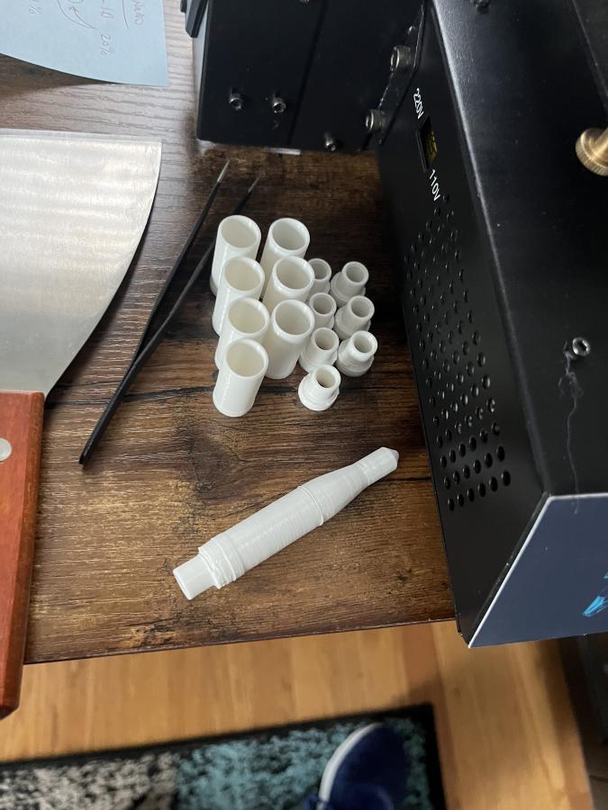

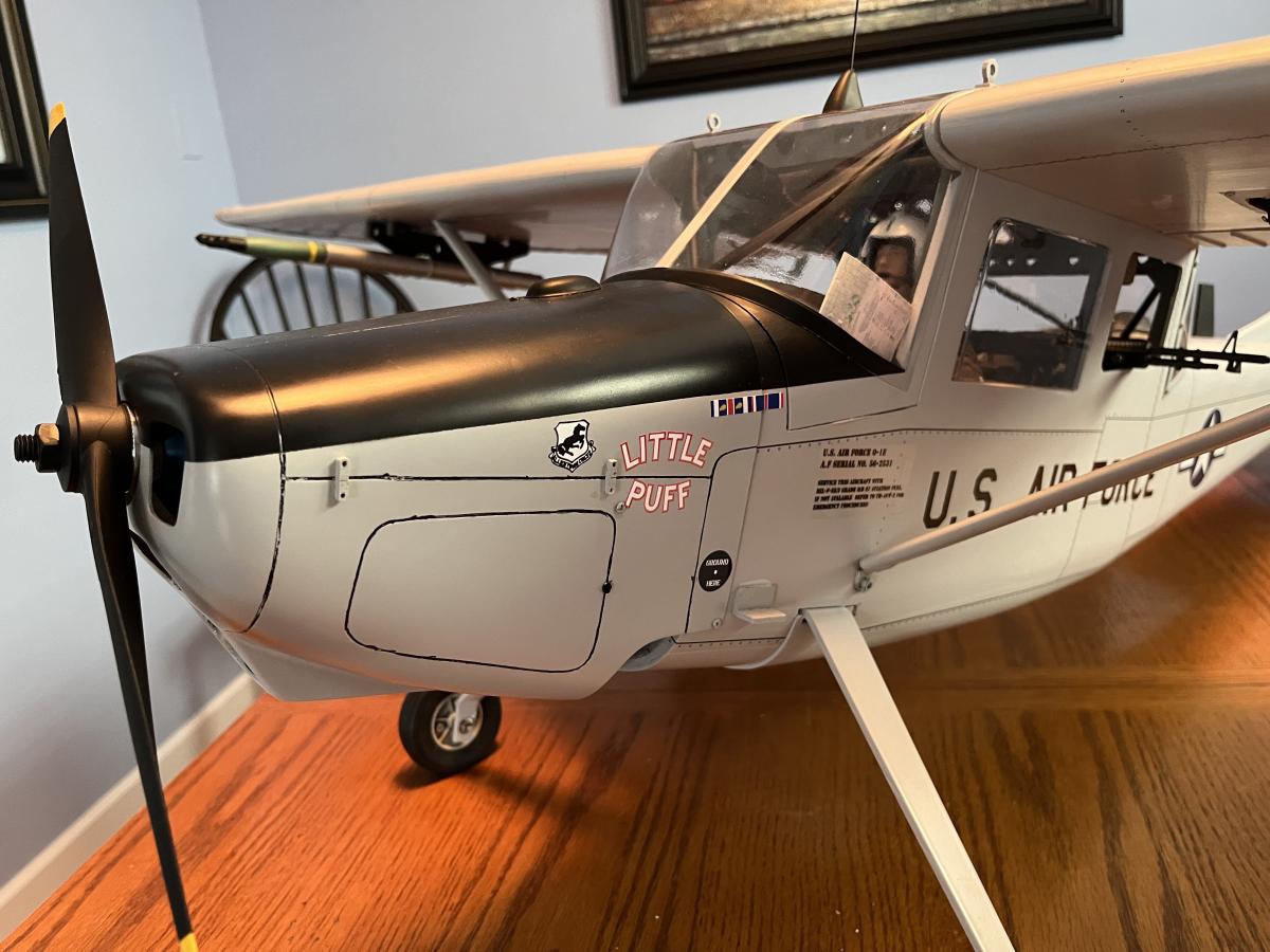

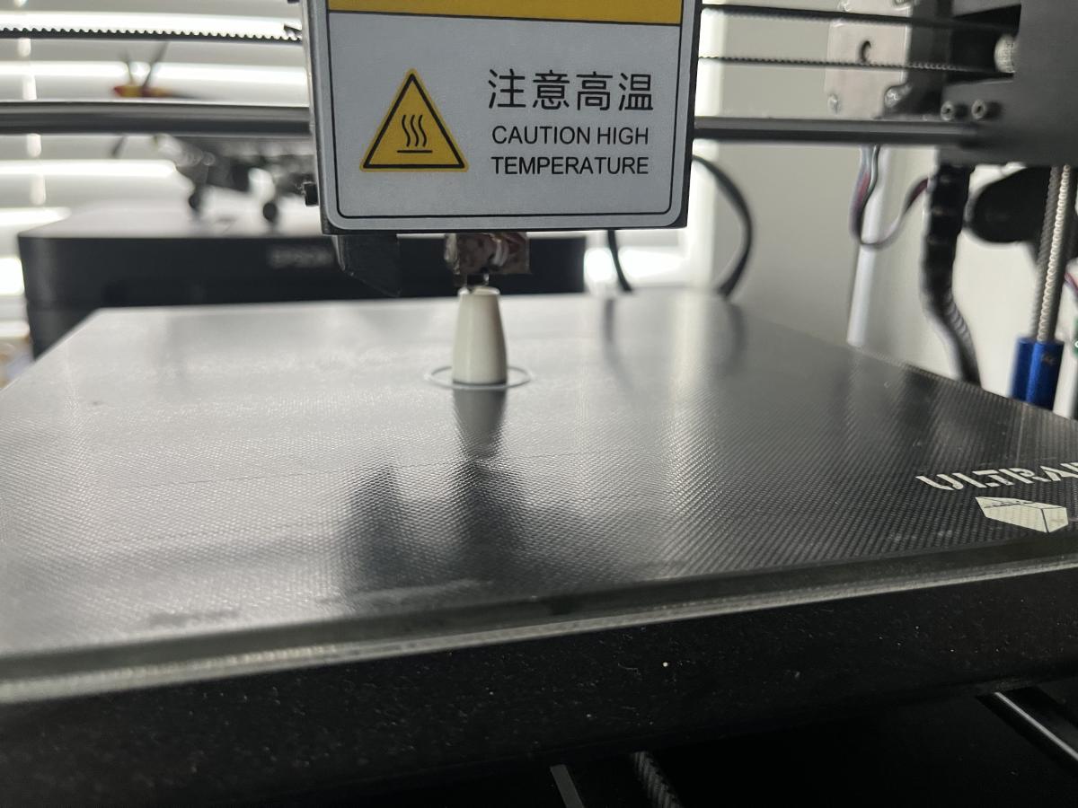

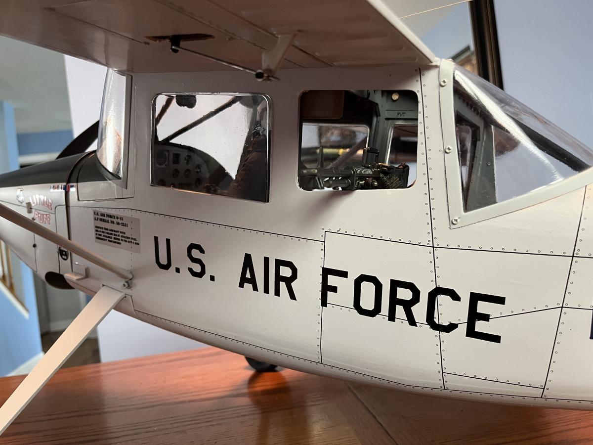

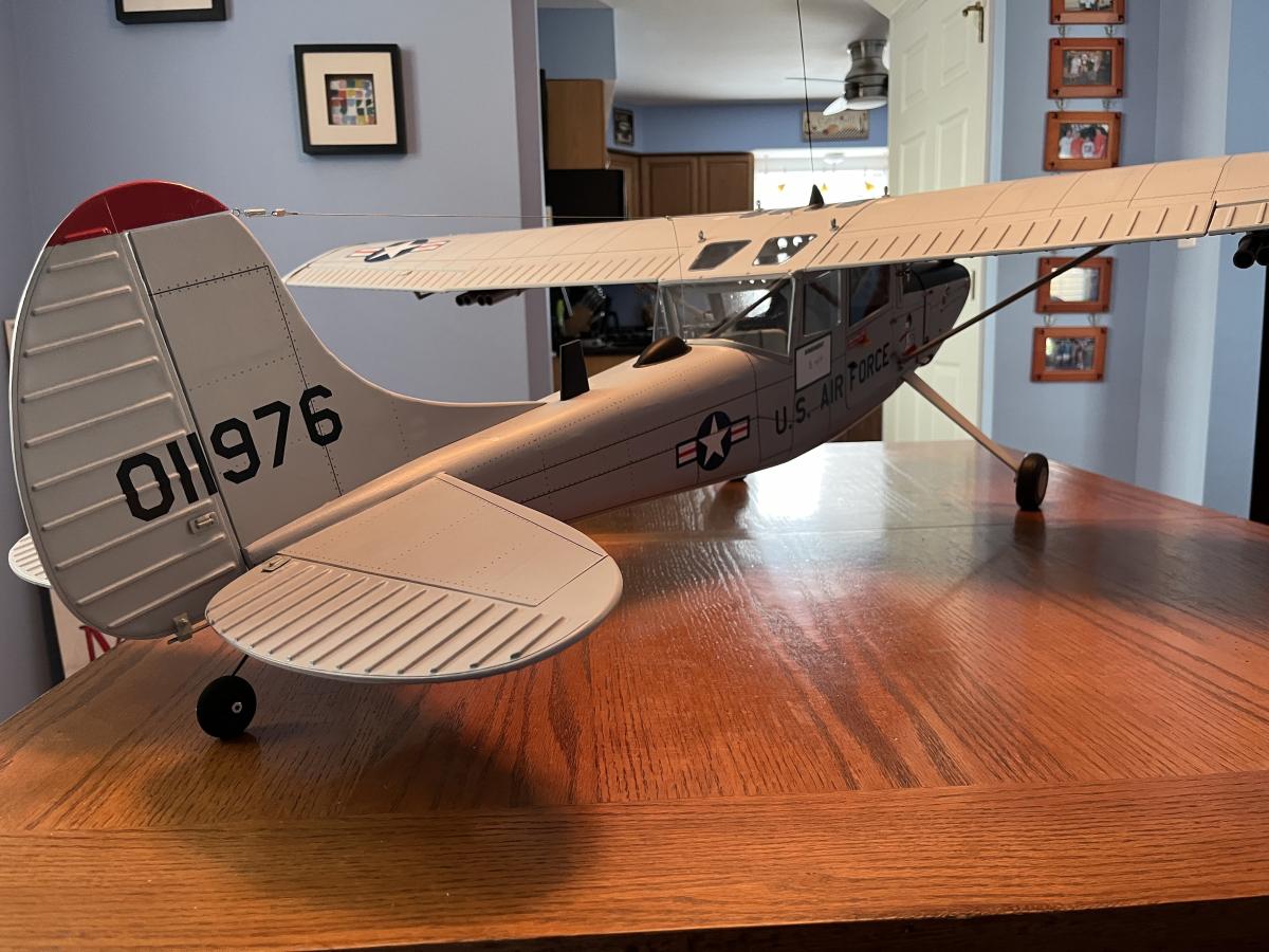

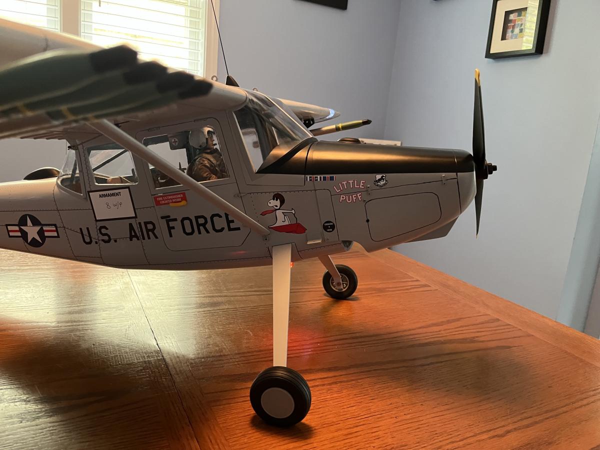

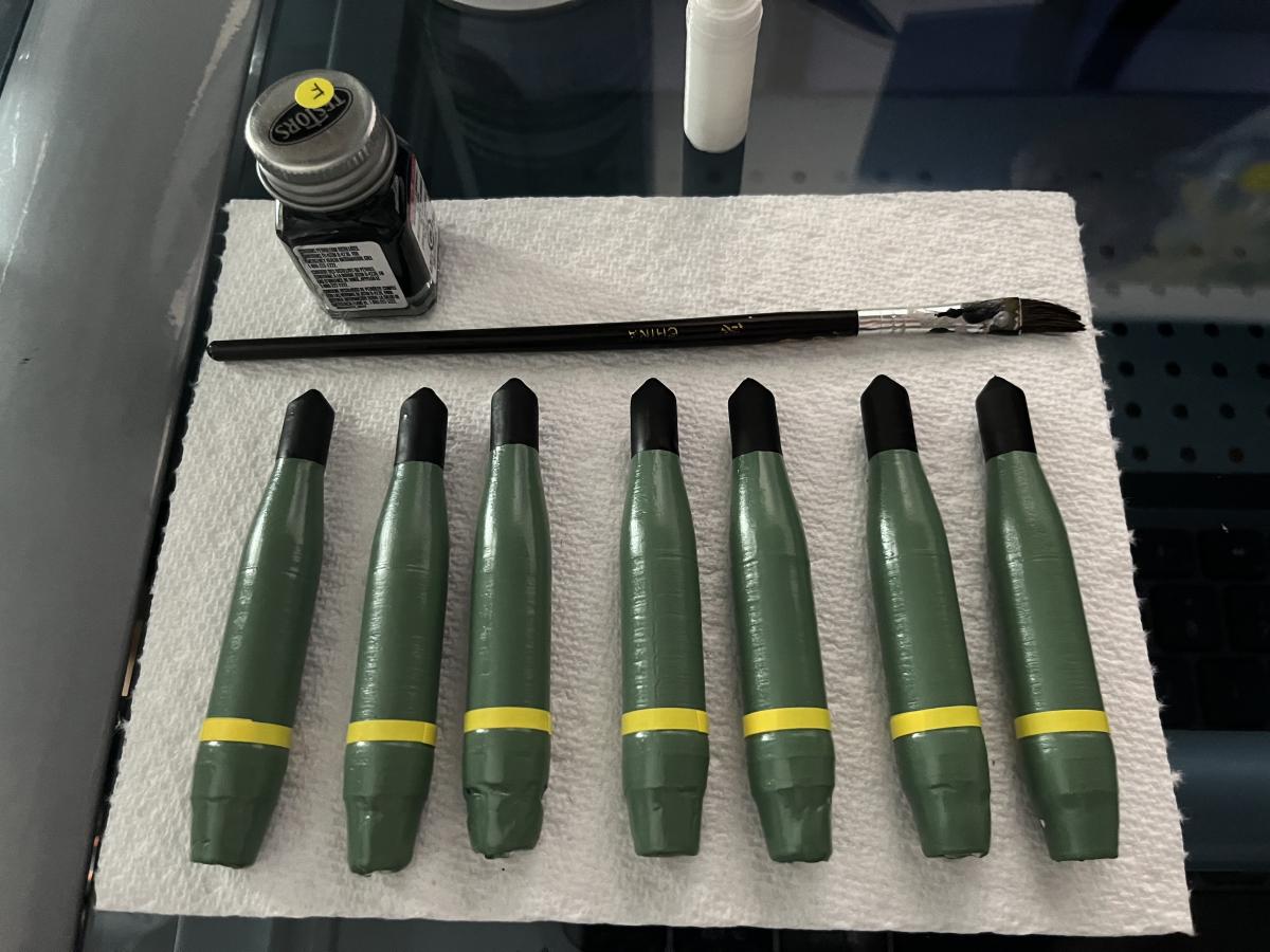

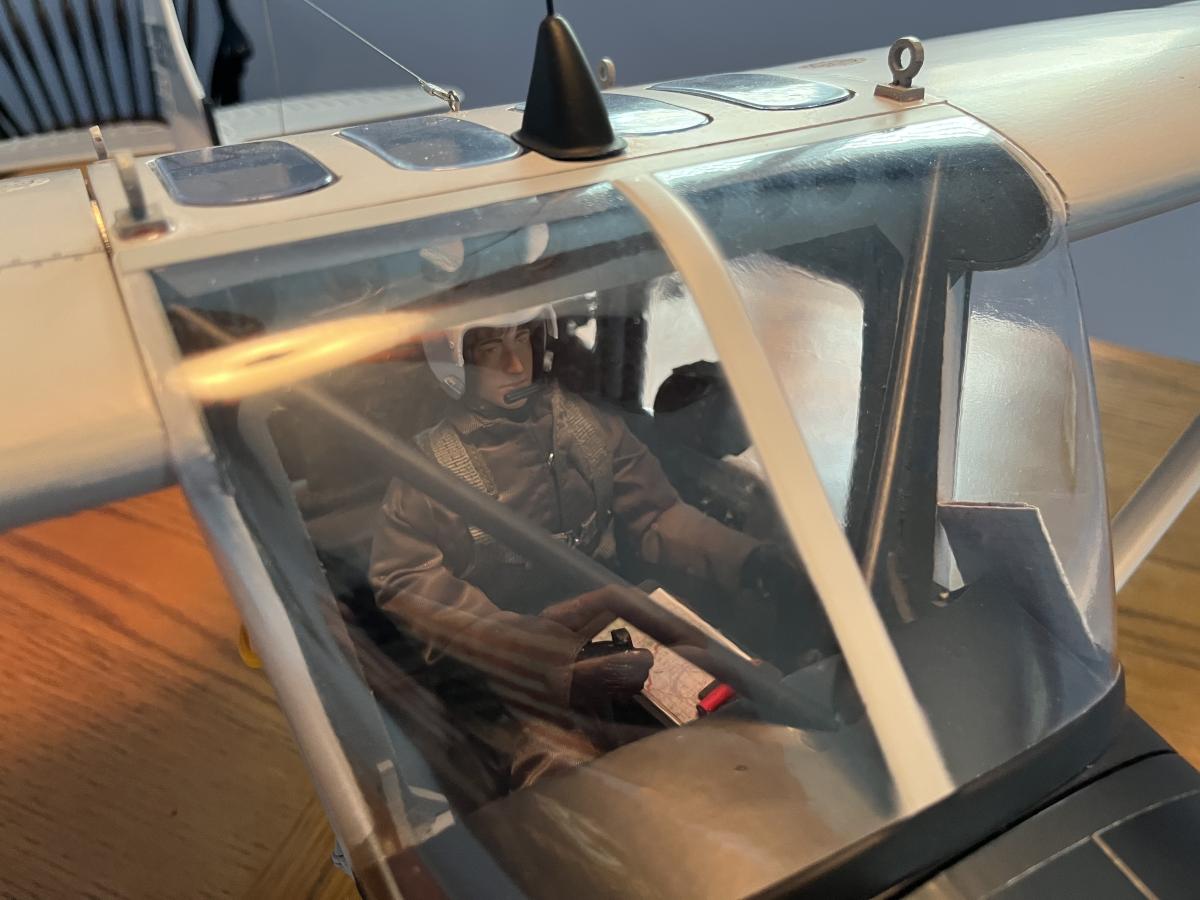

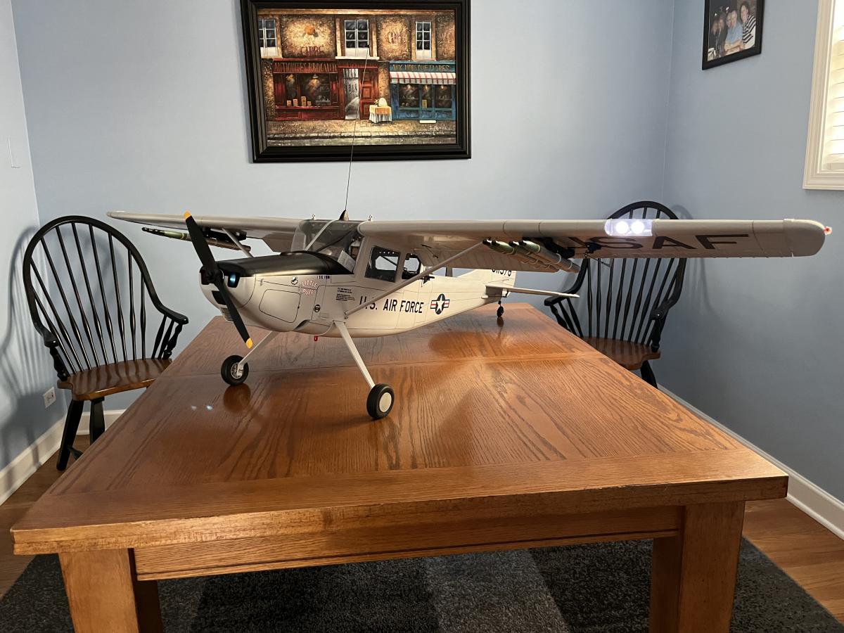

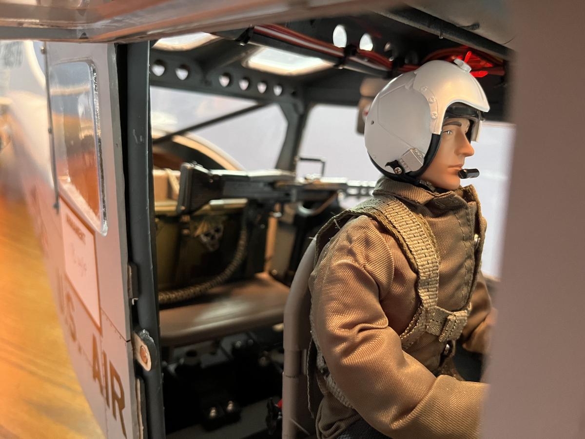

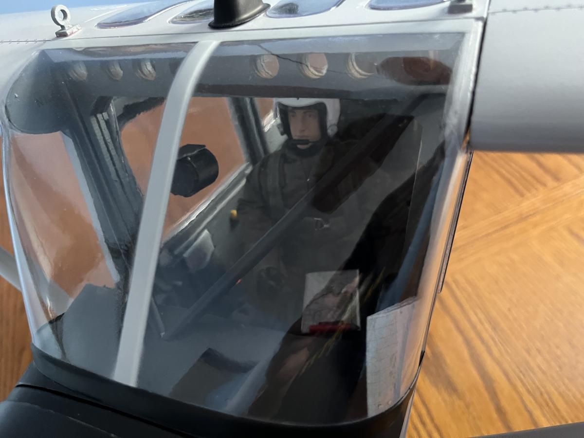

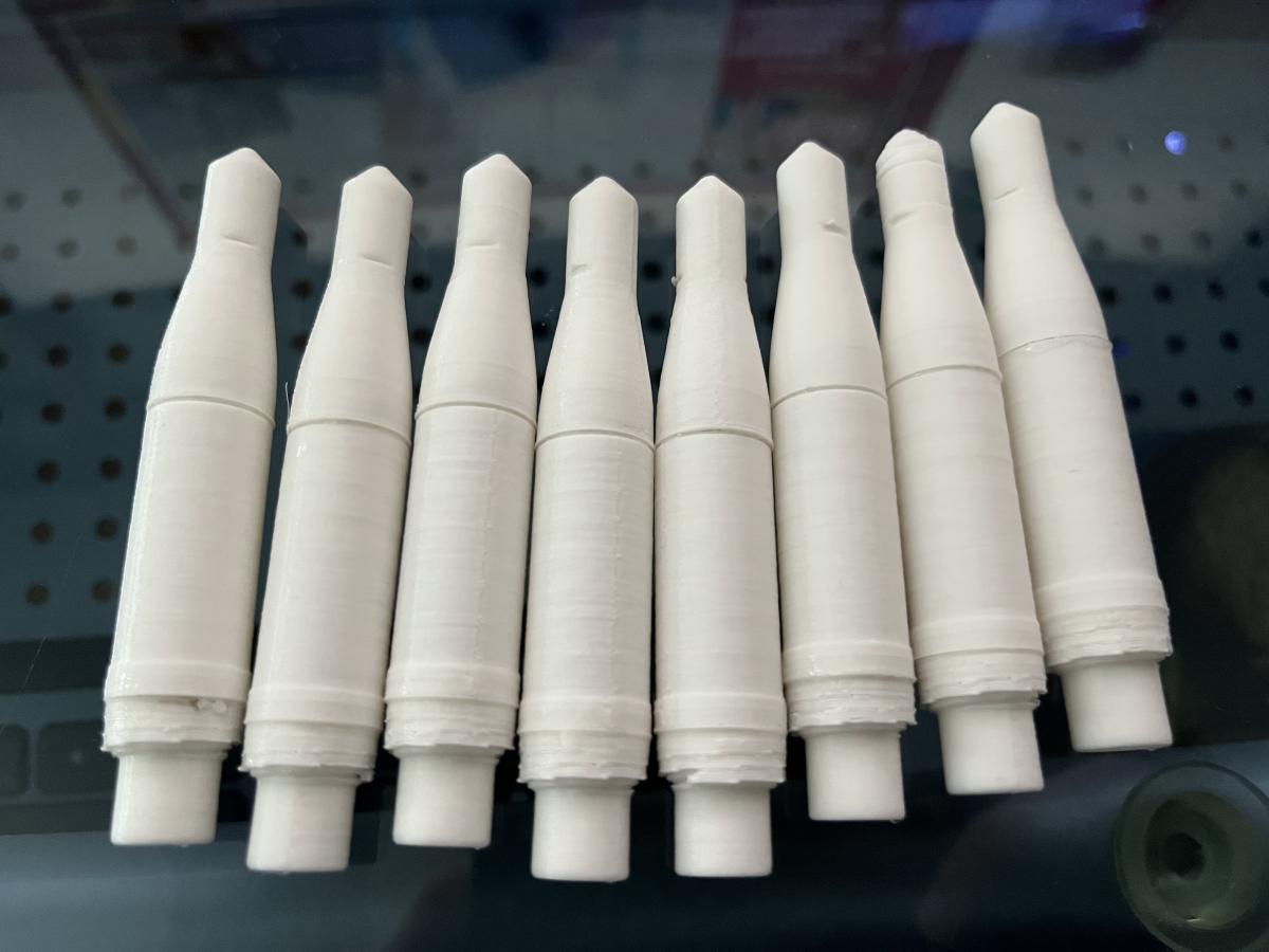

                O-1 Bird Dog “Little Puff”
                Finished the O-1 build. Built as an electric with the recommended Admiral setup from Motion.
                Livery is the “Little Puff” that had a M-60 mounted behind the pilot.
                3D printed rockets and lights added for some scale looks.​
