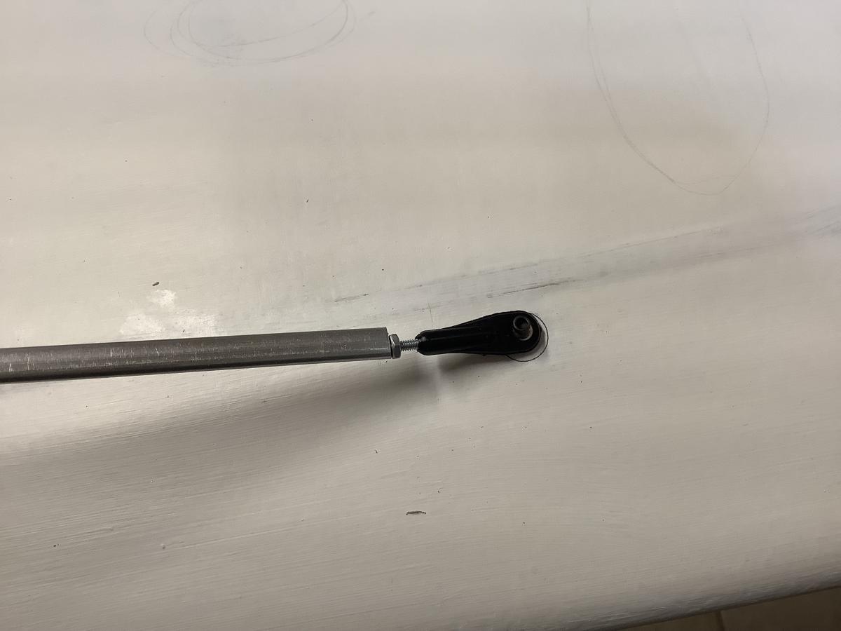

                      Nearing the finish on building and approaching the wing covering. Tail surfaces were easy and learned some new characteristics of my chosen material. Had good results with SIG Koverall over balsa applied with Minwax Polycryllic, and styrofoam is even better. The Byron kit came with older foam, not the tough stuff we’ve gotten used to now. What I discovered is that edges are a cinch with a trim sealing iron to overlap and it does shrink with it. Heat gun stretches it taught and bubbles just disappear. The wings have been slow process as no CA get near this foam, epoxy is OK but Titebond and soft clamps are definitely easier but slow to dry. Since it all gets wrapped with Koverall it was an easy choice to stick with aliphatic glue on the balsa and foam, but fiberglass and shell got the 2 part epoxy. Quite a thrill assembling this ‘old school’ technology but taking some liberties with newer tech when able. The tail wheel came from Hangar 9 Oscar, as the Byron offset design was short on the axle portion.

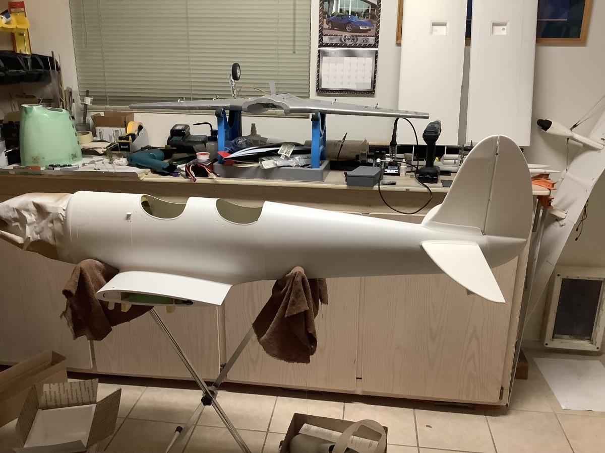

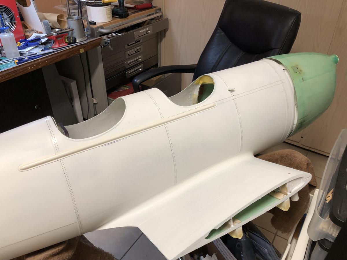

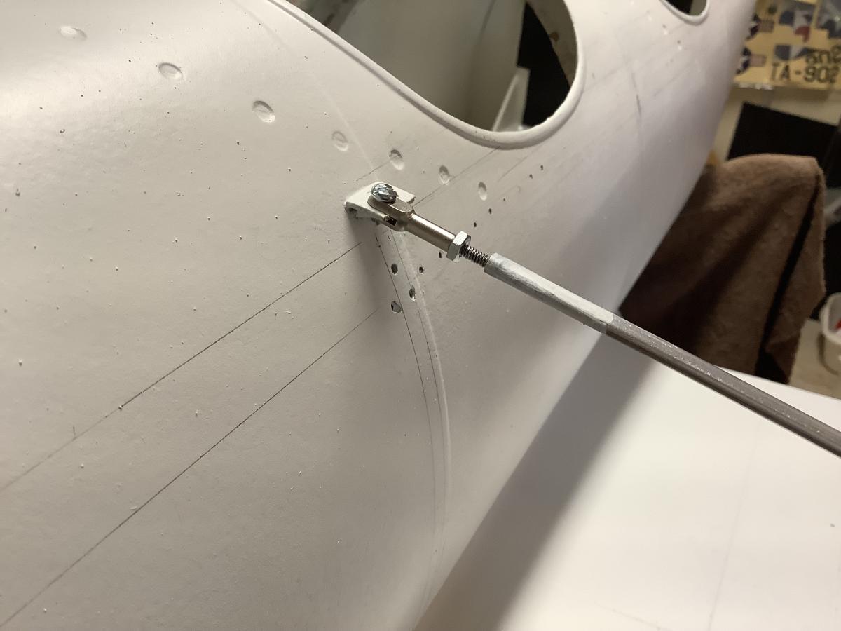

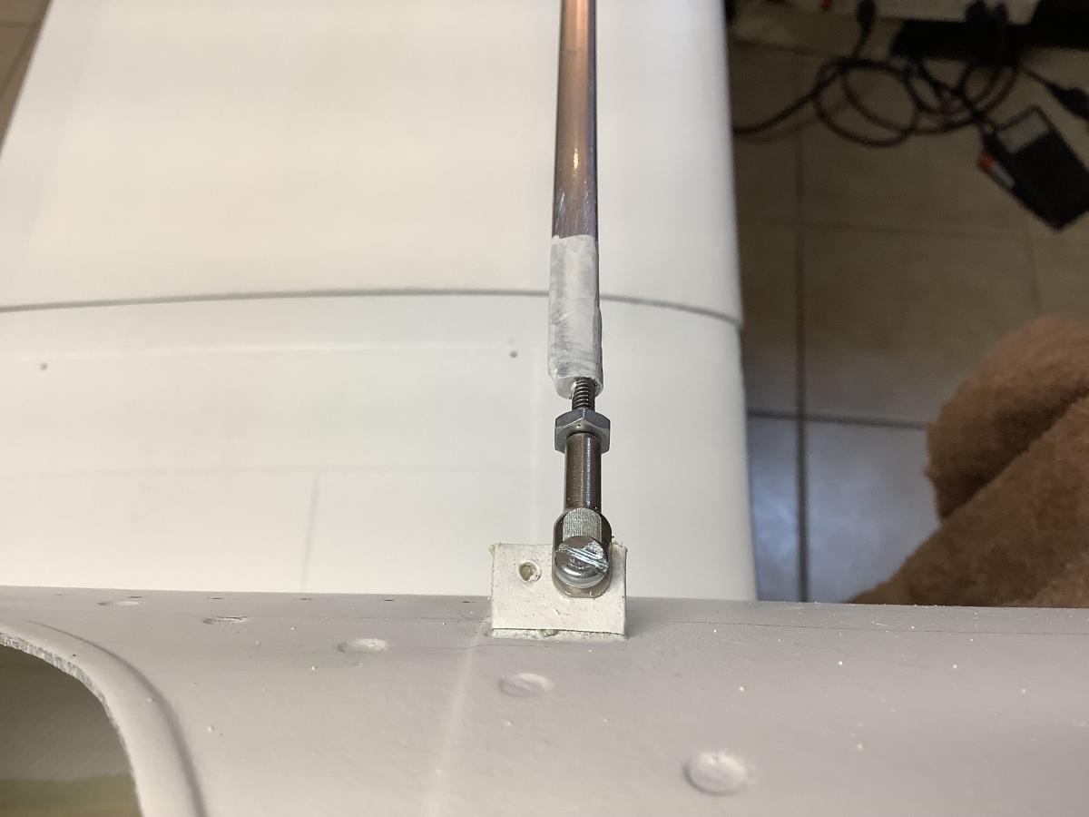

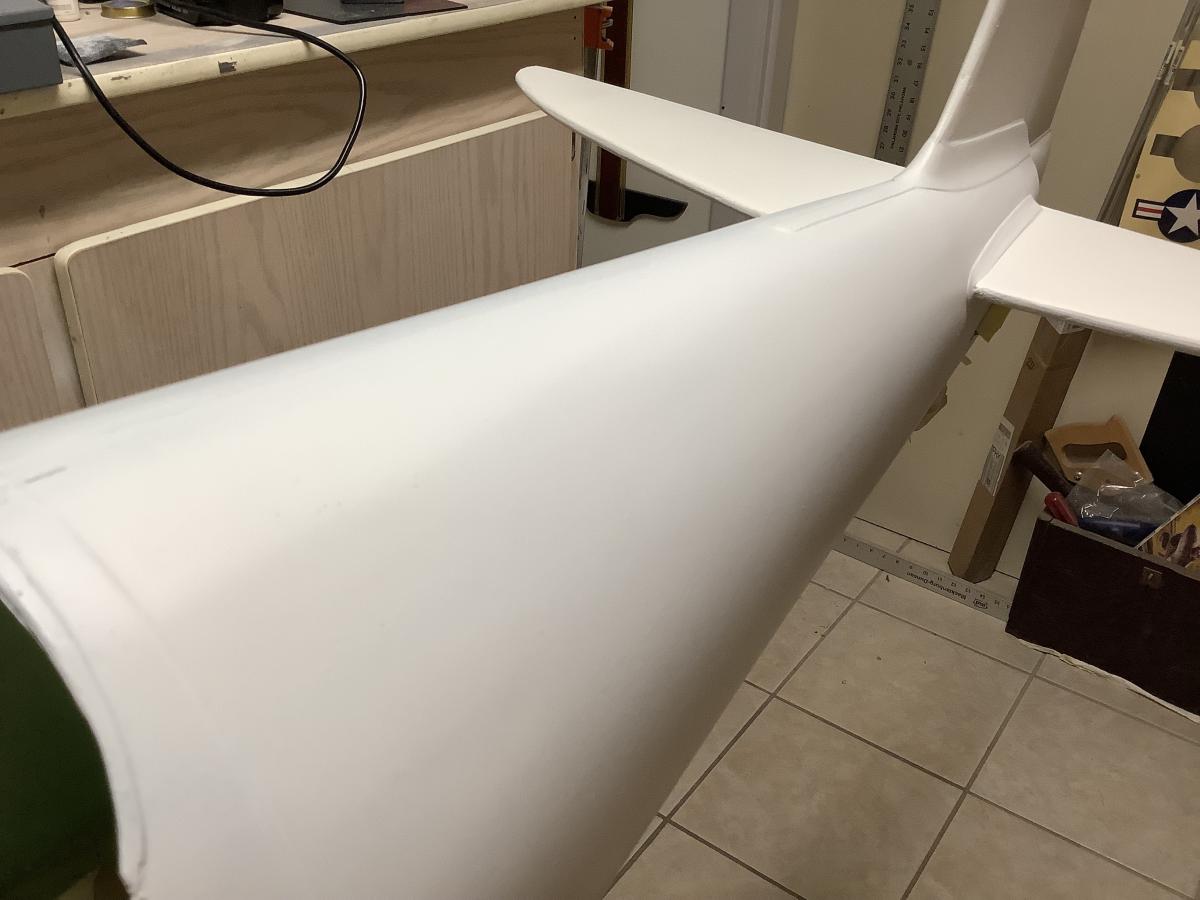

                                primer going down real nice, and flying wires will be taking paint also, so got a fair taper on the fitting transitions.
