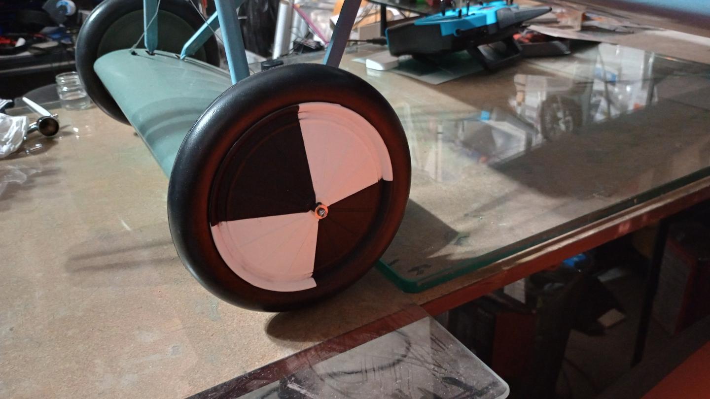

    The Spandaus are just a bit small and the main wheels and tires are about 1/6th scale. The guns are probably 1/5, or maybe a bit larger. I did the math, and I will 3D print better ones, as well as a more correct pilot. I have a German WW1 Pilot in my file collection, of Richtofen with the Blue Max.

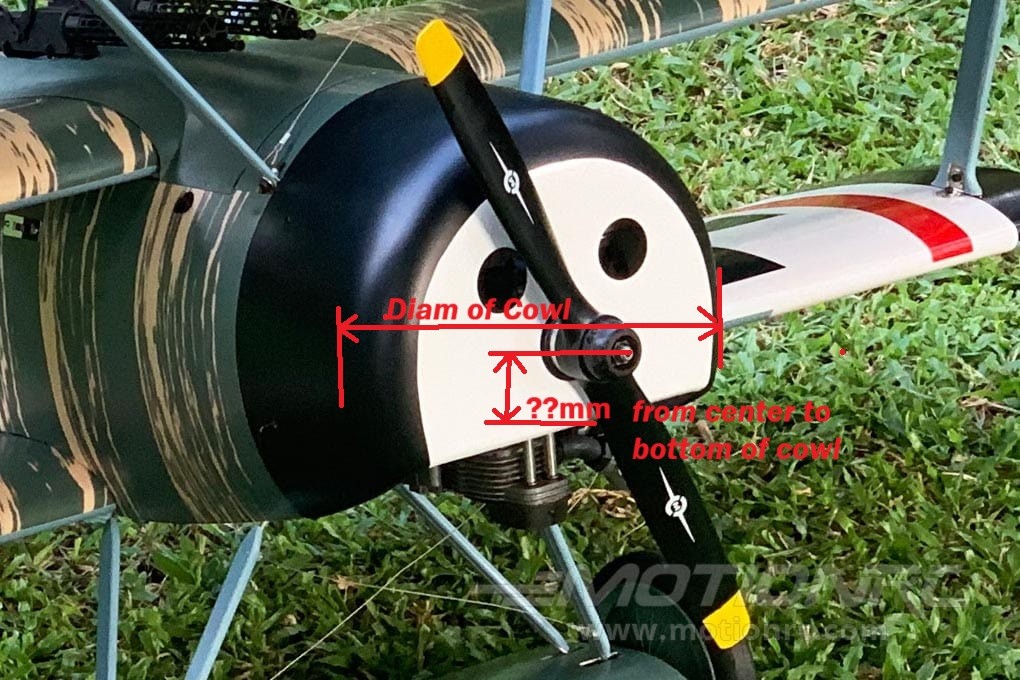

          Where can I get some info on some under the skin detail, ie motor mount ,total height of plane from the top of the wing,top wing mount attachment, etc,etc.

            Would also like to know that as well as these on picture below

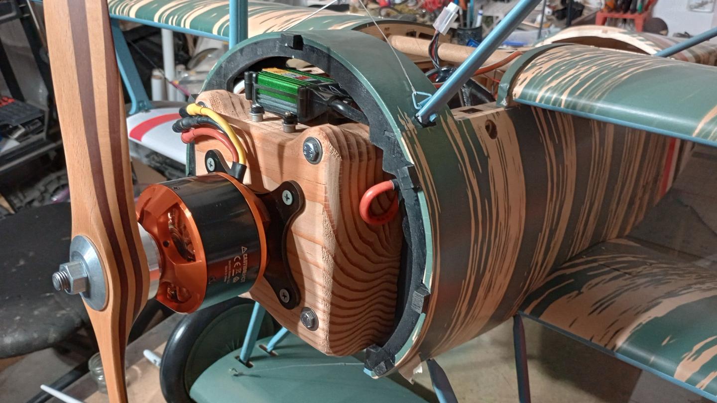

                I taxied it tonight. In grass, on an 8 cell. Plenty off power on the 8 cell, but will get another ESC to run the 10 cell set up. I will help out with questions, but I can say you MUST disassemble to move it in a SUV. Its 1/4 scale. I tried.

                  It will absolutely need ballast forward of the CG. I am looking into casting accurate cylinders from lead, then mounting on the motor mount I fabricated... The noise that propeller makes is magical!

                    I will work these dimensions tomorrow night, I am done in the shop for the night.

                          Couple of shots... plan on trimming up this solid block once I have everything finalized. I can easily drill it to add ballast, but I may cast lead engine cylinders from a sand mold. Make that using 3D printed parts. I am also considering placing the motor closer to the firewall, to make it more scale, as this cowl is very thick, longer forward thank it should be. Not sure yet.
