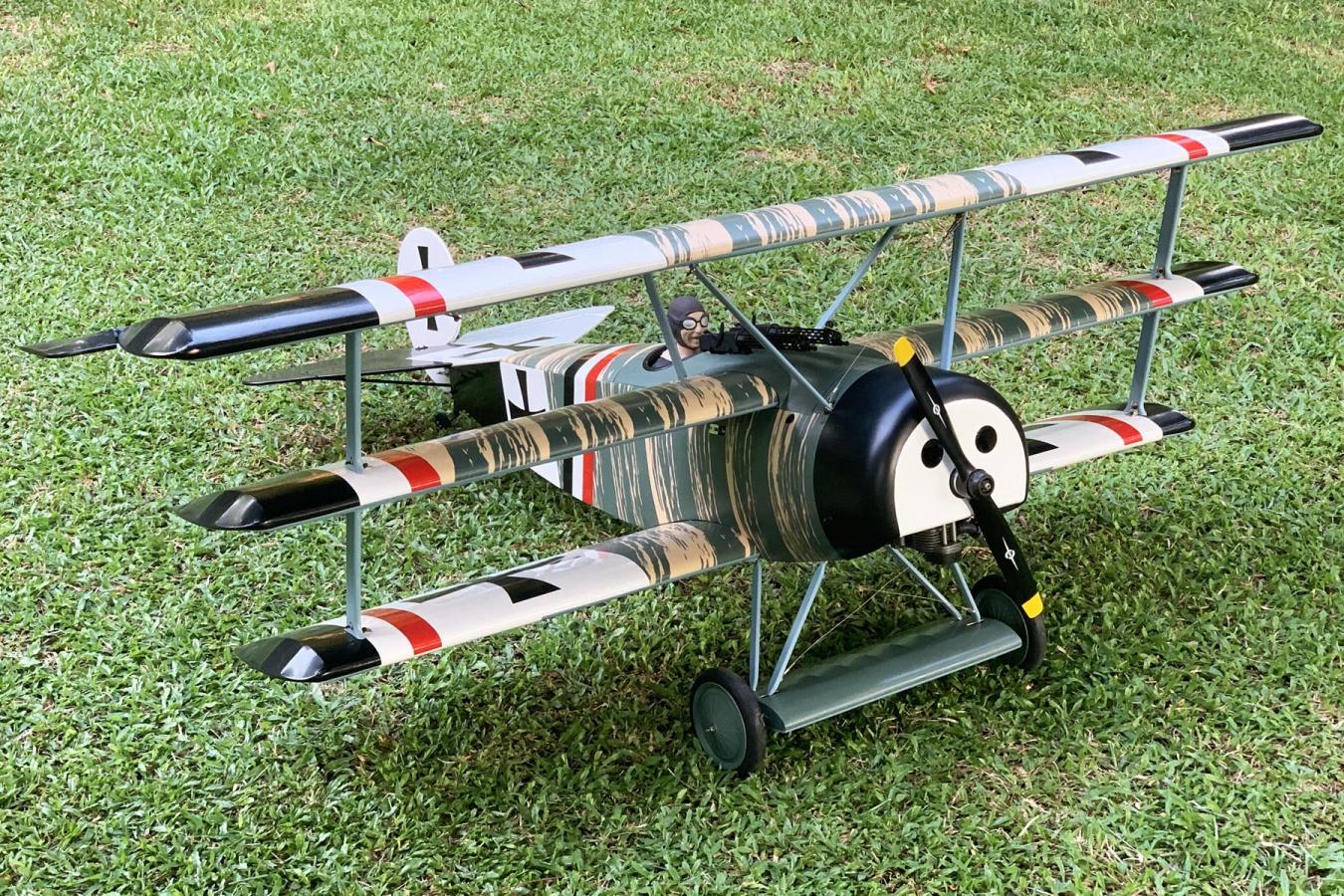

    Camo Version:
    Fokker Dr1 Camo 1850mm (72.8") Wingspan - ARF from Nexa - NXA1073-002
    The Fokker DR.1, famously flown by the Red Baron, is one of the most iconic aircraft of World War I. Known as the "Dreidecker" for its distinctive tri-wing design, this historic fighter dominated the skies with its agility, power, and innovative engineering. The Nexa Fokker DR.1 captures the essence of this legendary aircraft with exceptional scale detail and versatile power options.
    With a commanding wingspan of 1850mm (72.8”), the Nexa Fokker DR.1 ARF is expertly crafted from lightweight balsa and lite-ply, offering both durability and performance. Its stunning weathered finishes bring this historic aircraft to life, while scale details like the fiberglass cowling, WWI-style wheels, realistic machine gun, and painted pilot make it a showstopper at any flying field. Designed to accommodate 25–33cc gas engines, 140-size nitro engines, or equivalent electric power setups—this model delivers versatility and unmatched scale realism for an unforgettable flying experience.
    Whether you’re a devoted warbird enthusiast or seeking a standout addition to your collection, the Nexa Fokker DR.1 masterfully blends the timeless allure of WWI aviation with modern engineering and performance.
    Visit the Official Nexa Fokker Dr1 1850mm ARF Discussion Thread on HobbySquawk.com for additional photos, videos, reviews, and customer Q&A.

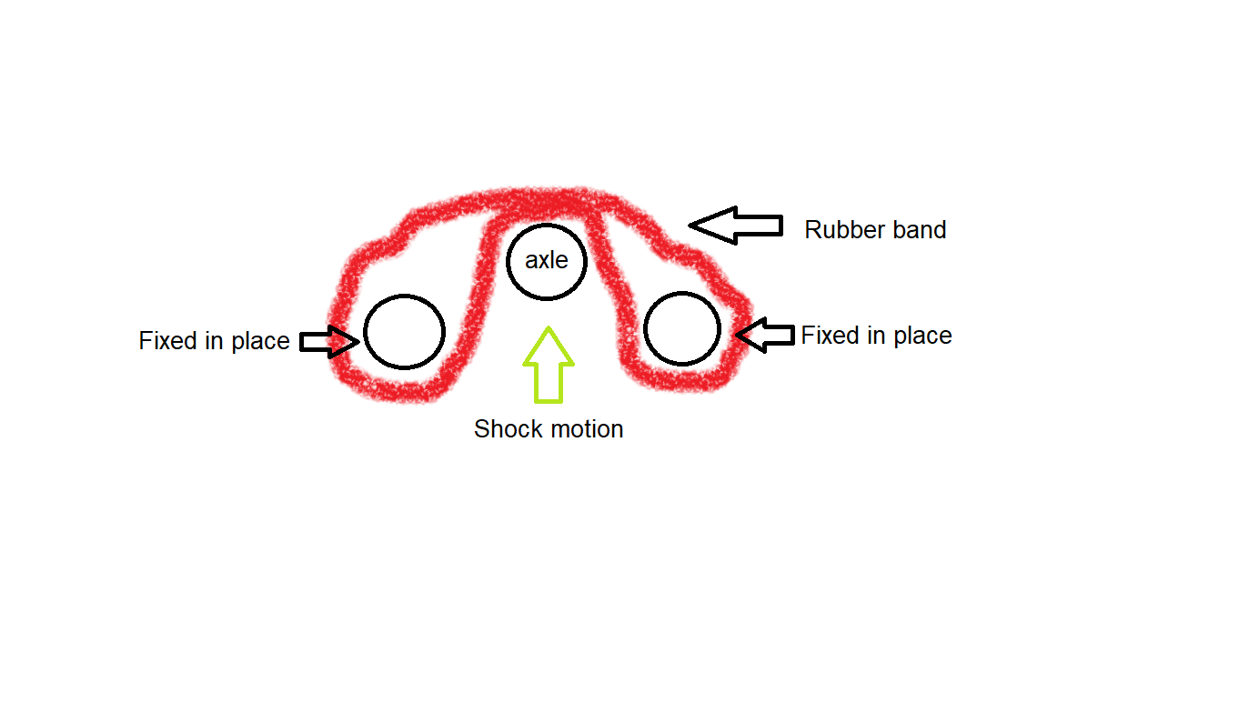

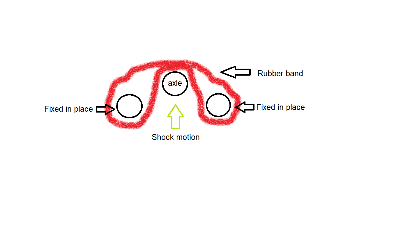

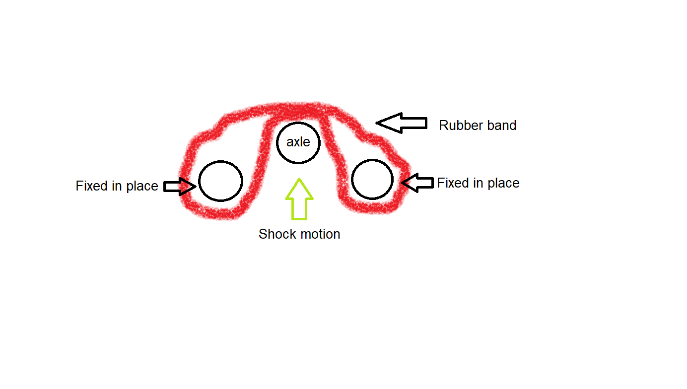

              Mine came yesterday, anyone else attempted to assemble the landing gear rubber bands and clearly understood the manual?

                Saved for the install manual image for the gear.
                  • 5426
                  Maybe turning the instructions upside down? The gear on this are just like my old VK Triplane. You have two fixed pins and a movable axle, up and down. Loop the rubberband like the picture. You want the bands to be fairly tight maybe going up and over a couple times.
                  • Vintage Racer
                    Vintage Man, Vintage Car
                    • May 2019
                    • 187
                    • Sucramento, Ka
                    This I understand, however...it show spacers on shafts with no specified lengths extruding outward toward wheels, set screws that interfere with the lower stabilizer if installed as shown, from the bottom, which will not allow clearance, whether spacers are fixed or supposed to rotate. Its a mess. First less than perfect landing, well it's not going to be pretty. Also, the rubber bands seem to me to be to long from the start. They will obviously get worse immediately as this mode is quite large/heavy. There are two supports that appear to touch when install by the manual, where the axle passes through the lower stabilizer/wing. If these touch, the set screws interfere with the light ply. I have a couple of ideas, and I will add right off the bat some plywood internal for the screws to attach. They will other wise just tear out. Probably add longer screws as well.
                      • 5426
                      By spacers you mean wheel collars?
                      • Vintage Racer
                        • May 2019
                        • 187
                        • Sucramento, Ka
                        I have ideas for a fix to add some strength, the rubber bands I believe are supposed to rotate on theses collars. I had written more, but somehow this site dumped what I wrote. I plan to add some plywood blocks, and longer screws. This is a big model with gear for a plane half its size.
                          • 5426
                          In my VK I silver soldered washers to keep the struts and axles in place and so the rubber bands would stay where they should be.
                          • Vintage Racer
                            • May 2019
                            • 187
                            • Sucramento, Ka
                            My guess leaves it up to you to set the distance of protruding wire for the bushings to rotate on. I think I will double the rubber bands, this will make up for the extra length. I believe it counts on the set screws in the collars to retain them, but NONE of this is in the manual, or how to orient them so that they do not cut into the rubber bands. There are plenty of other things I am seeing with the manual, but I will save it for now, and I totally get the one review where the guy said "not for the inexperienced modeler" This is my first big WW1/Vintage model with multiple wings and fixed wire landing gear. 8KG weight, etc.

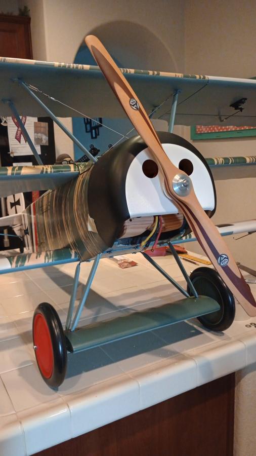

                                  #17

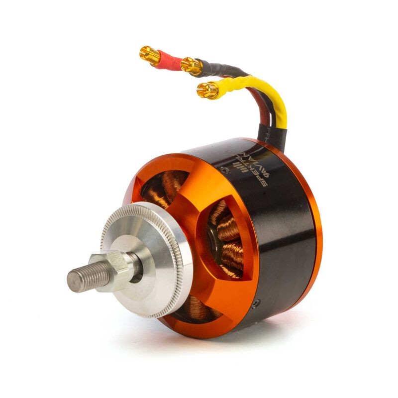

                                  Finished my motor mount. The kit supplied was a bit small for the scale 24 inch prop I wanted to use. I also added 7 inch wheels which are the correct size.
                                  Click image for larger version  Name:	IMG_20250915_183412482_HDR.jpg Views:	0 Size:	57.8 KB ID:	432404

                                    #18
                                    What Motor are u using to swing that prop :)
                                    • Vintage Racer
                                      • May 2019
                                      • 187
                                      • Sucramento, Ka
                                      #19
                                      Prop RPM limit is 8500. I will use a 10 cell for my power, which should keep me at that limit. I had planned on a 12 cell set up. The model just looks great with these XOAR props. The model is roughly 1/3.8 scale. 25" would be most accurate, but the next size up is 26 inch.
                                      https://www.e-fliterc.com/product/av...PMXAM4800.html Click image for larger version  Name:	MOTOR.jpg Views:	0 Size:	56.1 KB ID:	432539

                                        The camo version was an actual airplane. 43 victories, Paul Baumer. I was not aware of this and have kind of done my own thing with model.
                                        Before I was aware, I didn't care for the cross on the horizontal stab, so I flipped it over and switched the elevator and will add red stripes on the right side of the upper stab. I also got the colors matched at HOME DEPOT and hand painted the camo on the battery hatch. Looked really dumb with out it continuing upward.
