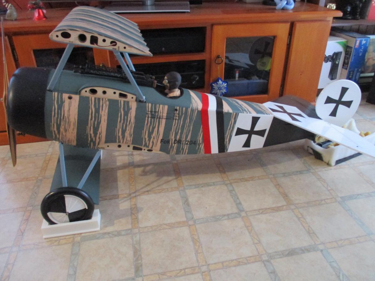

                  Do you have any pictures of the Triplane with the wings off ready to put in your vehicle ? Still waiting for mine ,building up a supply of things to get and buy for my Red Bird when she flutters in. Since I dont have the kit or the plans ,other than the motor and RC gear at a loss on what to get. If you can, can you respond to me here, if you dont please also respond anyway.. BTW Happy Holidays to all.
                    That's ready to put in the car.
                    3D wheel chocks with Velcro on the bottom to stop sliding in the back of the car.

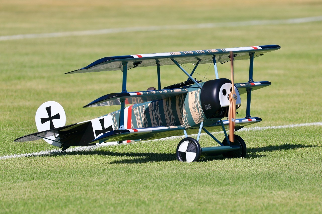

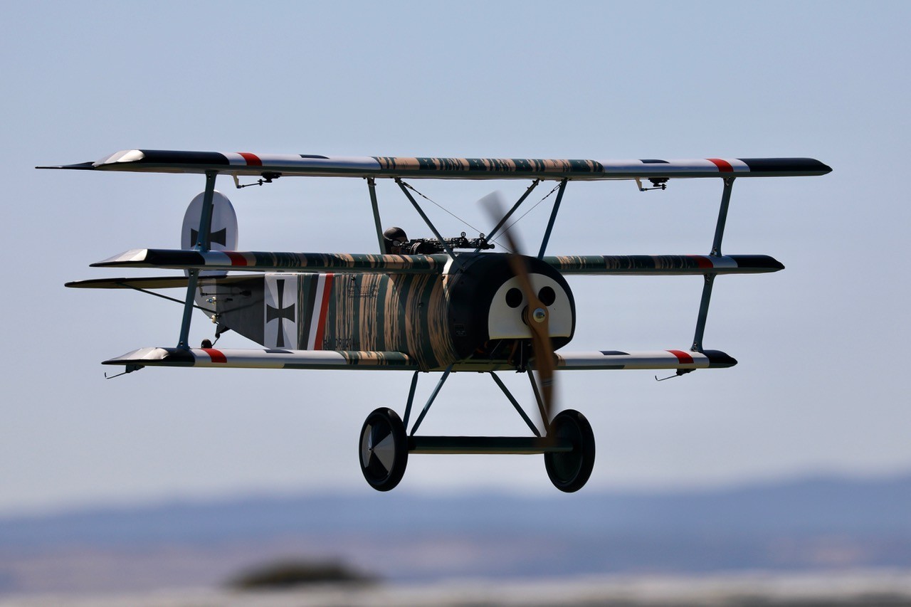

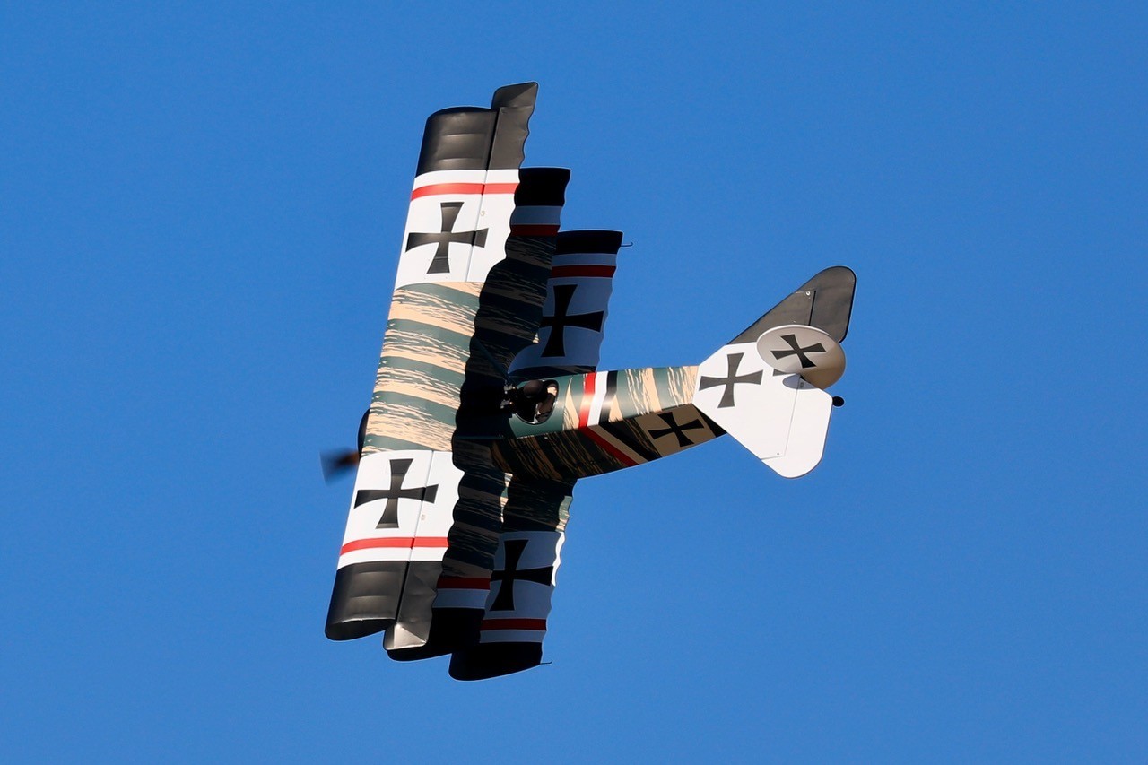

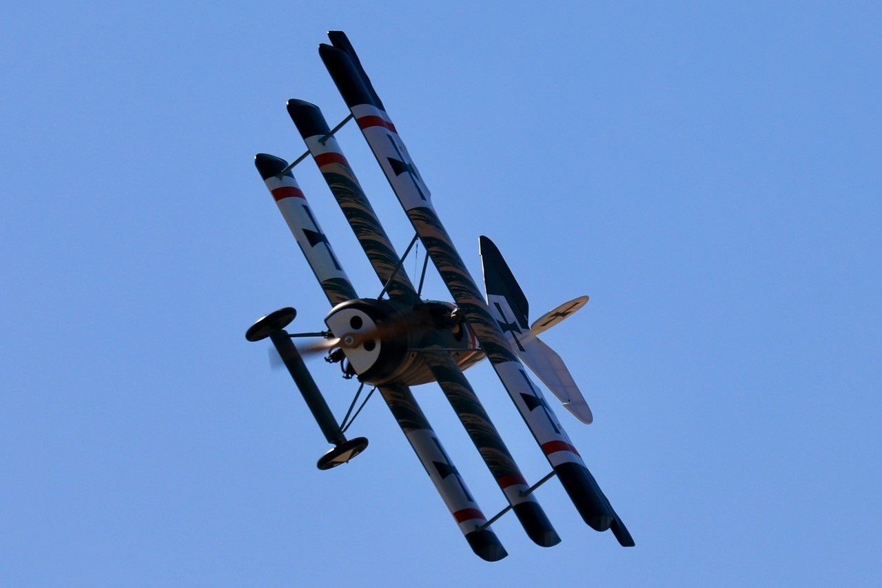

                                Finally got some inflight pictures of my Dr1
                                Enjoy
                                  • Nov 2013
                                  • 2793
                                  • Cody, WY
                                  #76
                                  Enjoy
                                  Nice pics! Thanks for posting.
