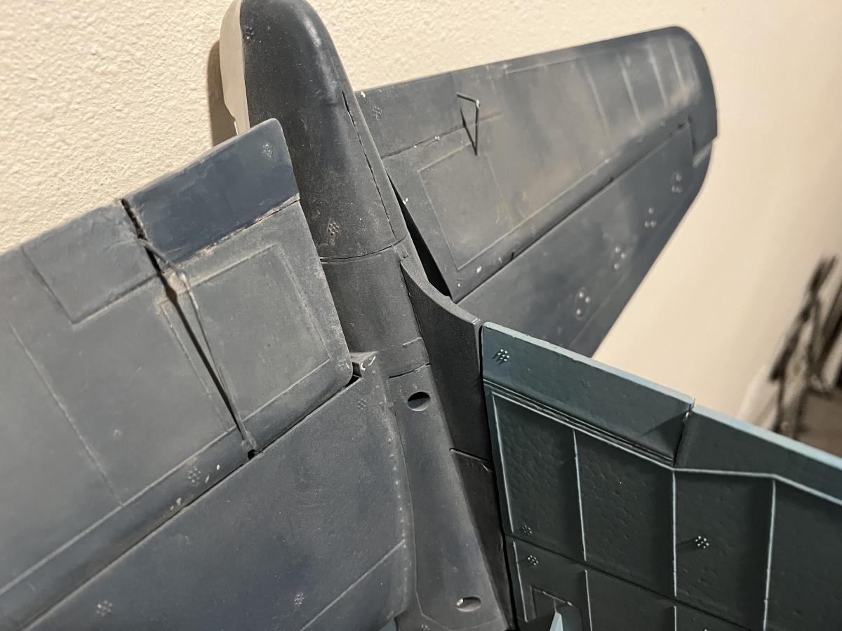

      Another detail I like to do, going back to big gassers at contests I used to participate in, is articulating the trim tabs slightly on the model. For instance, on the P-47 aircraft, they had two or tandem elevator trim tabs, one on each elevator that were moved together as the pilot turned a small wheel in the cockpit. For aileron trim, just one tab was standard on the left aileron, not the right. And I think this method was used on most fighters of that era. For rudder trim, a single rudder trim tab was installed on the rudder, and moved with a knob in the cockpit, same with the aileron trim, a knob in the cockpit.
      There was a fixed trim tab adjusted at the factory on the right wing, which had no actual moveable trim tab as the left wing had. There were a couple of small factory fixed trim tabs on the back of the elevators, not adjustable by the pilot.
      Anyway, all these tabs can be moved "slightly" to give the impression that they actually work. The effect on the airplane in flight is negligible, and I've done this on every plane of this type, for many years. The early Corsairs have a more complicated elevator trim system. They have two trim tabs, one on each elevator like the P-47 and other aircraft, but they also have a balance tab on each elevator, which is mechanically linked to the movement of the elevator up and down to lessen control pressures to the pilot. Another cool thing about the Corsair is that the horizontal stabilizer/elevator assemblies are completely interchangeable. In other words, if say a right elevator got damaged and had to be replaced, if they had a replacement on base, it would fit and operate properly. There was no "left" or "right" horizontal stab/elevator. That certainly helped in far away island bases in the Pacific where getting supplies like replacement airplane parts were tough to get sometimes, if you had "One" in stock, you were in business!

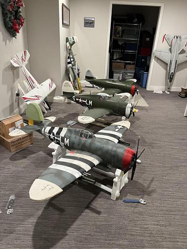

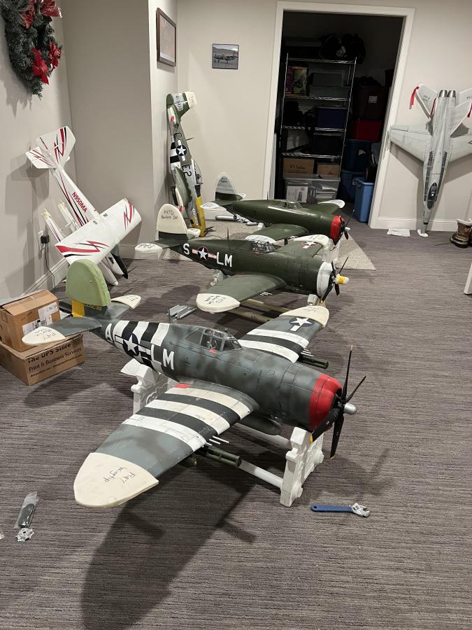

              My basement is starting to resemble the Republic factory!! Hoping to get the maiden on Thunderbolt number 3 (furthest one away in picture) once I get a break in the weather and winds.
              Cheers
              davegee

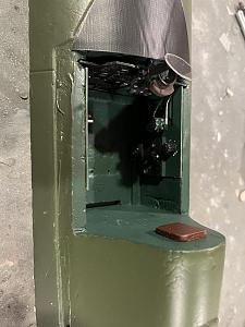

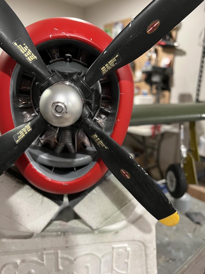

                              I started in on a medium redo of the cockpit. That goofy looking pilot that comes with the kit I'm keeping for the time being. I have performed some "surgery" on him to move the arms some, and "erased" the oxygen tube to make a scratchbuilt one more realistic when viewing it. I have ordered a 1/8 scale WWII pilot from Warbird PIlots and will see if he is usable for this plane, or not. You can remove parts of him as it is just a cloth body to fit planes, as necessary. These small pilots have real clothing, but it is tough to make something that small that doesn't look like he is wearing his big brother's clothing. I'll check it out when I get him and determine if he'll work for this project, or another one down the road. If not, I can modify the kit pilot so that it will work. Not great, but ok.
                              I don't plan on making a sliding canopy on this plane so I am limiting the amount of rework of the standard cockpit I need to do as it will just be seen through the canopy windows. But I'll attach some pics of what I am working on right now. For one, the color is all wrong. Republic used a "dull dark green" color for the cockpit. I cleared everything out and repainted and detailed the side panels, and the forward control panel. I removed the later model gunsight that comes with the kit (these didn't appear until months later with some of the bubbletop planes) and replaced it with a part printed/part scratchbuilt earlier gunsight used on the razorback P-47s and other fighters of the time. I had to cut out a JI-NORMOUS head rest molded into the back wall of the cockpit. It was like having a MY PILLOW back there, so I cut it out, filled and sanded and painted, and made a more scale looking head rest out of wood.
                              I have time to work on this cockpit some more, as I am in the queue to get my markings made by Callie, that will be a few weeks, and I had to buy some more rattlecan Tamiya paints, namely, the OD green. We don't have a hobby store in the little town that I live in so I have to order it online. I still need to tape off and spray the canopy frames once I get the paint. Other things to do are the bulletproof glass shielding in front of the pilot and other details, none of which I haven't done before, many times! Many other exterior details to the plane itself, too.

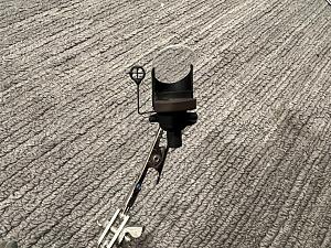

                                Your modifications are looking great. Gunsight is fantastic. Enjoy seeing this detail work. Rex

                                    Yeah, the old "iron sight" was handy to have if the regular gunsight crapped out, which was always possible! I like to add little details like that, thanks for noticing it.
                                    Cheers
